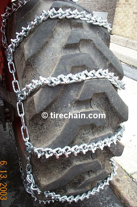

I am thinking about these. Comments ?
/ Chains for my 3320 #8
Those look like 4-link chains. They will certainly work but I prefer the 2-link chains. 2-link will also make your ride less bumpy. Those V-bar are great for ice traction but you do not want to drive on any concrete or pavement as it will leave marks. Needless to say, any wheel spin will rip things to shreds. Heck, I had V-bar on my NAA and they put marks in my gravel driveway! ;-)

So here is the deal. From a dollar standpoint I cannot go for the 2 link V-bar so it has to be either 2 link regular or 4 link V-Bar. Comments?
/ Chains for my 3320 #10
The first question you need to answer is... will you need to drive on concrete or pavement at all?
#11
never.......
/ Chains for my 3320 #12
I'd say go for it if you have no pavement to tear up. Make sure to get the chain tensioners.

never.......
Then if you want the ultimate in ice traction go for the 4-link V-bars.
I faced a similar decision a few weeks ago when I bought the chains for my new 2720. I had V-bars on my NAA and only ran on gravel but now with the 2720 and the blower I may need to run on some pavement so I chose to go with 2-link ladder chains.
I agree with the other poster about getting the tensioners.

I have the larger tires on my 3320. I opted for the 2 link chains from TireChains.com as I do drive on pavement sometimes. If you're not going to drive on pavement the 4 links might be ok, one thing, they are lighter and will probably go on and off quicker. I use the stabilizers from my 485 hoe to put them on and take them off, by the way.
