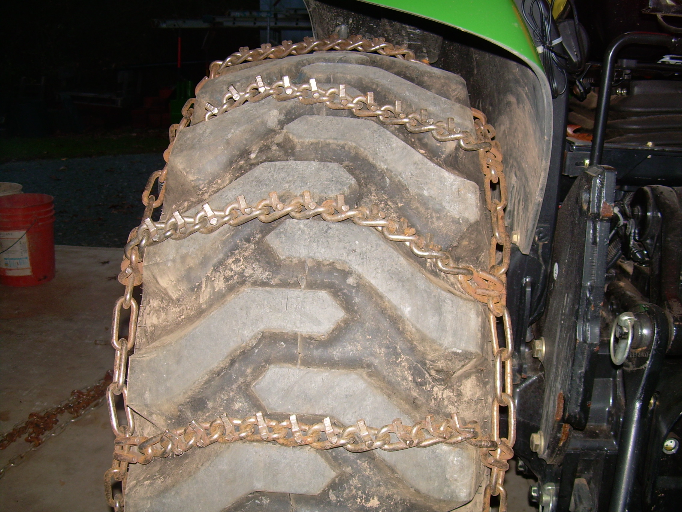

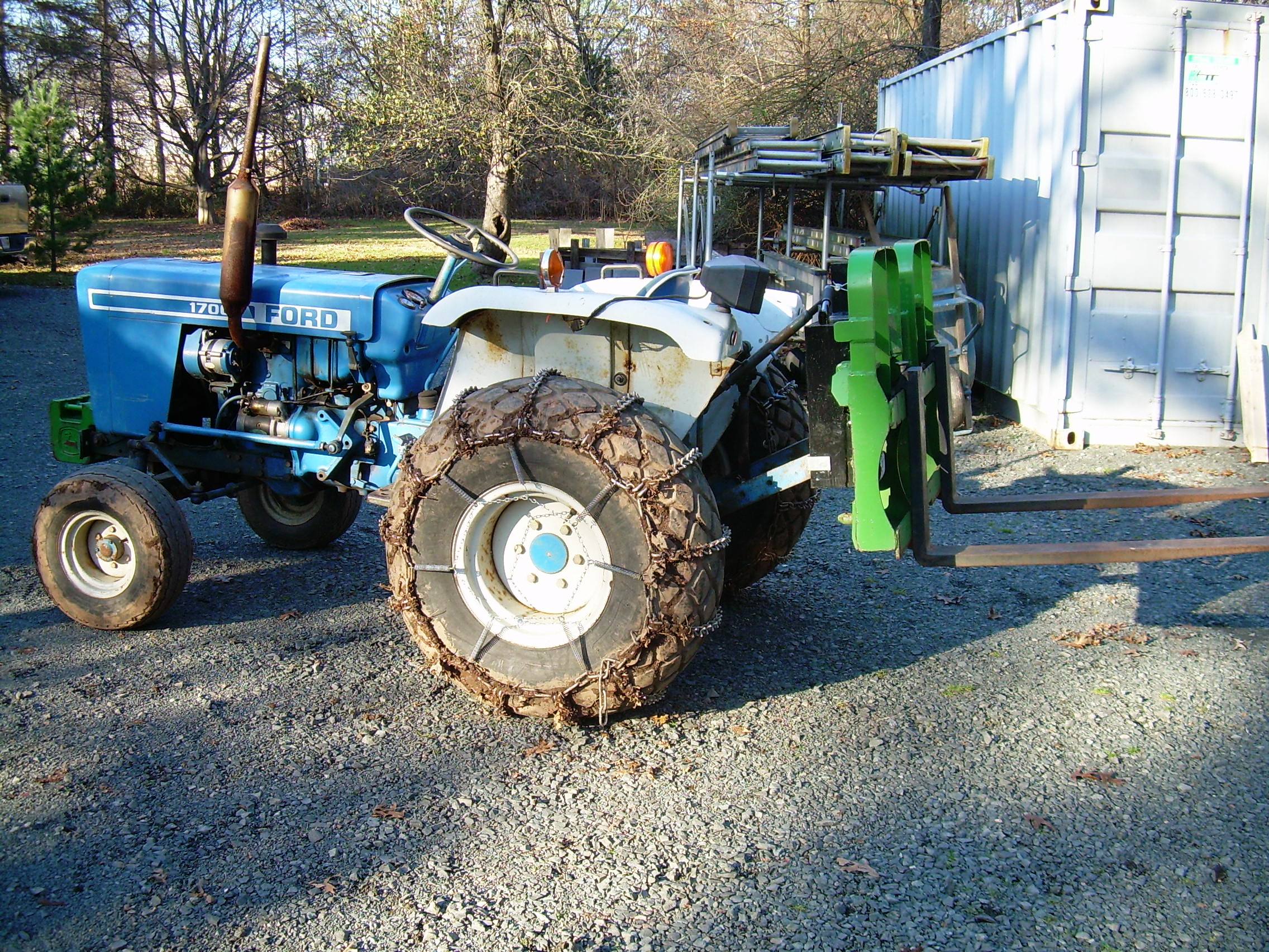

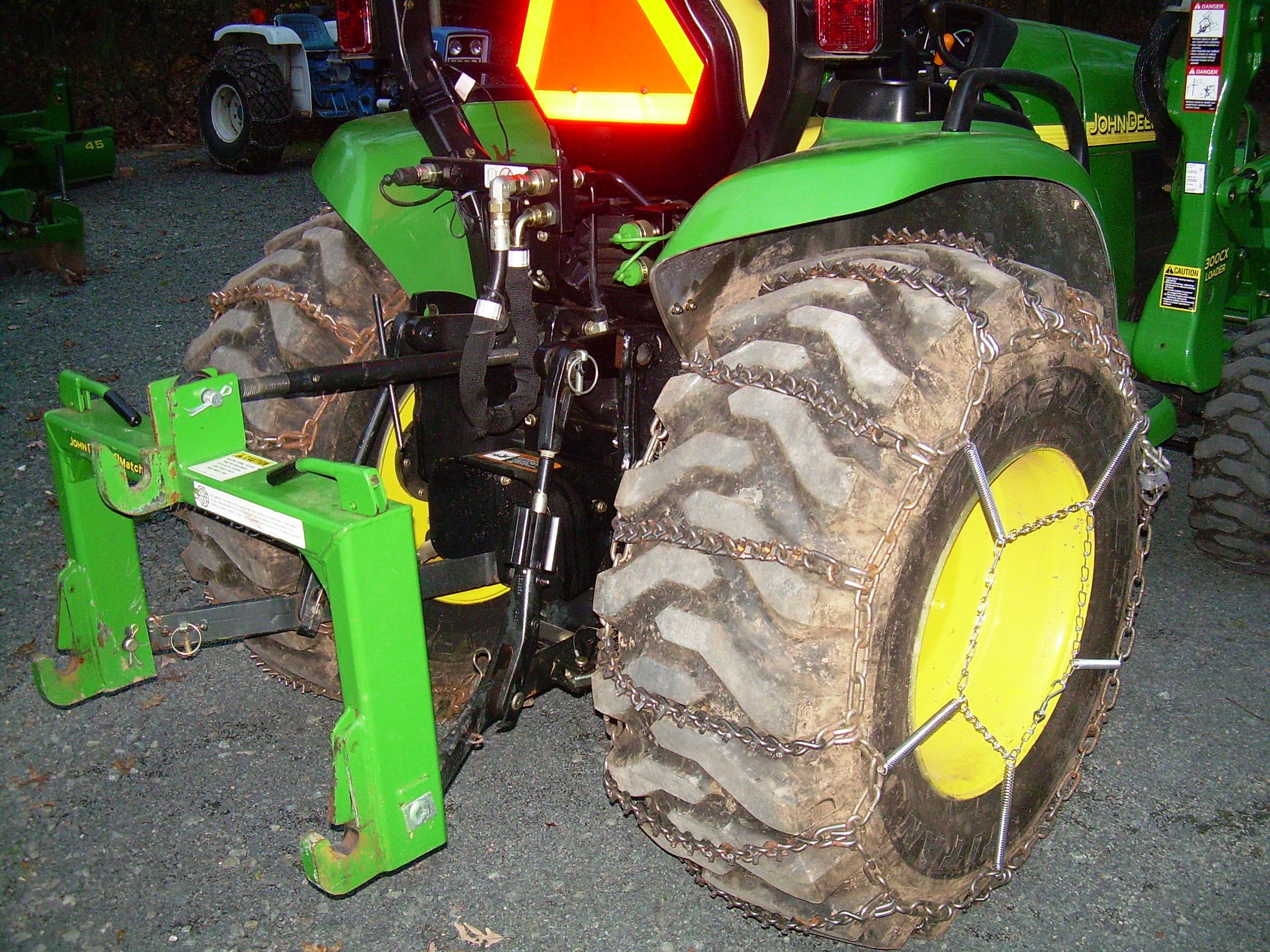

Welcome to TBN.
As long as it's not a bottomless mud bog then chains will do the trick.
There's a bunch of different types of chains, but even reg old 4 link spaced chain will make a world of difference in the woods, even with just a 2 wheel drive machine.
The other end of the spectrum is logger type chains, which are pretty big bucks.
If your on slopes you probably need something in the middle, there are many that have a cross pattern that don't fall into the lugs.
I have the reg 4 link spaced V-bars, mostly for snow but they work great in the woods as well.
Good luck.
