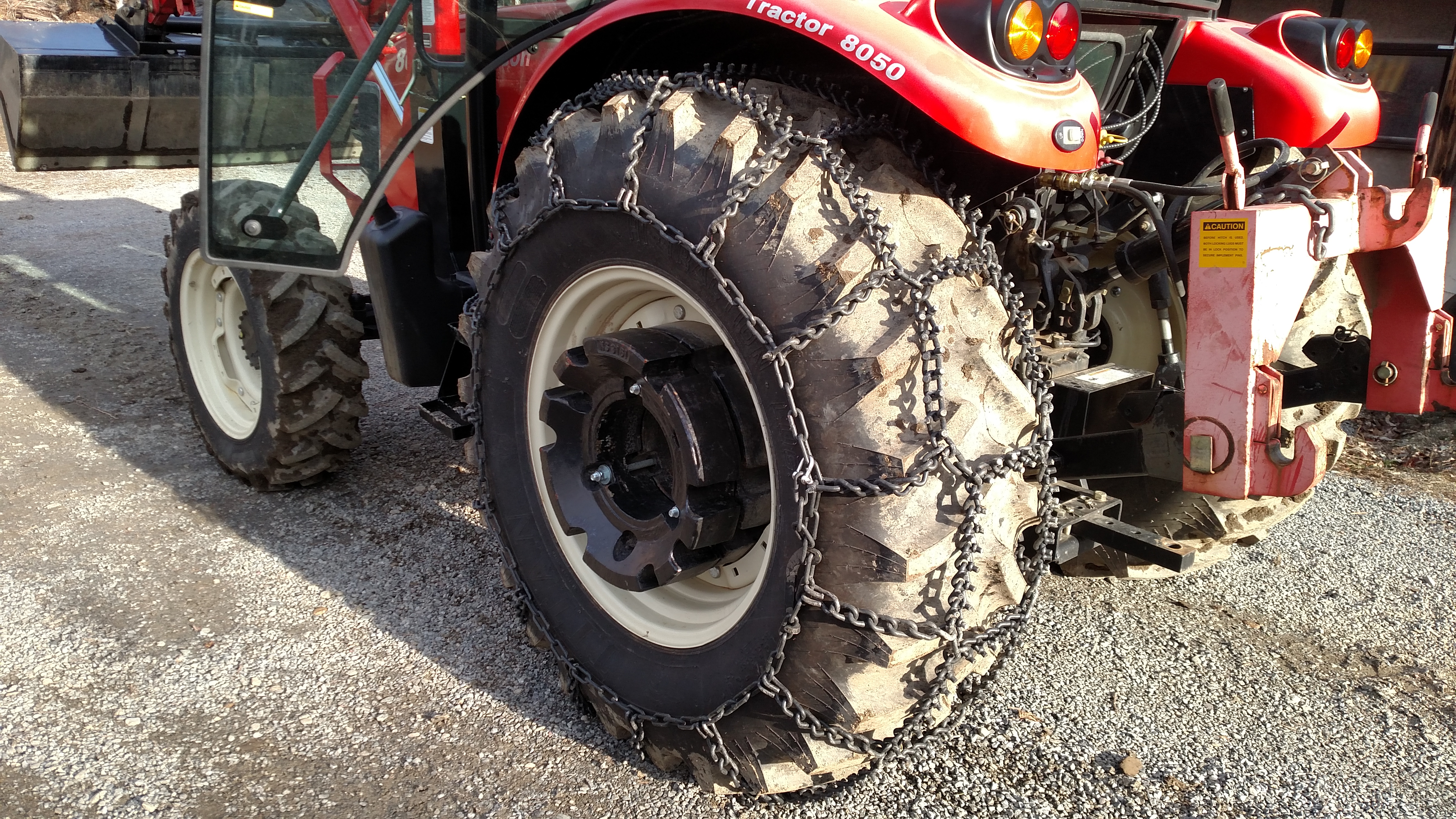

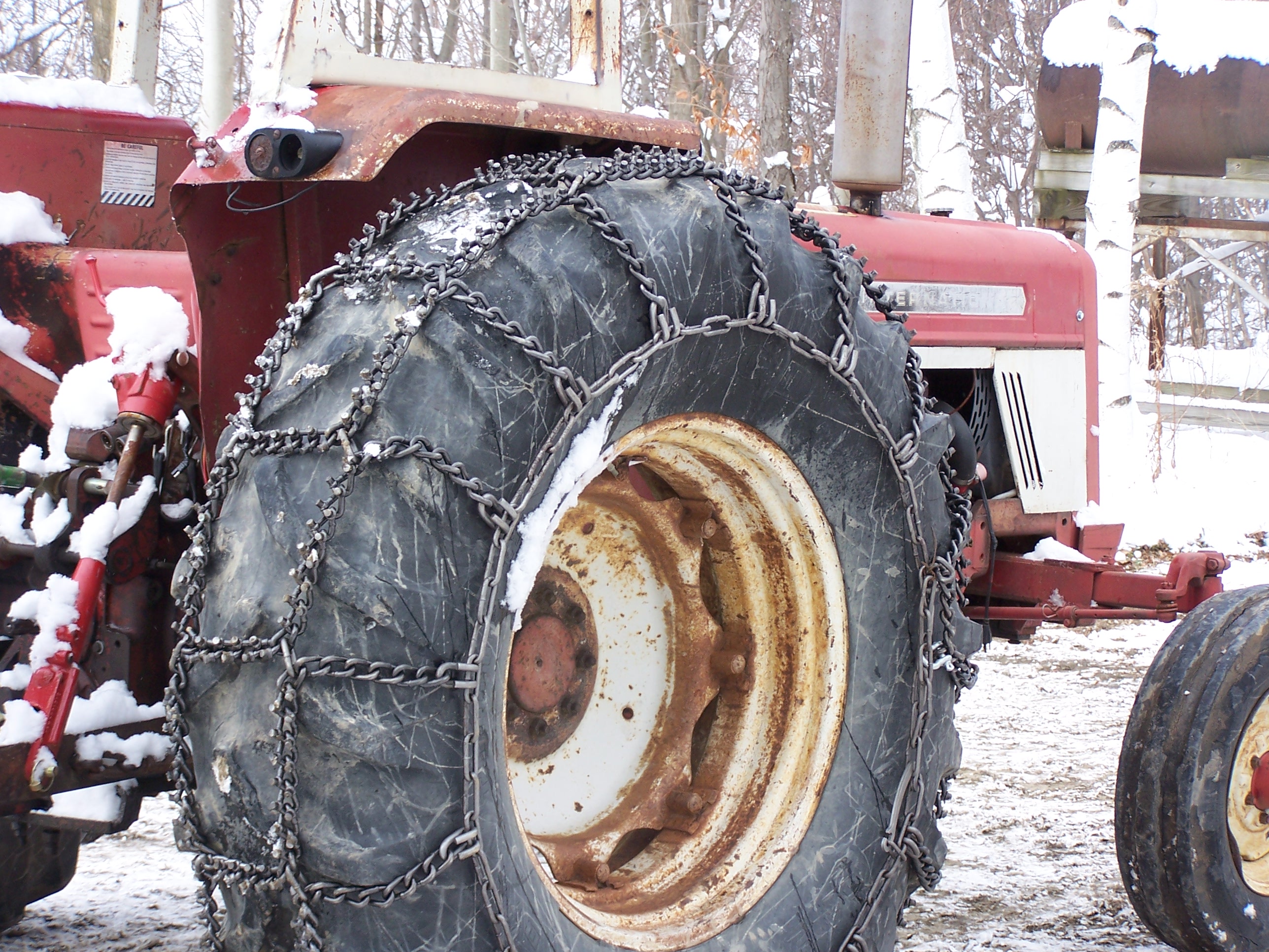

Installed my chains few days ago.
I jack up the CUT, manually rotate the wheel so as to wrap the chains around the tire, adjust the loose cross links and close the connectors.
My chains are studded crosses every 3 link and being close provide a rather smooth ride with minimal slippage even on glare ice.
I use binders inside as well as outside as I have very minimal fender clearance (can't even pass my hand).
I hate the clank/clank of a loose cross link plus the damage they cause to fenders.
Speaking of fenders; I sprayed leftover gravel guard on the underside some years back and am pleased to say it has proven to be successful in deterring rust.

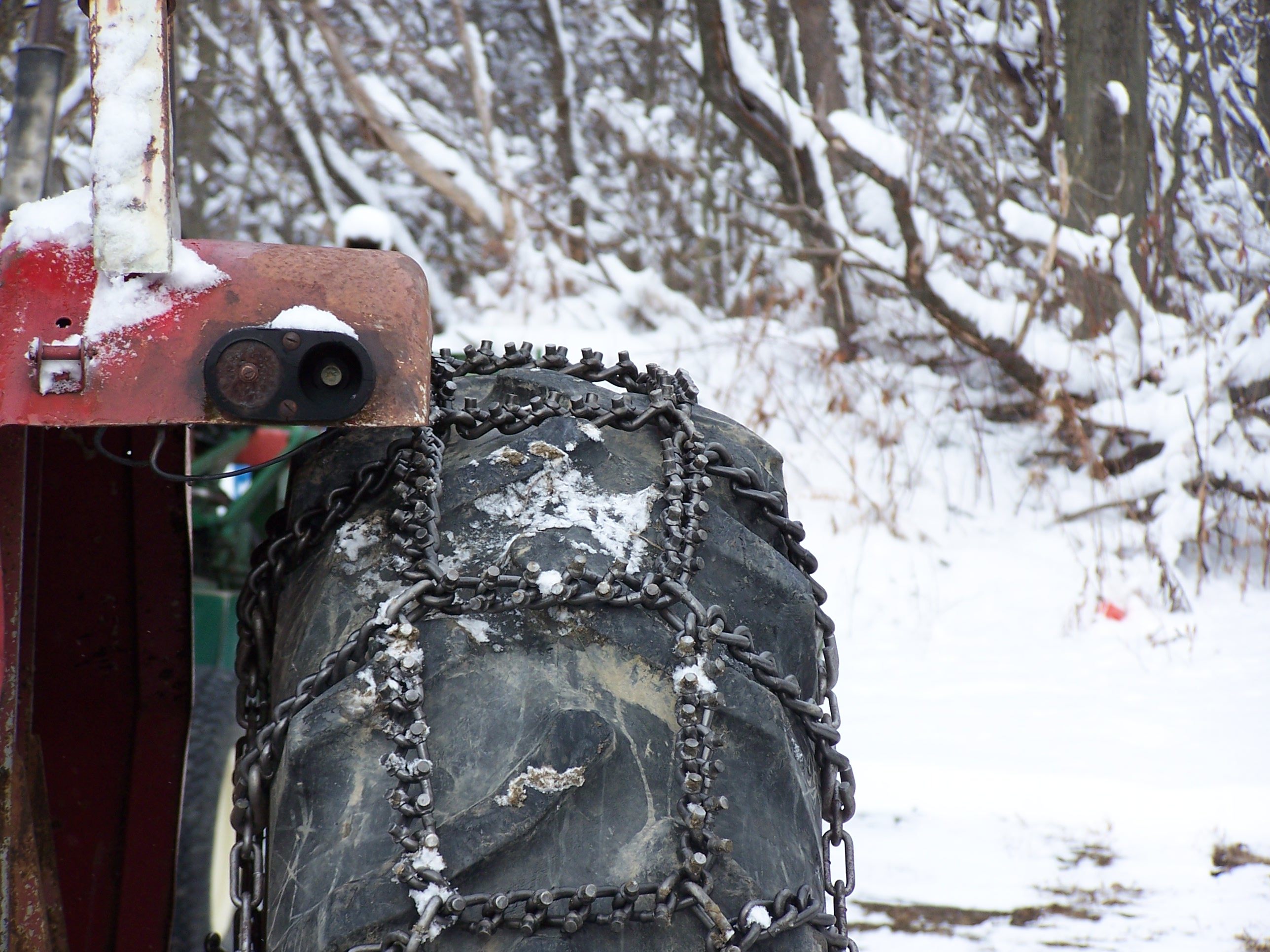

... My chains are studded crosses every 3 link
I've never seen, or even heard of 3 link ladder style chains. No one seems to make them because the links on the side chain don't line up properly when you have an odd-number spacing. Normally it's either two link (i.e. every other link: skip one, then a cross chain at the next), or four link (skip three side links, then attach at the fourth).
Did you make these up yourself, or have them custom made?
/ Chains....Age old question...need some advice #28
Re 3rd link chains----
You have a cross attached to one link then a space and next cross is then on the next or 3rd link.
I found that configuration to work best 4 me.
The way I see it is that being that close there is always at least one cross link in contact.
The conventional cross link chains are so far apart that I was getting a grip-slip-grab kind of traction and that often resulted in wild slip and sliding especially on hills.
By tightening up the space there is always at least one and often 2 cross chains in contact with the icy road.
My drive has a 100 ft rather steep hill close to the house that I need to navigate in order to access the balance of my drive for plowing/blowing.
We frequently get freezing rain so drives are often better suited for ice skating.

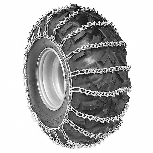

I believe that we have a difference in counting here,
that is what I would consider a 2 link spaced chain.

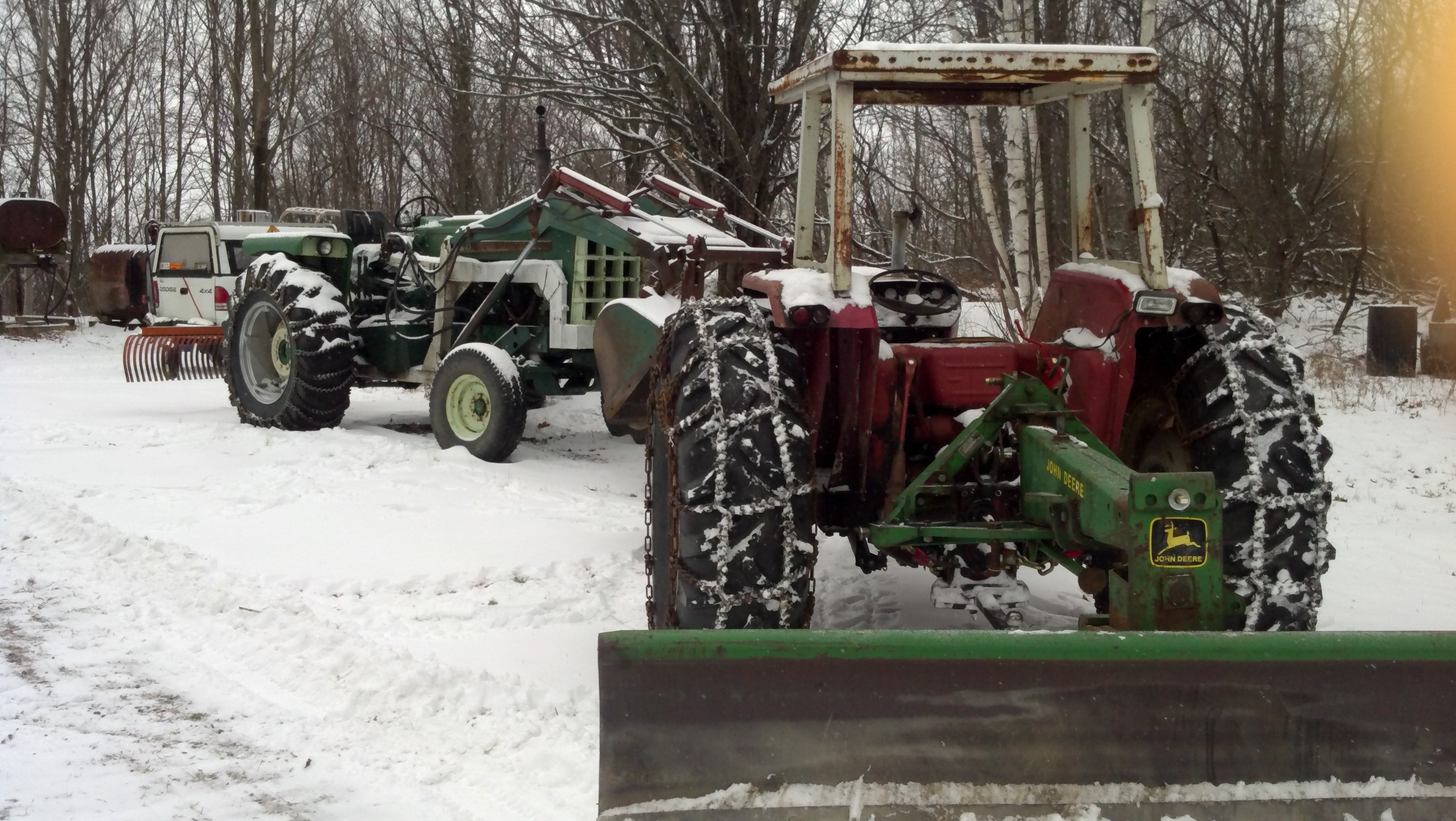

Here is a picture of an advertised two link spacing;
I had two link spaced chains on my Oliver, no comparison to the Euro studded type.
You are not the only one who would consider that a 2 link chain. That is the definition of 2 link ladder style chains.

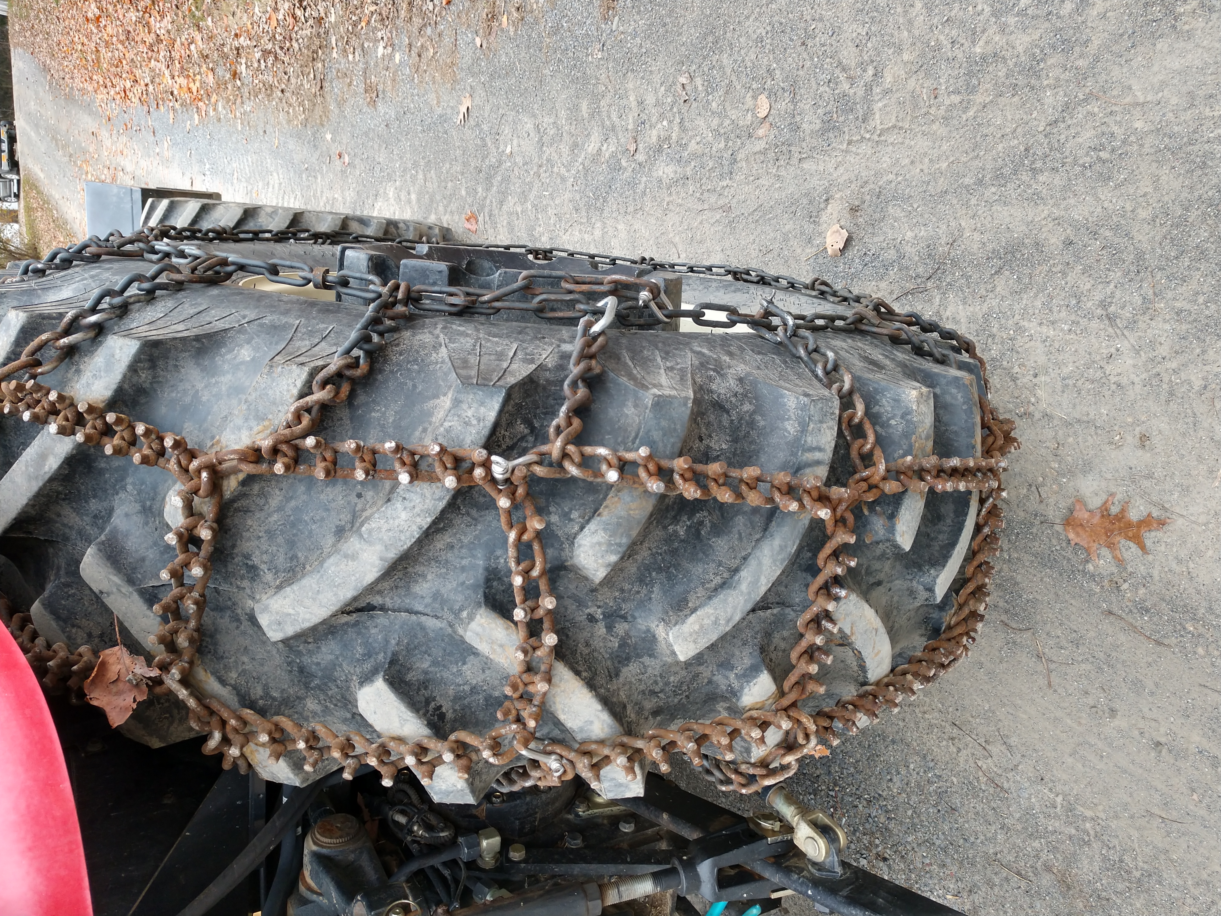

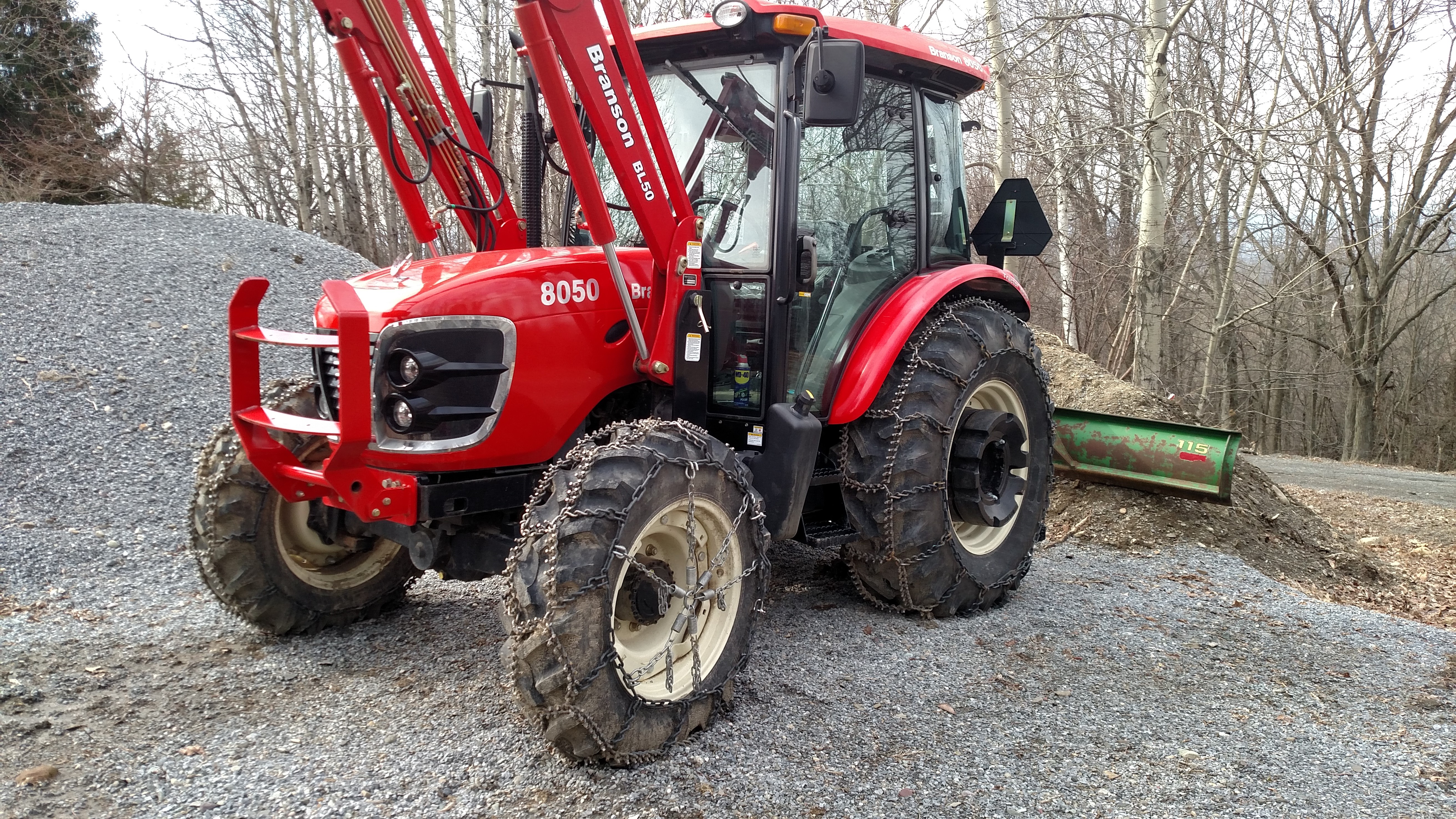

Another option for you: I found chains for my Kioti CK2510 within pickup distance of the NH Bluehills, in Union, ME: Union Farm Equipment | Kubota Dealer in Union, ME
I took delivery of the tractor in late December two years ago. I'm on a private road with mixed gravel and pavement, driveway slopes with tight plowing and bucketing needs. Impending snow required a quick decision. I read numerous posts on this forum, shopped online sources for the various chain styles, then found UFE. A quick call verified the chains were in stock, the price was good, and 2.5 driving hours later I had them in hand. I believe I have the 2 link spaced ladder style chains, and picked them up for the rear wheels only.
I had an experienced tractor owner help me install them that same day in preparation for the storm. He installed them a bit loose with rubber strap tensioners spaced around the inside and outside of the chains. I found the loose slack allowed movement of the chains on the tires during that first season with occasional slap of the inside of the fenders. I installed them tight to the tires last year and found they worked much better with no practical movement over the season, and no slap. These chains have worked great and my neighbors have reaped as many benefits as I have!
/ Chains....Age old question...need some advice #37
I ordered mine through my local ag tire shop. V-bar/studded H pattern is what I settled on, and I'd buy the same again.
Biggest problem is installing them. The chains for my rears are well over 100# per side and it's really a two person job to get them on.
