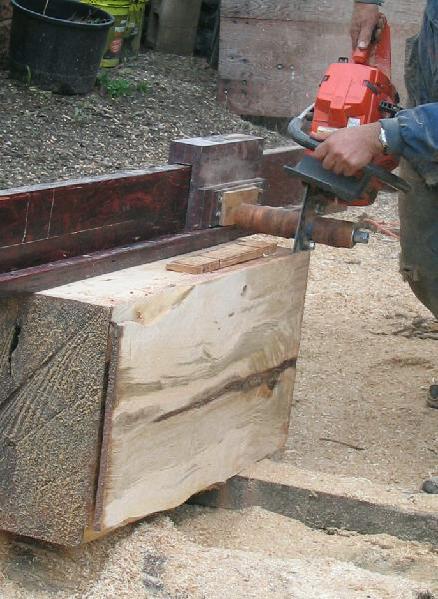

Hi guys, I'm hopefully going to be building a pole shop next summer ( with tractor help) and was wondering what you think of these small chain saw mills?
The area I'll be clearing has some medium sized pines on it. Do you think I could make my own 6x posts?
Any input would be appreciated.

Yes you could mill the posts. It may take awhile though.:D
What kind of mill were you considering?:D

Its the type that has a rolling jig that holds the C saw and moves on tracks.
Any wood quality conserns? Or is it obvious, watch out for knots etc.?

This time last year I was doing a lot of chain saw milling. I was using a Logosol M7 if I remember correctly.
I cut a ton of wood with it. I made siding, framing lumber, and some other stuff. I think you can find it doing a search for "this, that, and the other" and my name.

My chainsaw mill has a double ended bar, used a Stihl 076 on each end, and will make beams up to 16x34. I use it with skip tooth ripping chain and when sharp it leaves a pretty decent finish (rough, but can be planed out smooth in about 3/16")
for example: a buddy and I cut up a large white oak one afternoon into boards - 2 at true 4x28 x11' with the intent of making rafters, and 29 at 2" thick that i have used to make stair treads, a breakfast bar, etc... and still have plenty left to play with.
I got it used for less than $1000.
bandsaw mills start around $3000.
I figured the lower output and doubling my effort was worth the cost difference for my occasional use.

I bought a simple one that uses a straight 2x6 that is used as a guide to keep the chainsaw straight. There are all sorts of other ways to keep it straight, and most are allot better then what I bought. Mine does the job, but it's never going to get a perfectly straight cut. Again, here is where you get what you pay for.
I've made beams for my ceiling in my house and my coffee table with the lumber that I cut with mine. It's tiring, noisy, dusty work. It is WORK!!! The longer the cut, the more you wish you were not there.
I used a standard chain for this and wish I had bought a couple ripping chains. That would make a big difference from what I've read. Next time for sure!!!

I have a Alaskan 36" mill. I cut some slabs with it and it works very well. The hardest part is getting the first cut level. I used an aluminum ladder for the rails so I could make a smooth, level first cut. I was slicing a 16 foot 18" diamter at about 3 to 4 minutes a slab with a chisel chain. I have a rip chain for my 36 inch bar but haven't used it yet.

I've helped a friend with a bandsaw mill, but have no hands on experience with a chain saw mill.
Would you please explain how you make the cuts? It looks like you've added something to your ladder, and I wondered why you restacked the cut boards with spacers.

I've used a 36" Granberg mill for about 20 years to cut hardwood into boards for furniture use. I run it with a Stihl090.It is very dusty, dirty work and hard on the back since I tended to cut thick slabs to avoid turning half the log into sawdust. If everything is working right you can cut clean straight boards.
If cutting these pines is a one time deal IMO you would be better off hiring a guy with a bandmill. But if you can make good use of a larger chainsaw for firewood or more log milling down the road that would also be a good option. In either case make sure you properly stack and cover your lumber while it is drying. Also make sure the boards are at least a foot longer than the final dimensions.
