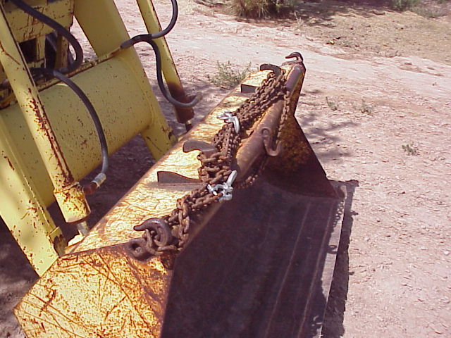

   / Chain hooks #5
Here's a photo of a corner of my bucket. It's got about 5 or 6 hooks on it, but they're not all in this picture of course. When I took this photo, I wasn't thinking of the hooks on the front end loader, so I just picked this one for you because it shows better than the others.
If you want, tomorrow I'll take some photos and post them here.... maybe it'll give you an idea or two.

Thanks, that does give me some ideas. It would be nice to have multiple hooks. Any more pictures you'd like to share would be great.
Thanks for the help!

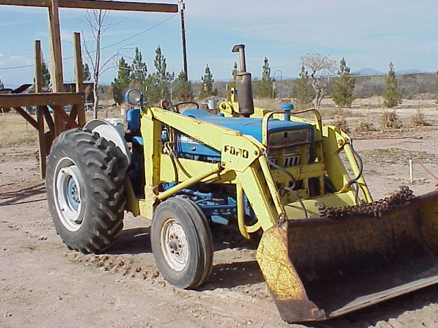

ValleyDweller,
I'm not entirely sure how to post more than 1 image per message, so I'm sending 3 attachments in 3 messages.
This first image shows a chain hook at both top corners and one in the middle. Also, there are two huge homemade slip hooks near the center. They're good for utility and for (like I have here) wrapping your chain around so it's always with the bucket.
