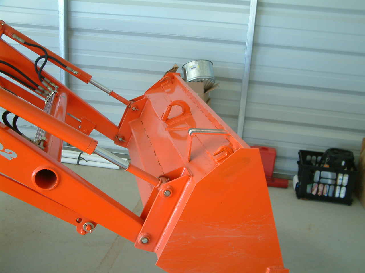

Here's one way to add chain hooks to an FEL bucket, in this case on my B7510HST. The dealer welded the reinforcement on the bucket and then added the hooks, no charge.

I really like the middle hook. where did you get that weld on hook?
   / Chain hooks #23
<font color="blue">where did you get that weld on hook? </font>
Try aw direct
They have several choices, a good site, and made in the USA.
Lou
   / Chain hooks #24
Apart from the hooks, they also have a U-bracket with a slot cut in it to hold chain. Adding hooks to my bucket will be one of my winter projects but it looks as if the U-bracket will be easier to weld on to the bucket and be stronger. I'm seriously thinking of sending for 3 to use instead of the hooks I already have but not installed.
