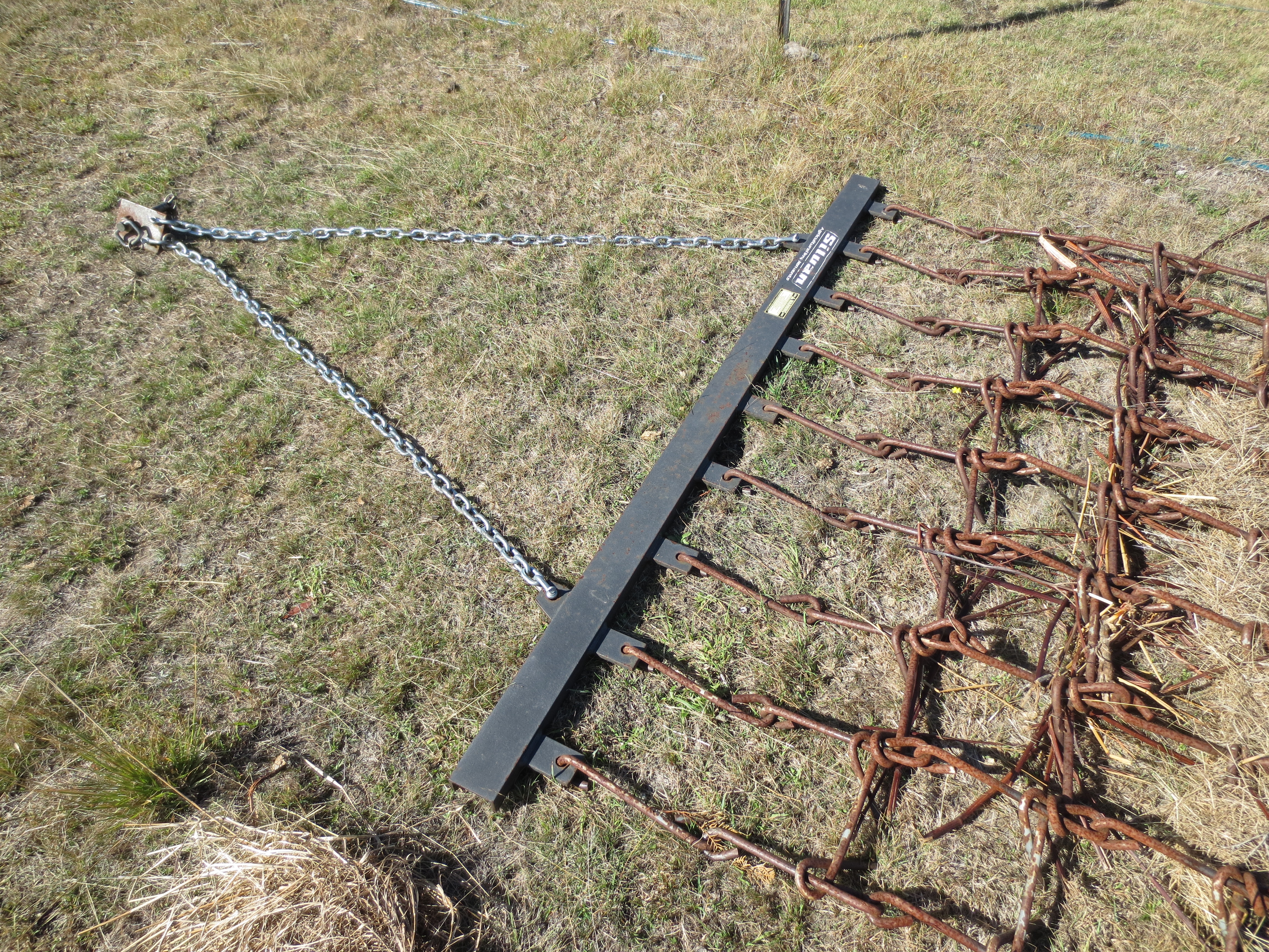

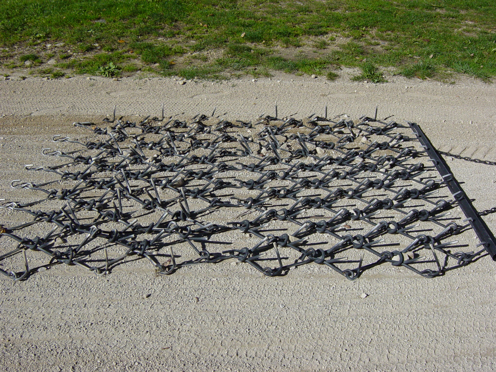

All the years on here and chain harrows are something I don't ever read about.
Always wanted one, but not a really Big aggressive Ag unit.
Finally bought one. Had to drive to Lockport NY TSC to get one.
What sole me? Smaller Size and shorter tines. Two pieces so you can have one spike down and the other spike up for smoothing. You also have two tine options for more or less aggressive operation.
Loyal 6X8 (2 of 4 feet long) $529.00 USD

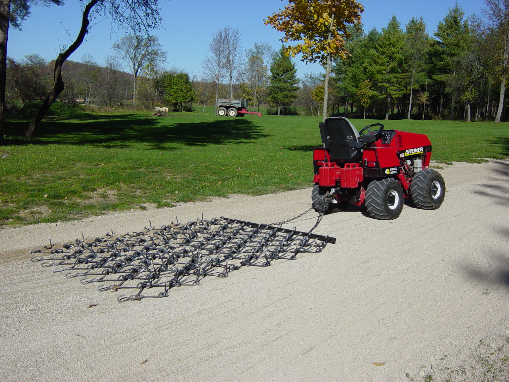

Nice! you will like having this, lots of uses. Ours is two piece looking much like yours and from TSC as well; it can go into tight spaces if needed then get bigger for driveways and all else. It can be turned over for lighter scraping like in fields and such or, be aggressive on the other side like when we use it for tearing up the pasture getting some aeration to the grasses while helping destroy some of the weeds..Changing from large to small and back again takes a few minutes each way or like you mention, one up and one down. Mostly we use it for our large gravel turnaround being 200 by 150 feet to smooth out the ruts and gravel piles from heavy equipment loads. Also works on the few trails and walkways using one section only and for the tighter turns..We pull it using the JD Gator diesel but any larger ATV will work just as well. Great tool around the farm or any large space needing to be surfaced smooth.

So far, I am not regretting my purchase. I do notice on the driveway that the drag harrow is better at ripping down bumps then filling in low spots, and that's usually what you have as in pot holes and wash outs.
I do like that the drag doesn't throw the material sideways onto the grass as much as a solid drag.
/ Chain/Drag Harrow #17
The drag won't move material from here to there much, more they smooth over the tops. Mostly I run a Land Plane over the driveway to move material into the holes and ruts then if needed, pull the drag to smooth things out. Having a rough driveway that goes up and down hills this method works pretty well for our situation. On the flat ground the drag is all I use for the most part.
