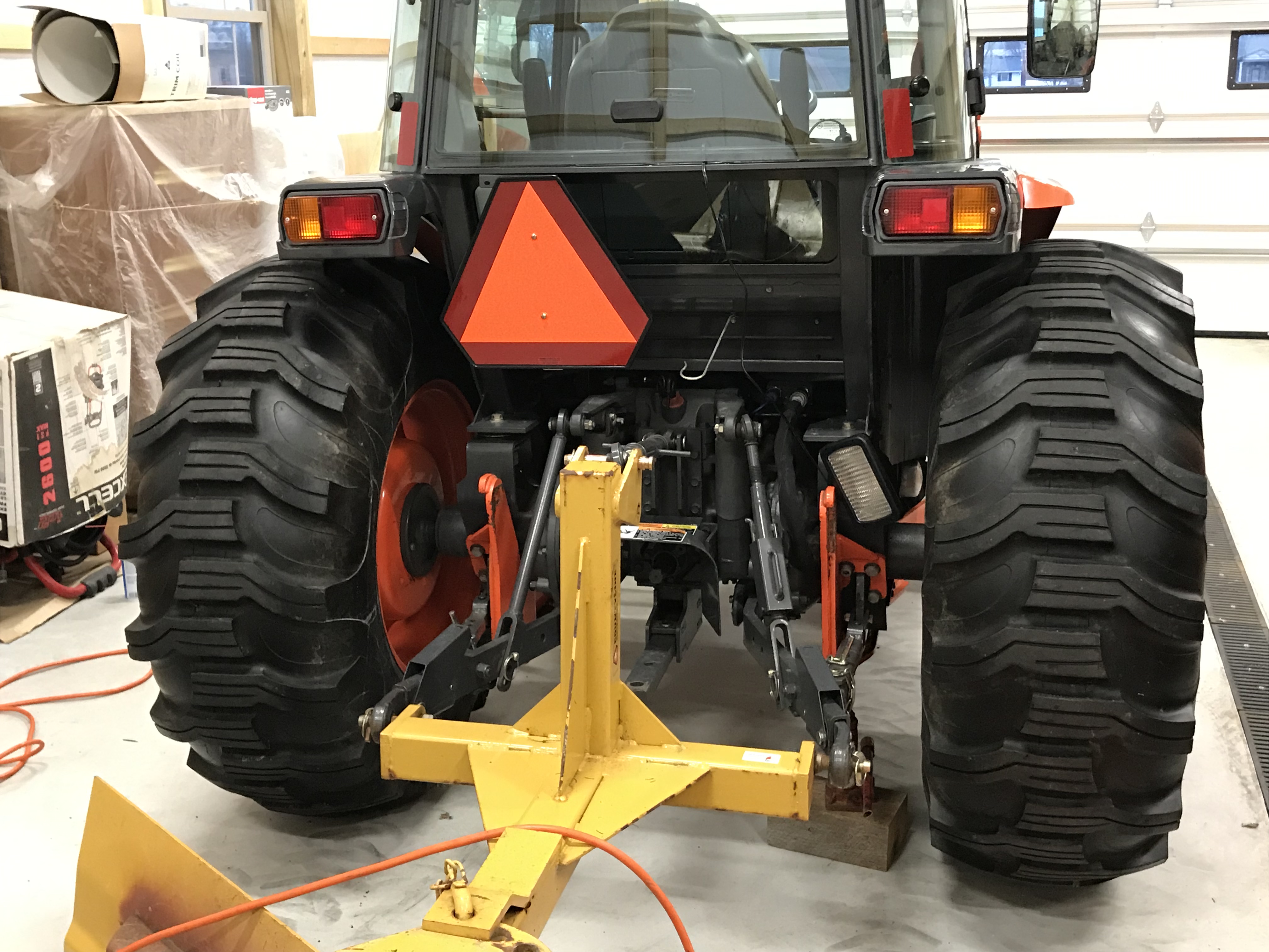

The L4240 has the wheels set wide. Not sure what the measurement is, but the center of the tire is approx. at the widest edge of the rear fender. It has always felt very stable. I can picture flopping over if it slid down a hill and something "tripped" it the bottom. Can't imagine going on a sidehill where the CG would be outboard of the tire center. Seems like it would slide first.
Your L4240 has rear tread of 60.2" max and 50.6" min. Those big 17.5x24 industrials add about 17.5" to the 60.2" so your outer edges are roughly 77.7" apart or 6ft 5.7" Half of that is ~ 38.9" How high is your c.g. do you think? If the cg is 36" off the ground then the triangle is 36" hi and 38.9" base so the angle would be 42 degrees. (angle whose tangent is 36/38.9 is 42 deg.) I don't have a way to estimate your cg but that is the idea and the lower the angle the harder it is to roll you over.
As I said in an earlier post there are a LOT of variables and it becomes an individual thing to get at your comfort level on your ground with your machine and the rest of the circumstances. If you are real comfortable with the L4240 on those tires at those widths -- hey good for you and there is a data point.
By the way: If you ever get into a sideways slide due to slope steepness you are in real serious danger and very out of control ! The right action there is to turn your steering wheel into the slide and step on the gas to get some forward motion -- whatever you have to do to get headed straight down the hill.

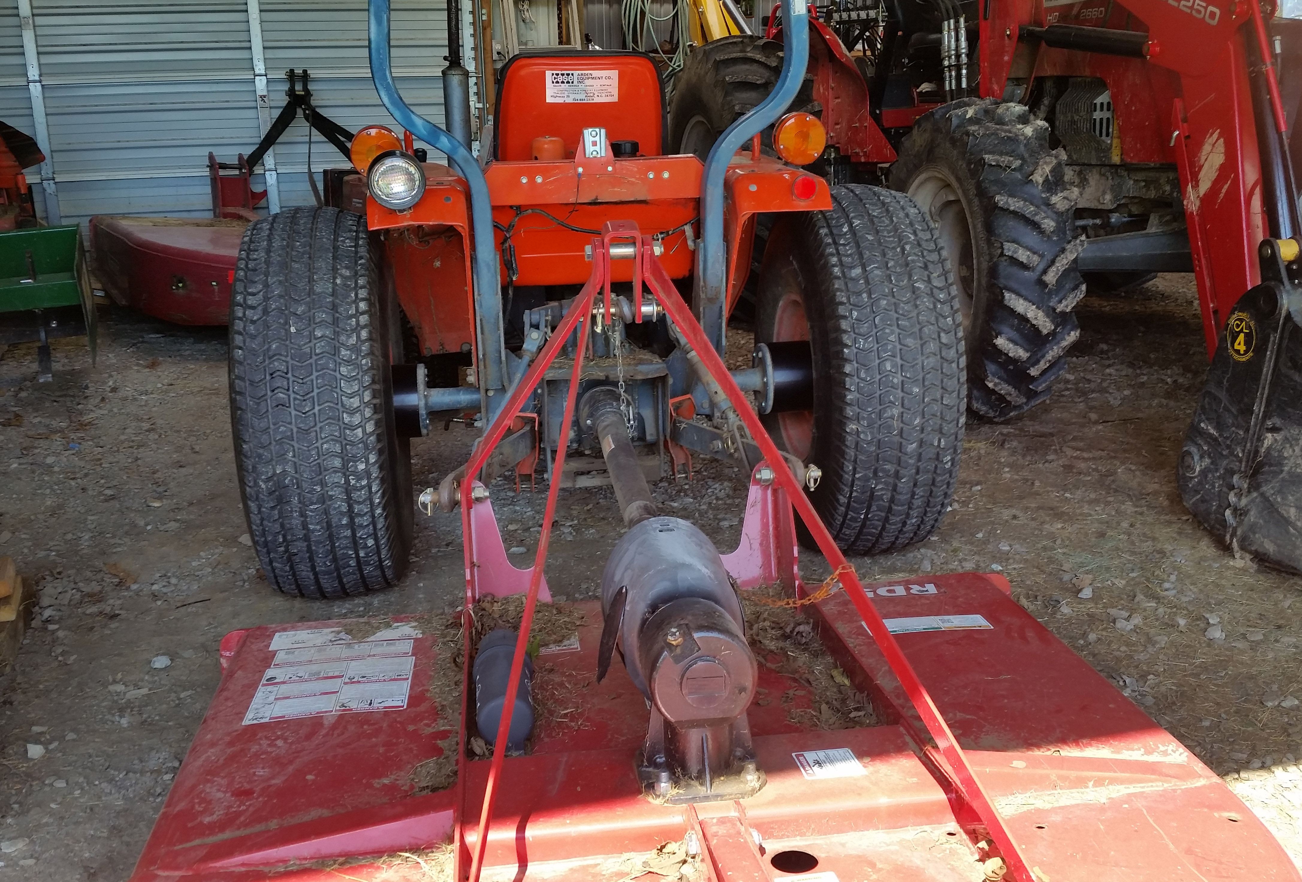

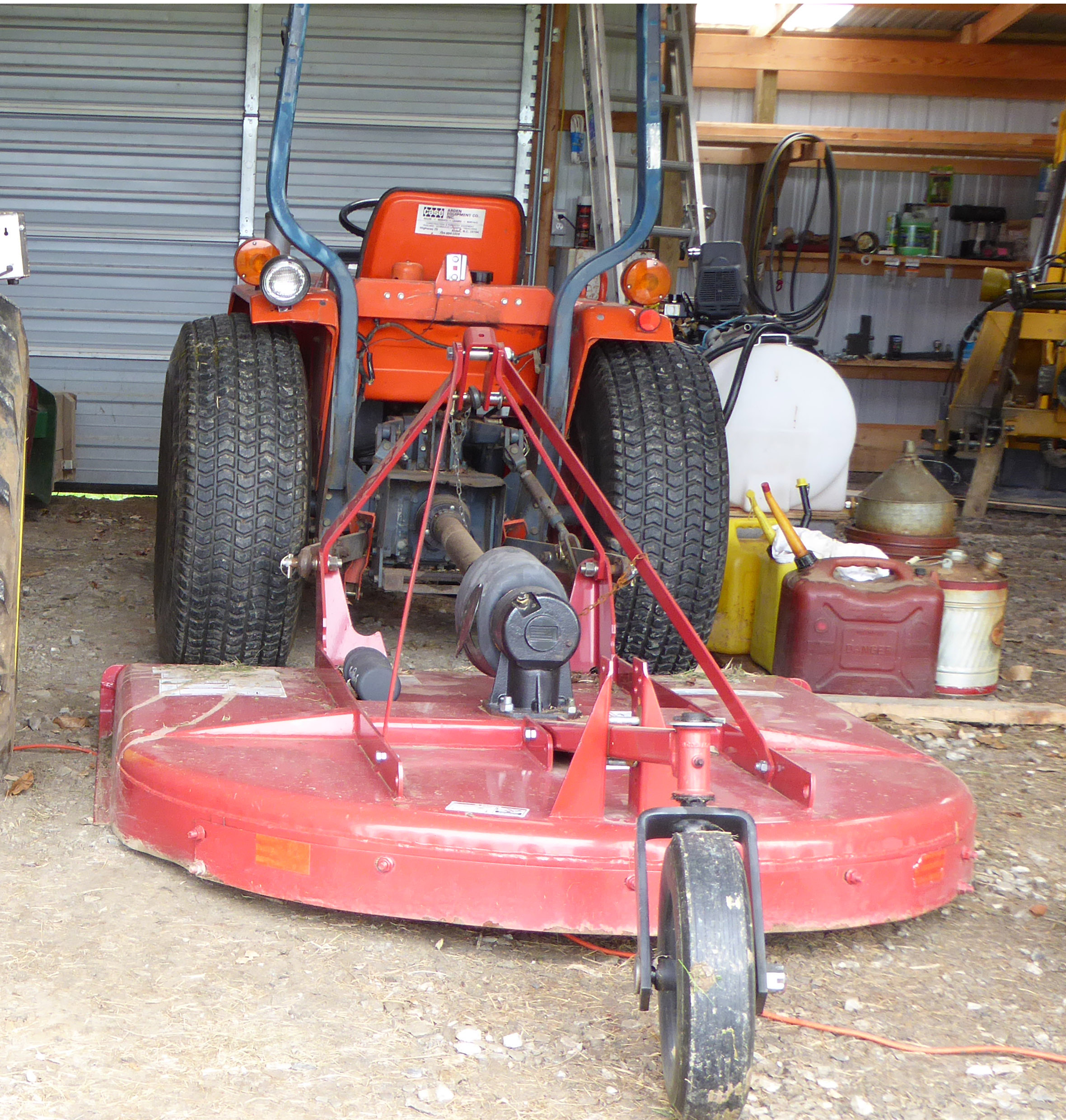

I have had trouble inserting pictures in TBN and no response yet from the website helpers. I am going to try to post Before and After here of the B2150 -- with and without the 6" spacers on each side.
Before and after.
Note: Turf tires are on this tractor for extraneous reasons.

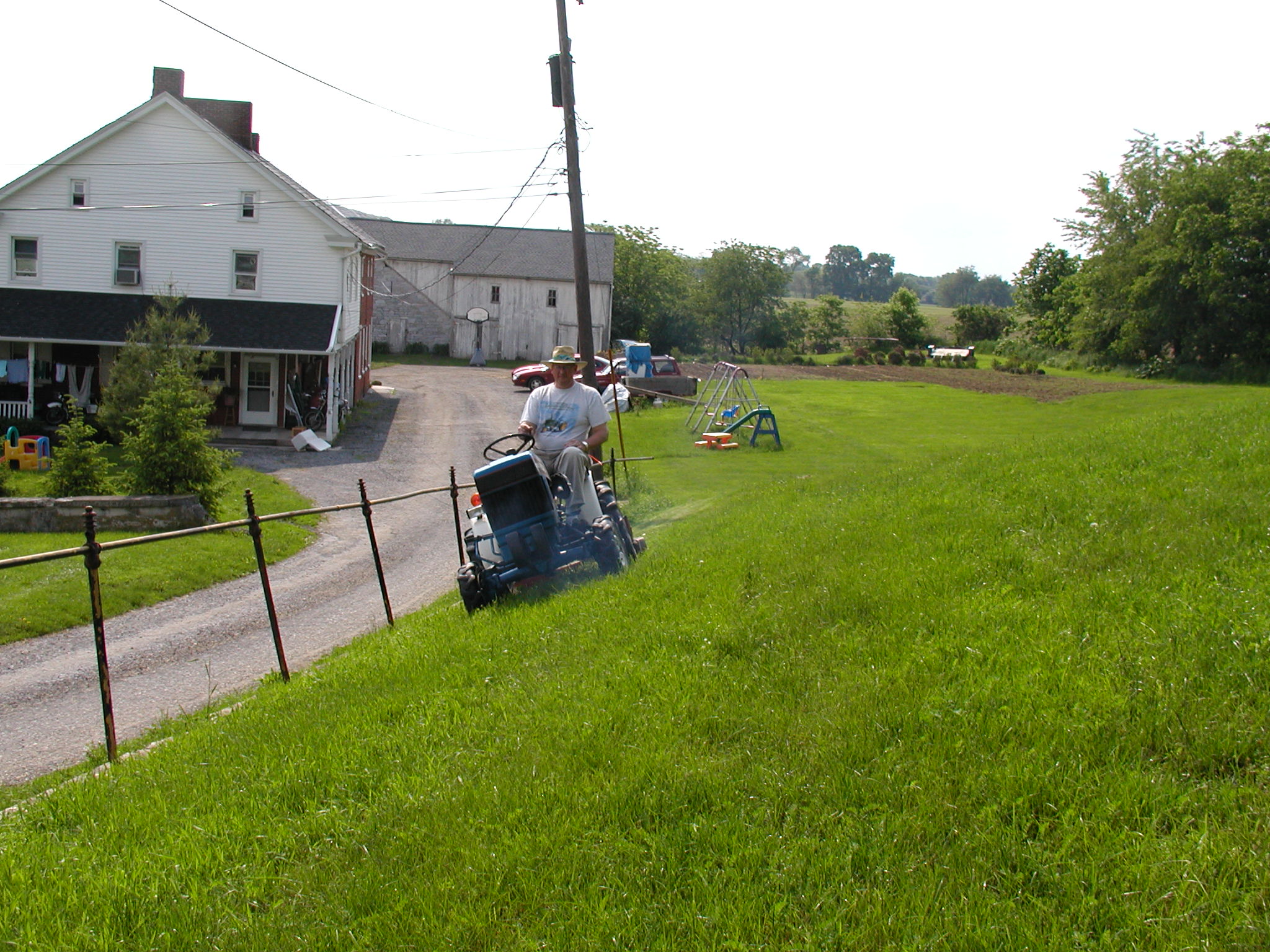

Years ago I had a sliding experience. At the time, I had a Kubota B7500 and the old Ford, both with 5' RFM's. My MIL had around 5 acres that my youngest son and I mowed weekly. The Ford stayed at her place and the 'Bota was driven back and forth. This rear portion of the yard has just enough slope to make it a little sketchy. The pole in the picture is pulled cockeyed, so to get an idea of the slope, compare the ground with the buildings. Usually, the Ford would "crab" along and for this slope I always used 4WD.
One time the grass was a little too wet, and the rear really broke loose. I was about half way up the slope. That pipe fence at the bottom is where the ground drops off. I steered uphill and mashed the hydro and got it to dig i a little. #3 Son was pleased to come and pull Dad and Ford up the hill with the Kubota.
