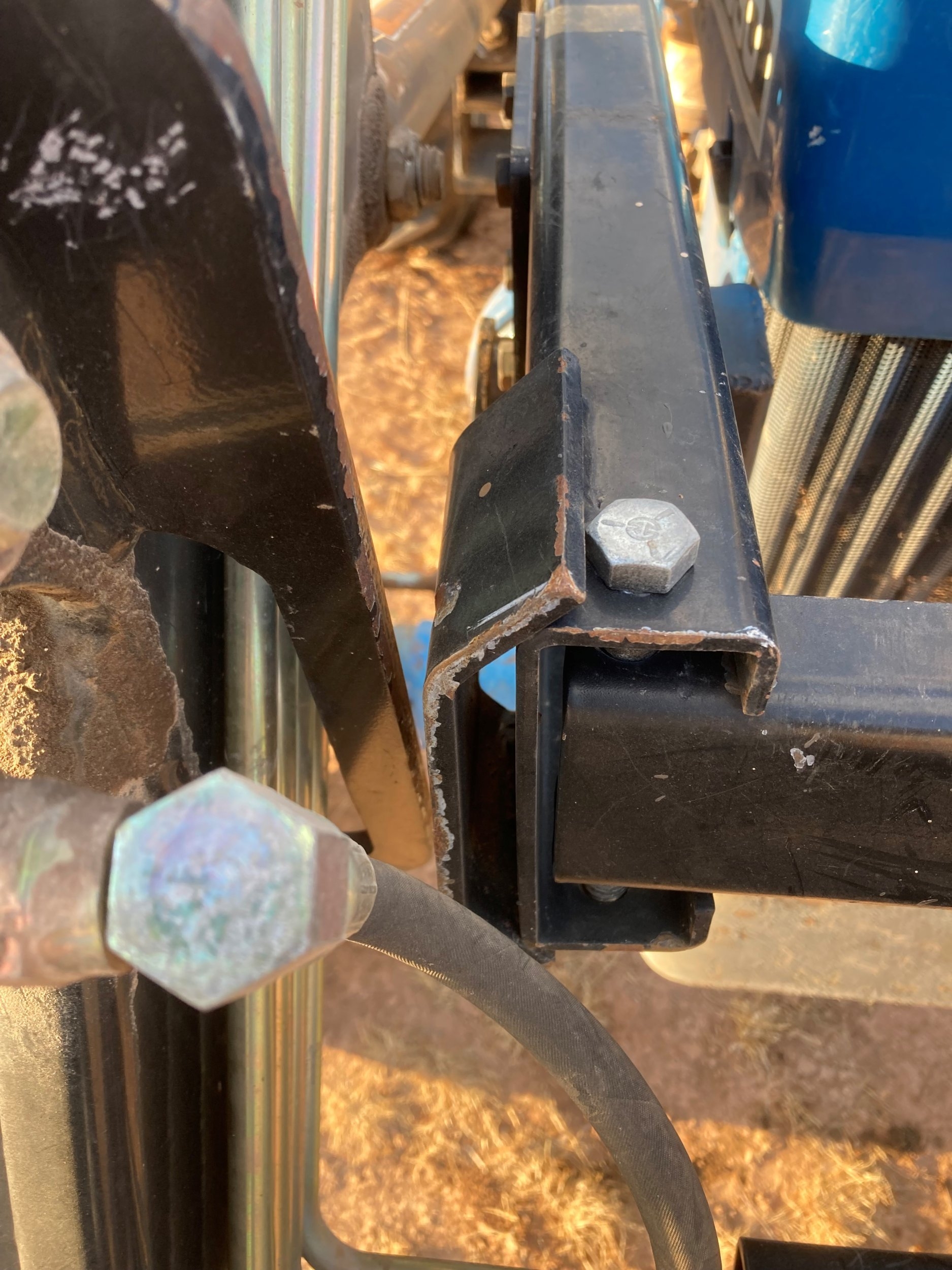

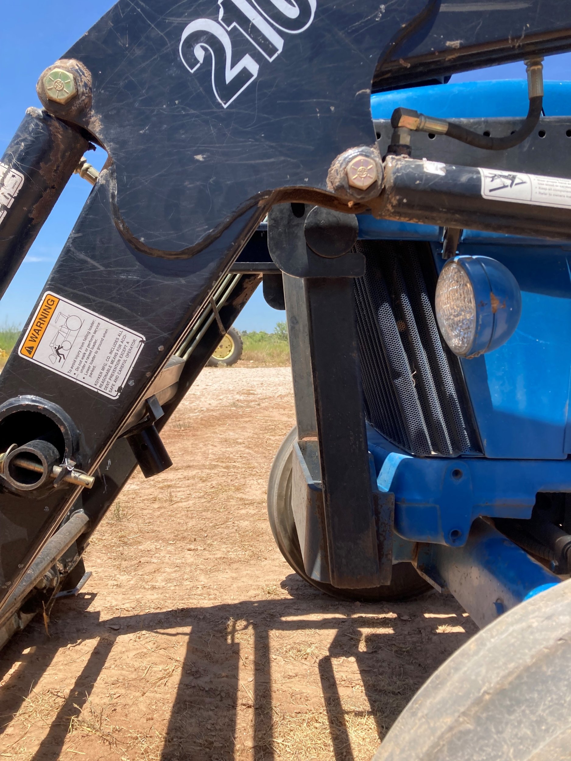

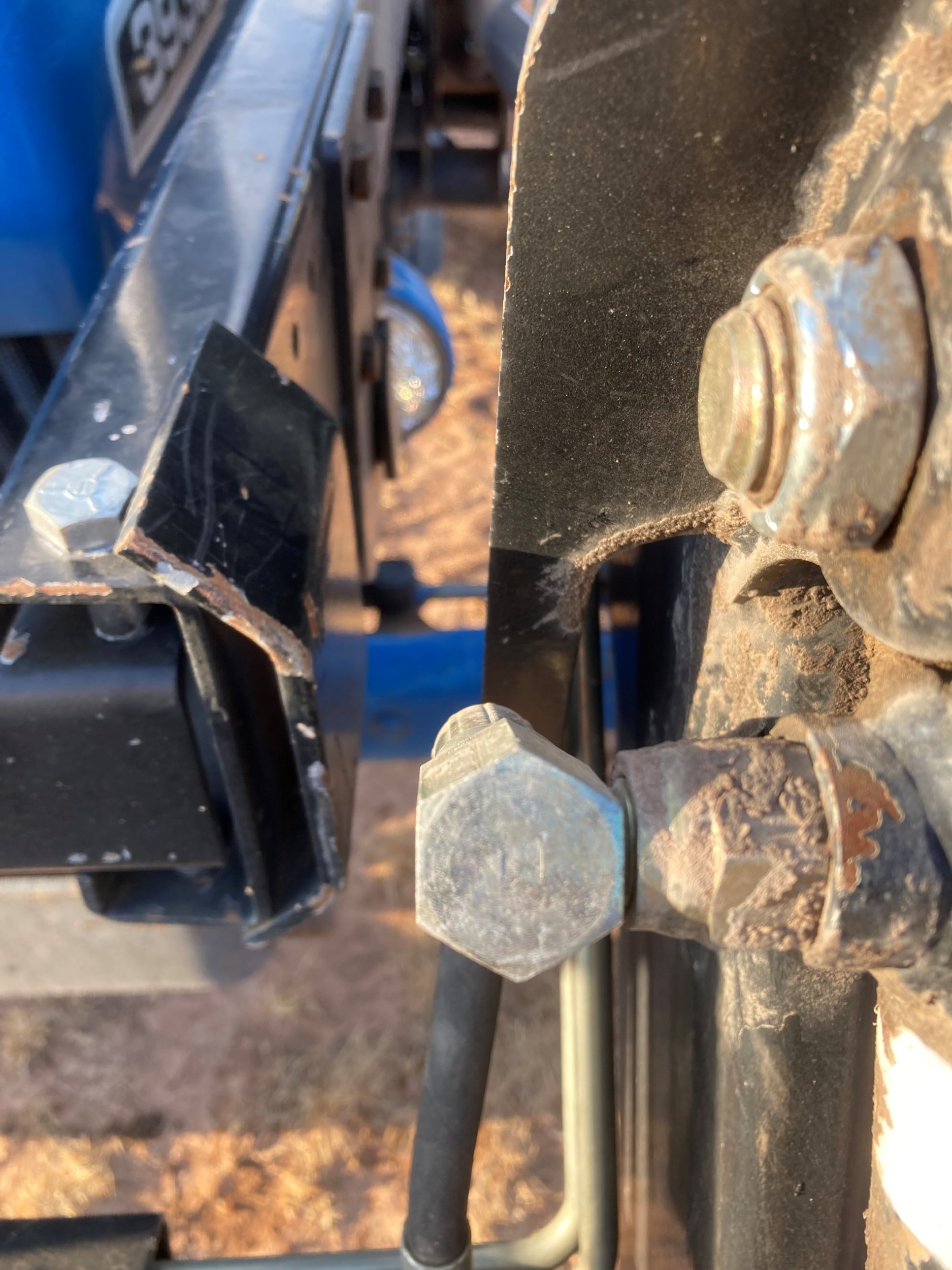

I went out and ran the loader to both stops and held it a couple of times. Then lowered the bucket to about six inches off the ground and measured as best I could. The hydraulic cylinder pins are actually bolts. Measuring from outside to outside, the left side is maybe a sixteenth of an inch shorter. Not enough in my opinion to cause the shift to the left. On a whim, I'm going to loosen the four bolts holding the mounting frame to the front of the tractor just to see if something shifts. While I had the tape measure out, I measured the gaps on the left and right. The left is 1 1/2", the right is 1/2"

Those pics help, Yes not really pins but bolts .
but how about some from more of a Macro view from say 10 feet directly in front with the FEL up and then with the bucket just off of the ground in a level area. Thanks
ps. There is something different in those front guides compared to mine.

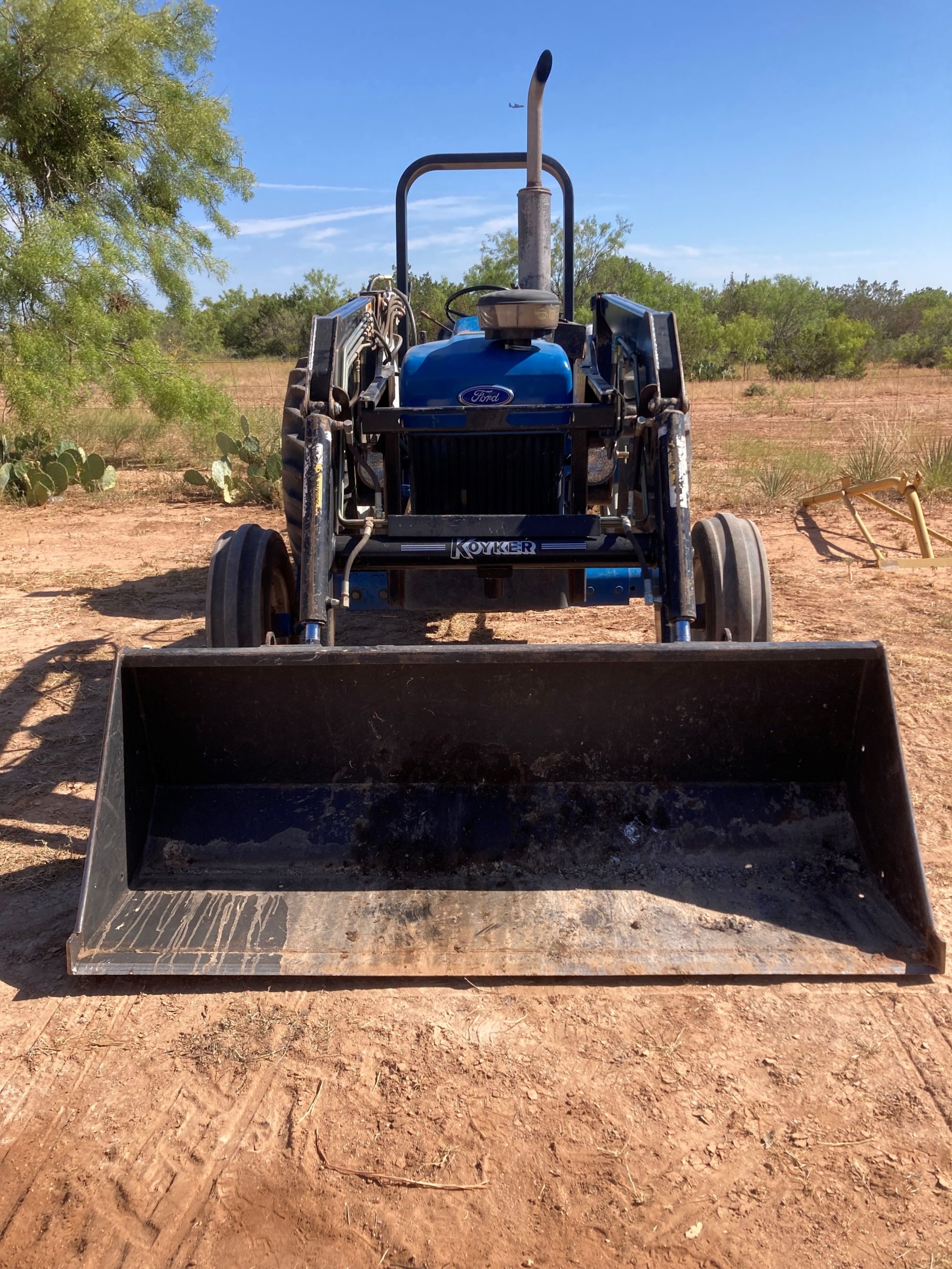

Can you back off a few feet and take pictures showing more of whole assembly, you pics are so closeup its hard to see what the overall situation is...

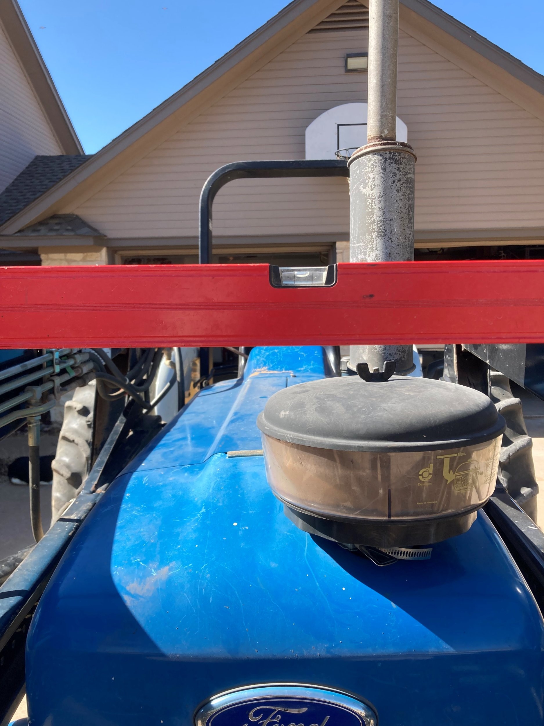

I took the tractor for a shakedown ride. Unfortunately, the arms shifted back to the left, so nothing was gained. I then parked it on the driveway as that is the most level place with tools close by. I put a level on the crossmember of what Koyker calls the right and left uprights. The uprights are the two T shaped pieces that are tied together at the upper nose of the tractor. The actual upright portions sit in the pockets bolted to the tractor at the transmission. The upper end of the uprights are where the arms are pinned and pivot up and down. The level on the crossmember showed that the left side needed to come up about 3/8". I loosened the four bolts on the nose of the tractor frame and lifted it until the bubble in the level was centered.

Backing away from the tractor, it was obvious that the right arm was higher than the left. I put a level across the arms and determined that the left arm would have to be raised about a half inch for the two arms to be level with each other.

I noticed that the right side of the bucket touches the ground about an inch sooner than the left. However, there is enough slop in the attachments for the bucket to level out nicely. I can work with that, but I'll just have to get over my OCD and live with a whopper jawed loader when the bucket is off the ground or bite the bullet and change the front support on the left side..
