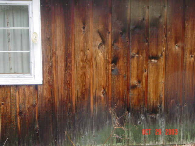

I just bought a cabin in Northern Michigan that has Cedar siding. The outside is very dirty (black). I have heard that using a bleach solution will clean this up so I can stain it.
I was planning on rolling on a bleach solution then powerwashing it off.
Then I was going to use an oil based stain. Does that sound like a good plan?

Here is a picture of the siding. It is really bad.
Did either of you ever stain cedar rather than paint it?

here is a close up

That can be cleaned off with a pressure washer about 1000 to 2000 psi and a 45 degree angle tip on your wand.

I use a clear sealer on mine. It's TWP by Amteco. There are a variety of shades in this line; I use 101 or 501 which is essentially no shading at all.
I've found I can get about 7 years between reapplications of this product.

Follow the good advice of RSKY, as he has a good mixture that will kill the mildew (that is what the dark color black is on your siding) and get the siding as clean as it can be done. You can use the power washer and blow the surface wood away to get down below the mildewed surface too, but that leaves a lot of torn fibers of wood on the surface. Re bleach the areas that don't come clean the first time. Decks can be cleaned up the same way.
Finish - I'd recommend a semi-transparent stain rather than any kind of paint. The stain soaks into the wood, and isn't a film-forming finish that can flake or peel off later. Also, refinishing is much easier in the future with the semi-transparent (non film-forming) stain.
I'd move the propane tank so it doesn't cause the water from the roof to splash on the siding (or put eaves troughs on) and help avoid the mildew happening behind the tank.
A light bleach wash annually or every other year would help keep the mildew (mold) away from your siding, and keep it looking better, longer.

Use a good wood preservative to coat the end-grain at the bottom of the boards. Water runs down the boards and is soaked up into the boards, increasing the likelihood of rot starting there. Make sure it is a preservative compatible with the stain/coating that you're using.

Moving the propane tank is one of the first priorities other than cleaning the siding.
I plan on using the "solution" then powerwashing then reapplying where needed.
Once clean I planned on using a stain. That TWP sounds like it is good stuff as I went to the website.

I bought it at a local paint store. In fact, I recall I did contact Amteco directly at first and they referred me to a local dealer.
TWP won't improve the look of the cedar any; it will pretty much just preserve whatever look you have after washing.
