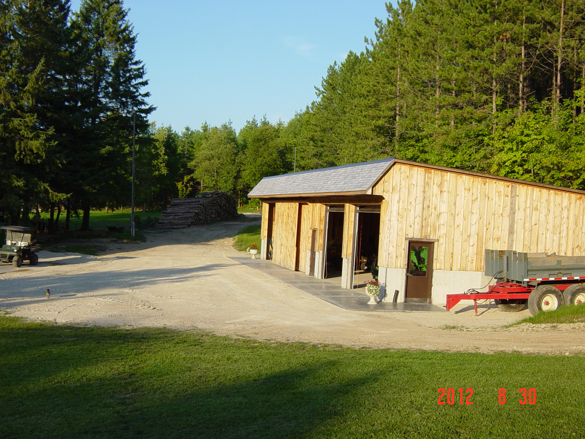

I put cedar shingles on my house and garage with disappointing results. Wrong location, wrong pitch, wrong installation.
But I did choose to use them again on this project.
Well Ventilated, on strapping, special nails hand installed (not air nailed) and they will see no traffic.
Always liked the looks of those buildings wish I had a shop that looked like that. The cedar shingles on the front are a great touch.

I got those on the drive shed, by converting VISA points into Home Hardware Dollars at Parr.

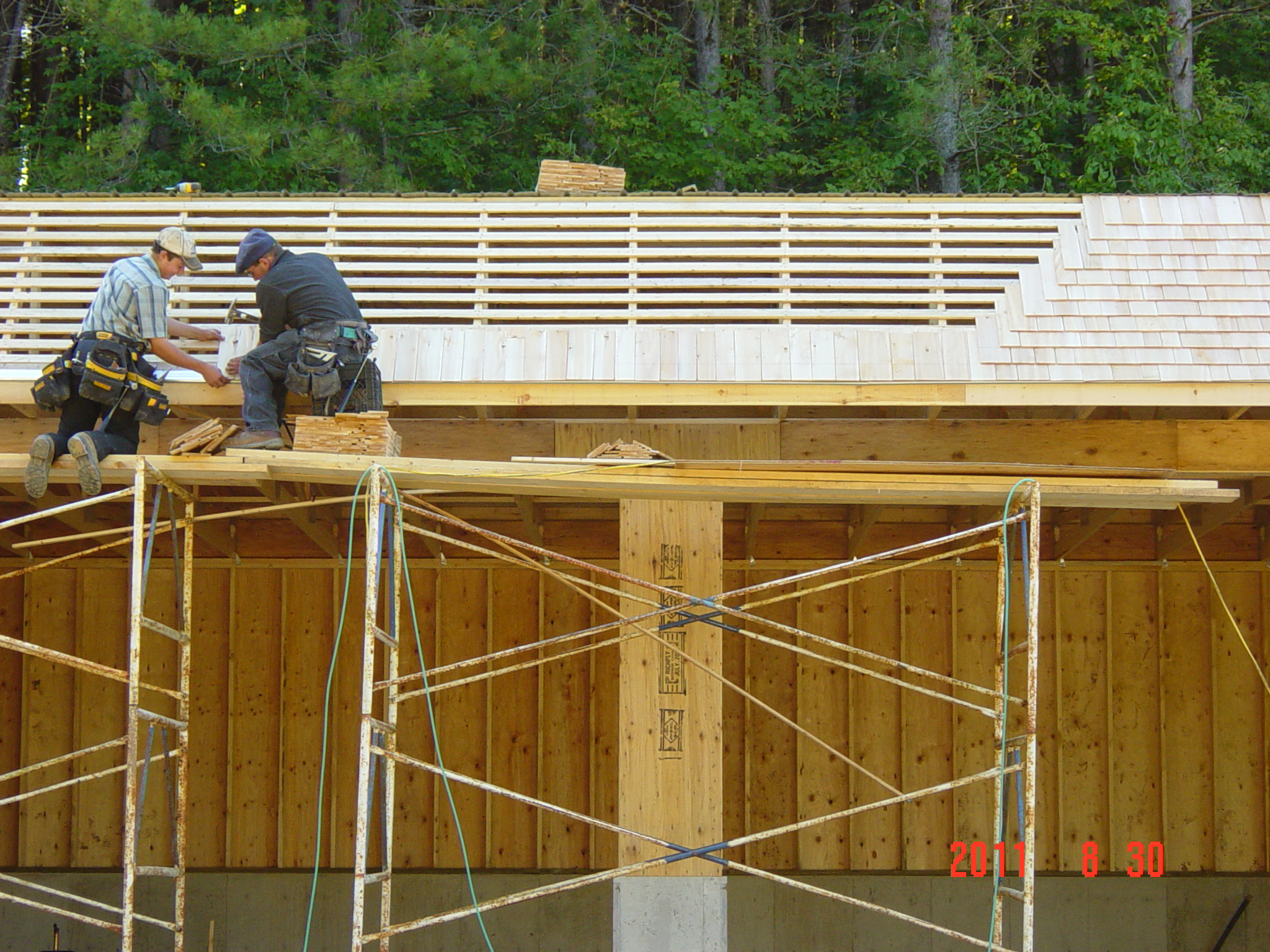

I had my house and garage done by Mennonites, that I thought would do the job right. They didn't strap them and leave an air space. BUT, how could you walk on them with an air space? You need to be able to walk on a roof? And, I think it's possible that the woodpeckers might have become interested if their was a void with insects. They have never touched my cedar roofs, but sure laid waste to board and baton if there was an air space behind with cluster flies.
Looking at that picture, I guess strapped that closely would allow you to walk on it, but it doesn't seem like there is much space for circulation.
My roof is strapped!
About 3-1/2" open between strapping.
No problem walking on the roof.
You could dance on it, but it is 10/12 pitch, so some fancy footwork might be necessary, and the cedar is slippery.
