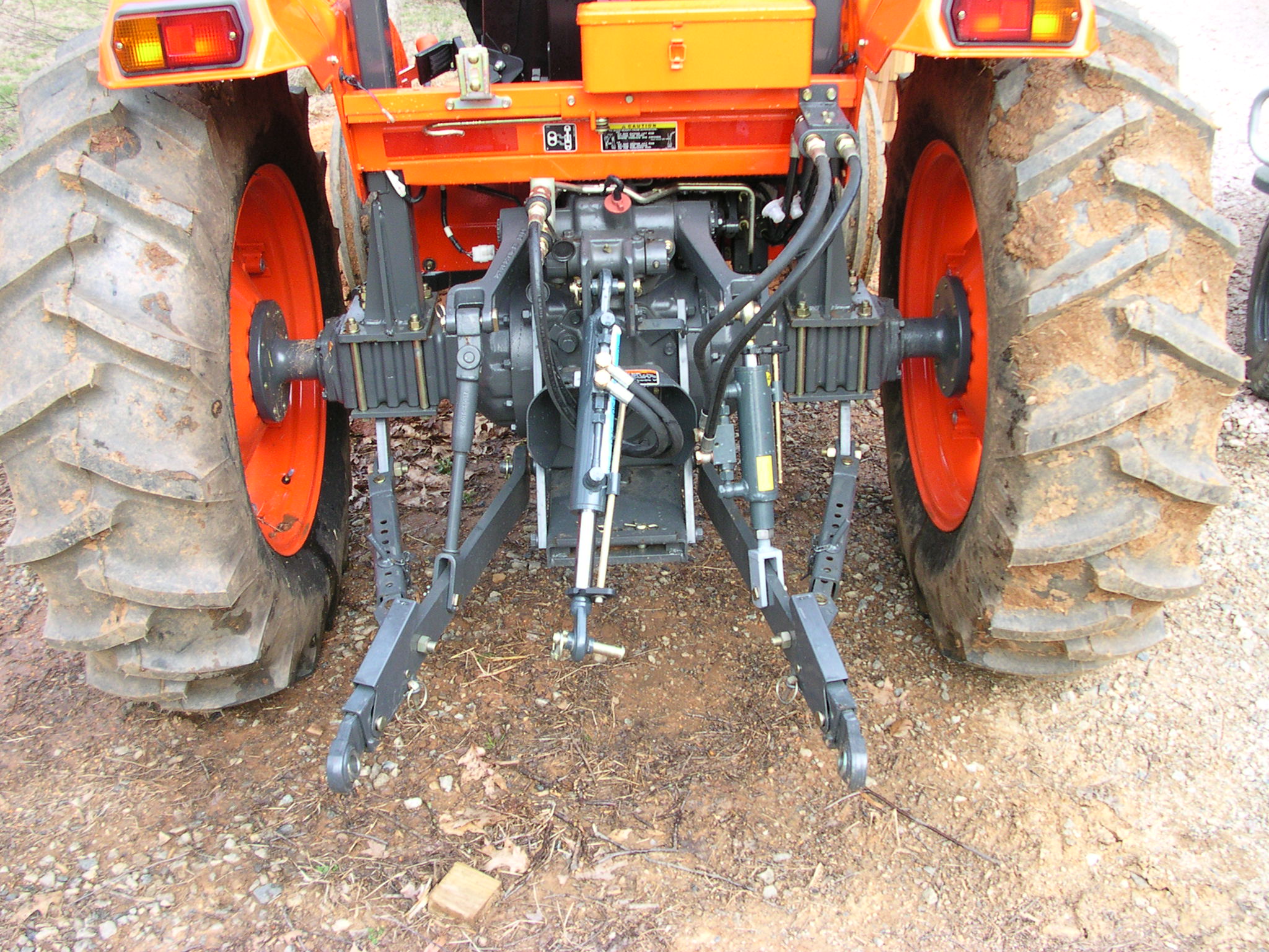

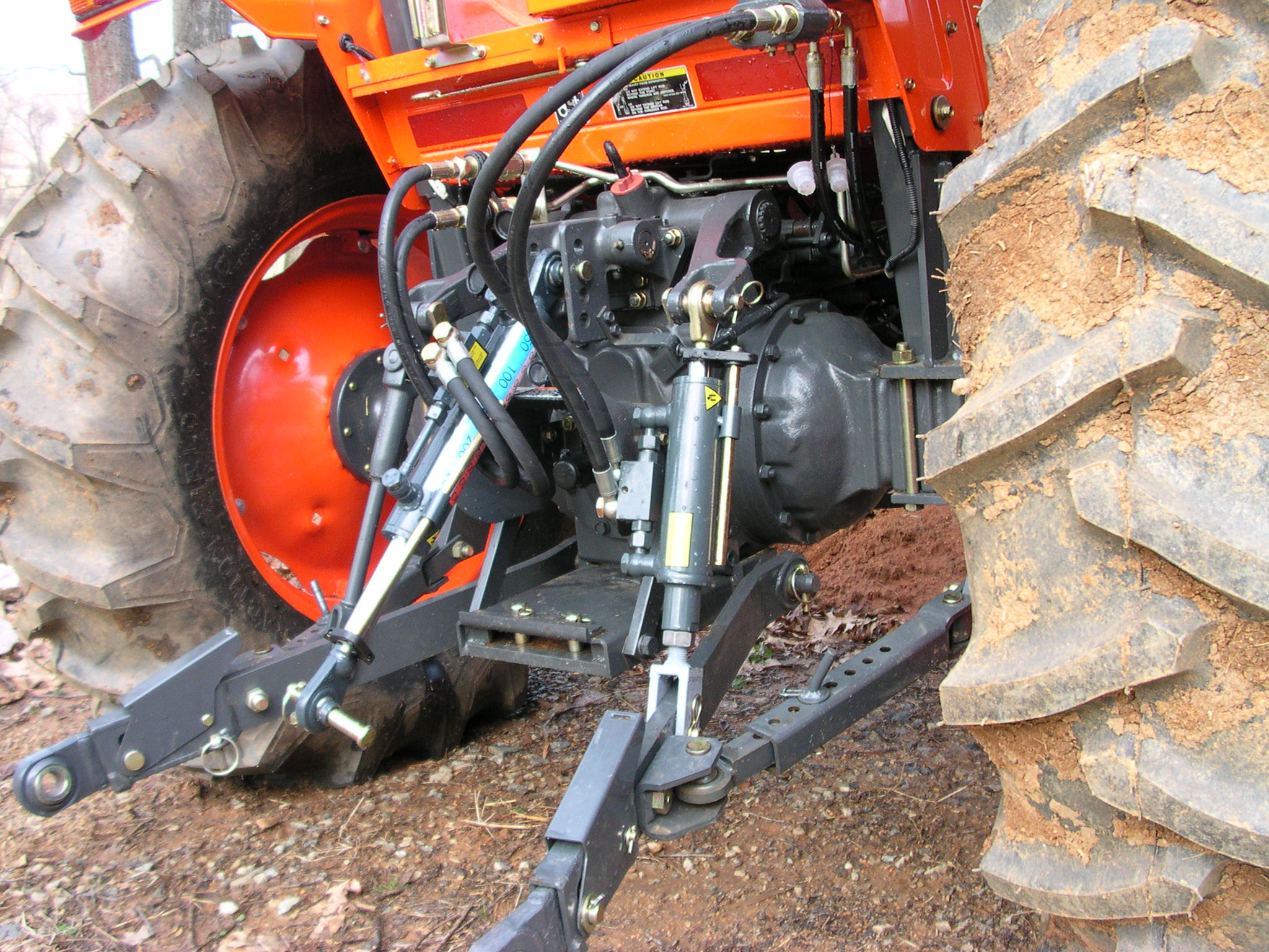

CCM's finest ready for summer!
   / CCM Hydraulic Toplinks have Arrived!! #15
Top link on my TC40DAss is about 20 1/4" fully retracted and 30 1/4" fully extended. Fully extended is at a real angle. I don't really know what you would use at that angle, but those are the numbers. Good luck.
