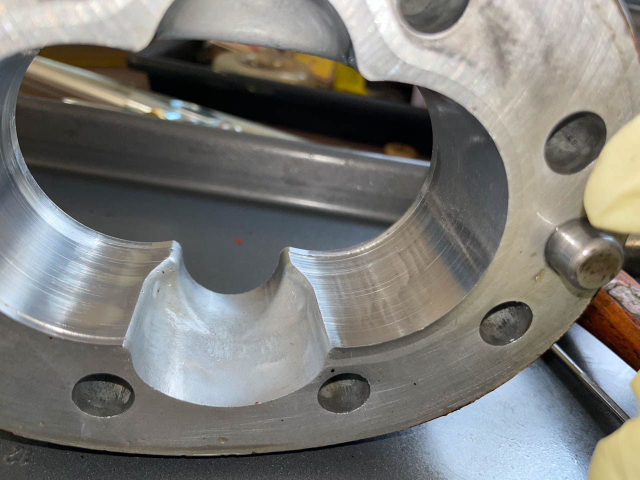

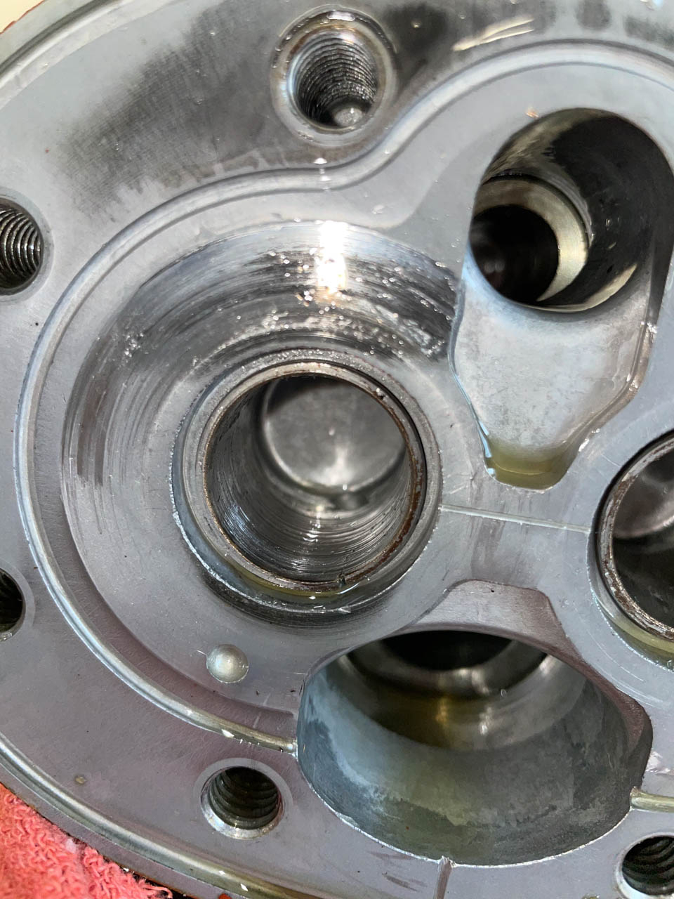

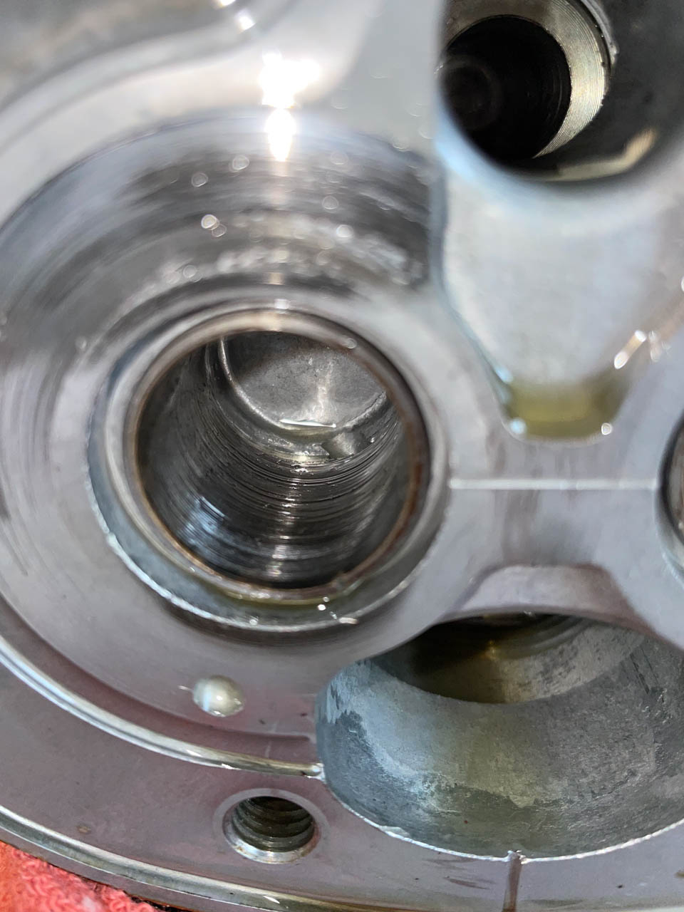

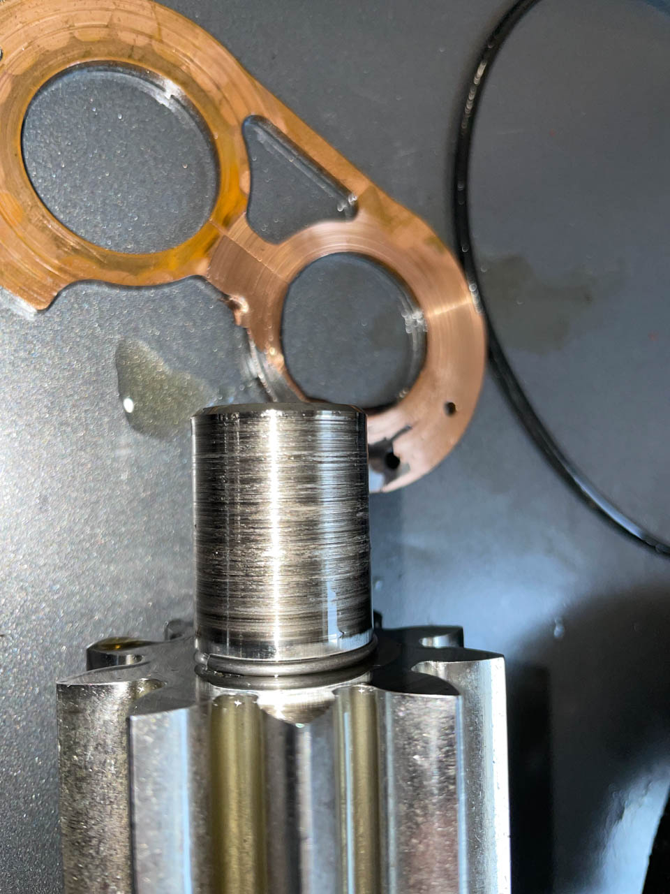

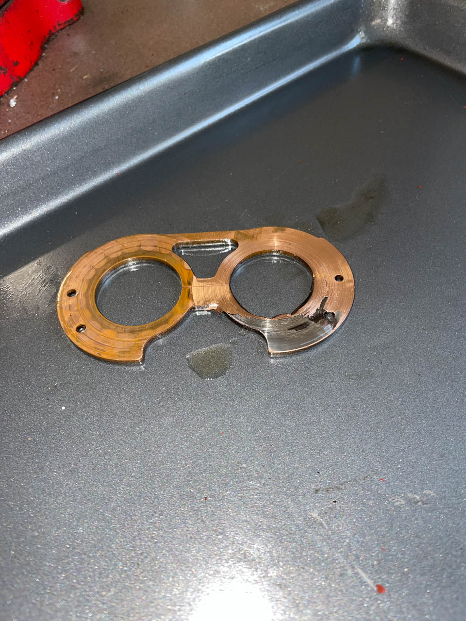

I'm cross posting this in the Hydraulics forum since it's now clearly a hydraulic problem. I'd love to get a read from experienced hydraulic repair people about what might have caused this damage.
This is a 3PH PTO driven hydraulic pump that is part of a power pack for powering a hydraulic snow blower. It's used and new to me, so I have no history on the machine. But it wasn't developing power as expected so I started looking into the system pressure which turned out to be 1000 psi rather than 3000 psi. I rearranged my test gear to test the pump, and here's what I found.
I hooked up my flow meter, gauge, and variable restrictor immediately at the outlet of the pump. With engine at idle, no load but the blower rotating, I get 10 gpm and barely detectable pressure. That's normal. But when I apply load to the pump by restricting flow, it couldn't develop more than 500 psi, even when completely dead headed. This is down from 1000 psi just yesterday.
So I pulled the pump apart and indeed it's trashed. Take a look at the attached pictures. I think the housing it too damaged to even attempt a rebuild, so I'll be getting a new pump. Now I just need to figure out what it is. I did finally find some numbers on it and an embossed "Eaton", so with that I suspect I can figure it out.
If anyone has any pump rebuild experience, I'd be real interested in a read on what might have caused this damage. Because this power pack has no active cooling, and relies solely on ambient temp and operator attention to duty cycle to prevent overheating, I think previous overheating is a distinct possibility. So I'm particularly interested in whether this could have been caused by overheating. I guess the other possibilities are cavitation or contamination.
Thanks in advance.

It'd be interesting to see what's in the filter and the bottom of the tank. Just debris from the pump, or more?
/ Cause of pump damage? #3
Just thinking here....debris got into the bearing on one of the rotors and took out the bearing. Pieces from the bearing moved to the end of the rotor, then to the teeth of the rotor. Why didn't the filter get the debris in the first place? When cold, a filter may not handle the thick oil so it passes unfiltered oil through the bypass. Lots of equipment to clean out now because debris will be throughout the system.
/ Cause of pump damage? #4
Is that a direct drive PTO pump or a gear box mounted pump?
Most of the direct PTO pumps are only rated to around 2000PSI.
That pump definitely had debris damage damage were the debris came from is an interesting
question was it contamination from and outside source?
Or did the pump cavitate and produce it's own debris?
It looks like an aluminum pump they will erode rapidly with cavitation.
Does the system have a suction filter and or a return filter?
The filter is on the return, and I will pull it out and inspect. I'll also get a light in there somehow to get a look at the tank bottom.
The pump mounts to a 1:3.75 step-up gear box, and the whole assembly slides over the PTO shaft.
The pump is an Eaton 25506, 2.85 CID. 46.7 CC gear pump, 3200 psi operational pressure, and 3650 max intermittent, 2500 rpm. At 540 PTO rpm, the pump is tuning at 2025 rpm. The system has a 3000 psi fixed relief valve, so that's the max operating pressure in this application.
Interestingly, I can't see any damage to the gears or teeth. The damage all seems to be in the idler gear rear shaft bearing, the end surfaces that the idler gear rides against (one of which is the wear plate), and the chamber edge.
It seems odd to me that the idler gear bearing and shaft, plus the idler gear side the wear plate are all torn up, but the drive gear side is mostly OK. If debris had entered in the oil stream I would expect both gears to be more or less equally damaged. Same if there was cavitation. Wouldn't that equally affect both gears and chambers?
So it makes me think that perhaps the idler bearing was starved for oil, started shedding, and that jammed it against the wear plate and trashed the wear plate. The bearing that is torn up is opposite the bad wear in the wear plate. That's the only way I can see one side being so trashed and the other being mostly OK. It makes me wonder if it ran dry in it's initial startup and caused the damage.
/ Cause of pump damage? #6
Hard to tell exactly but I larger brass side plate damage is not cavitation since I would expect that to be evident on Other areas of the pump as well.
My guess is something got between gear and bearings plate forcing it towards one side. This reduced the side clearance which limited the leakage flow to the shaft bearing. Once shaft bearing started to scour it just became self destructive.
On a gear pump highest leakage is between gear teeth tips and gear case. Gear case wear is usually a result of pressure pushing the gears sideways into the shaft bearings and gear teeth rubbing on inlet side of gear case.

/ Cause of pump damage? #12
The damage in the pump body and wear plate are what I would expect if the bearings began to get sloppy. Higher pressure at the outlet port always pushes on the gears and shafts and tries to causes them to interfere with the pump body and wear plate 180 degrees from the outlet. To resist that pressure is why pumps are built so rigid. With too much clearance between the shaft and bushing, the gears can touch the body of the pump exactly where the torn metal and wear pattern exists. It looks to me like that interference between the outer edges of the gear teeth and the pump body & wear plate tore metal loose and created what looks like an incoming suction side debris wear pattern in the pump body and end plate. It might have been outside debris - no way to know. If it is internal wear it would still technically be debris, but originating from interference within the pump rather than from without.
Summary:
My guess is that at some point this pump was run without oil and that is what wore the shaft-to-bushing clearance. The bushing wear allowed the high pressure to force the gears against the pump body 180 degrees away from the high pressure port. All the rest follows. Replace the pump. Be sure to pre-lube. Replace the oil and filter with new and do at least one additional filter change within the first hour of operation.

Many thanks. That's exactly the sort of analysis I has hoping for. I think your summary makes perfect sense given the damage, i.e. the origin was bearing failure, and subsequent movement of the gear tore everything else up. That explains why only one gear and mating surfaces is trashed. If the pump had ingested crap from the intake, I would expect damage to be uniform across both gears and mating surfaces. Same if it was cavitation. This could have been run dry right at its initial startup, and damage has been accumulating over it's use. It might even be why the thing was for sale in the first place, either because the owner knew there was a problem, or because performance was poor.

Today I pulled the filter housing and removed and inspected the filter. There are flecks of crap caught in the filter, so it was doing it's job. That's good.
I also drained all the fluid out of the tank and it's a lot darker than I would expect, and I think thicker than the ISO 32 oil called for. I think it might even be motor oil, but am not sure. Regardless, I'm just going to replace it so I know it's the correct grade.
Once I got the tank drained, I can see flakes of copper on the tank bottom which would be from the thrust plate in the pump. Now I need to figure how to get it cleaned out. I have about a 4" access hole in teh tank top on one side where the filter fits in, so I have reasonable access there. But there is a baffle down the middle of the tank that blocks access the other side. But the other side also have a 1-1/2" fitting for the suction hose, and I can take that out to get some access, but not as good as the other side.
