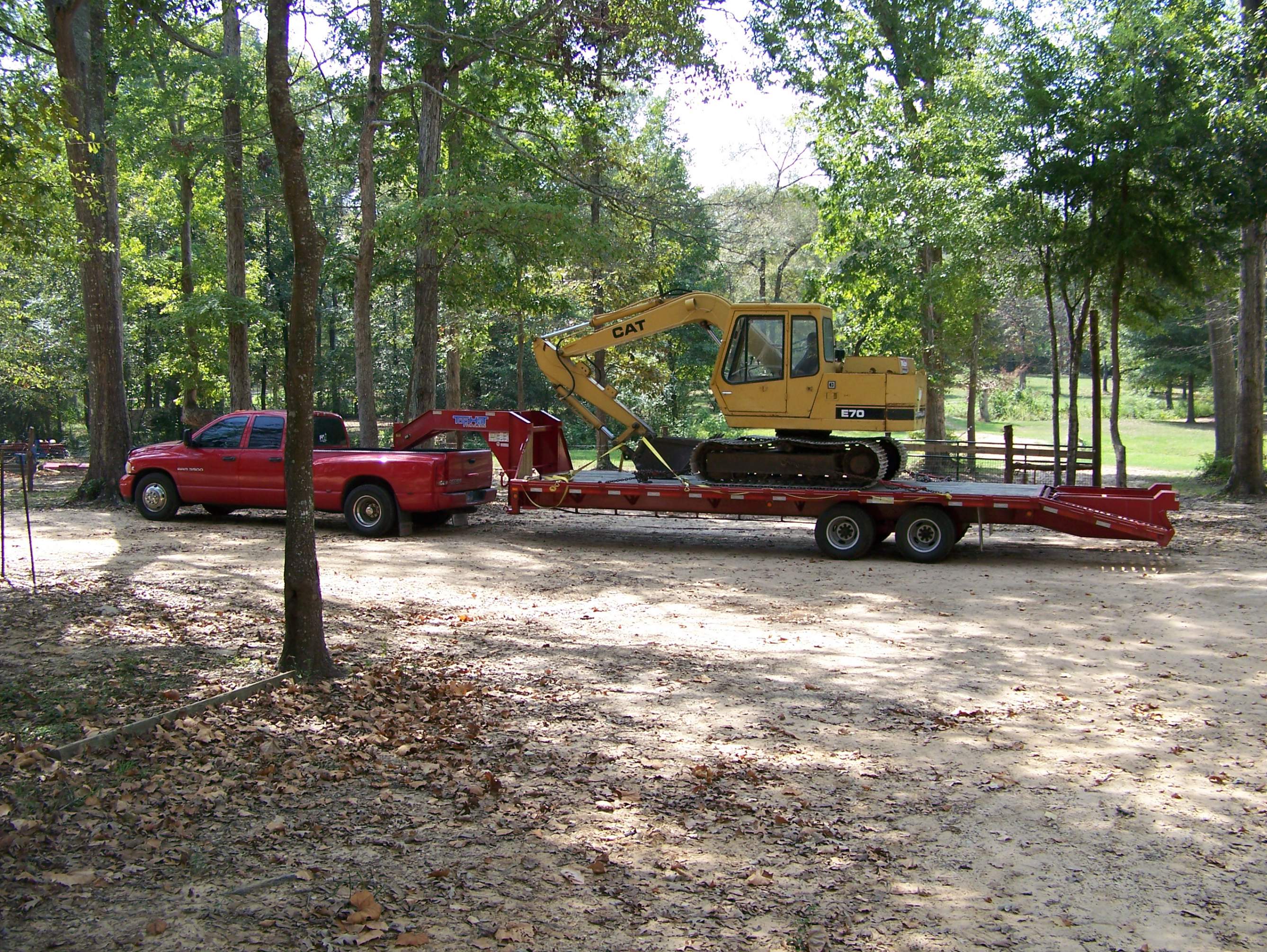

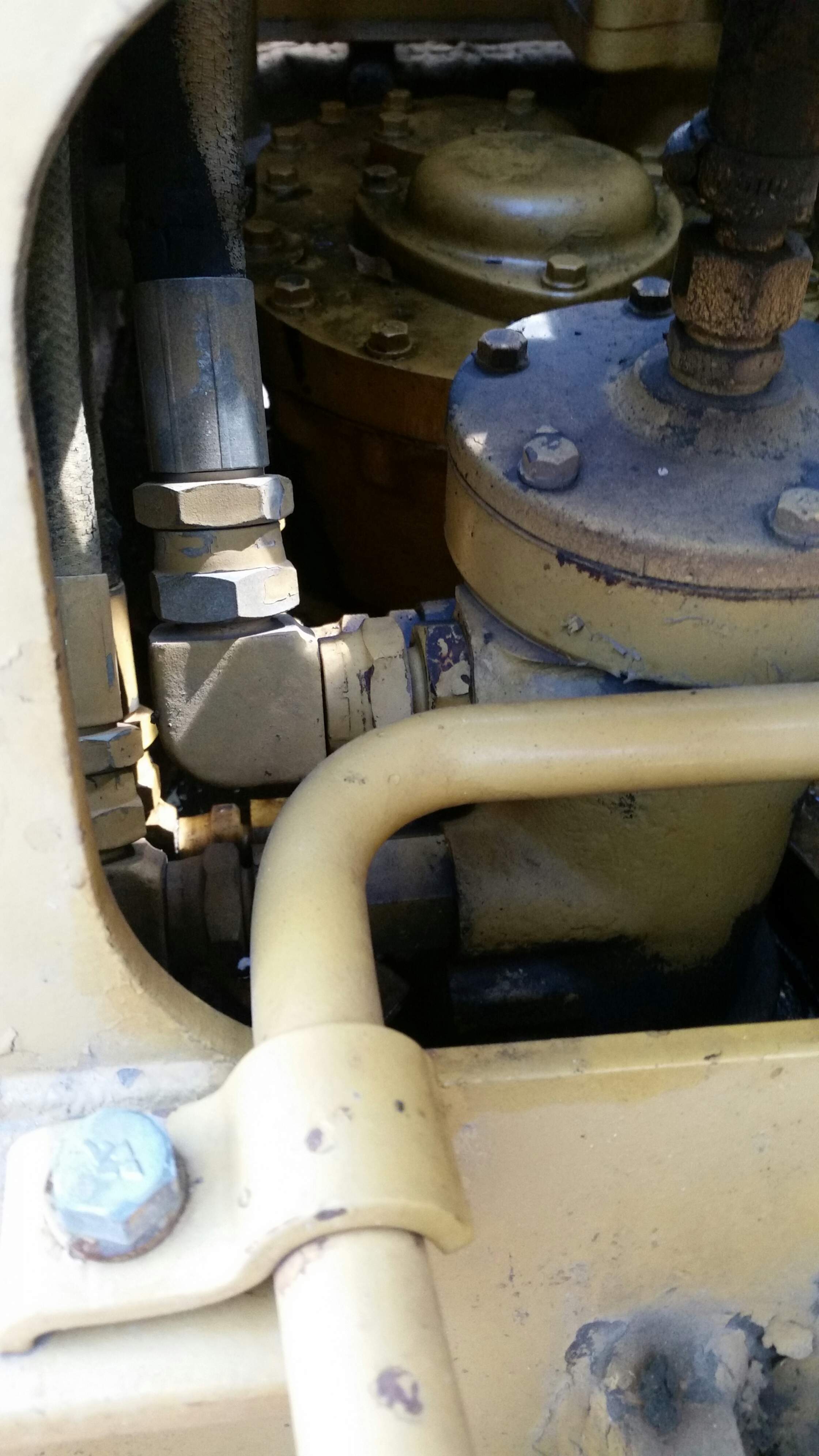

Here is a cell photo of it I took 2 weeks ago. I'll get better digital camera shots of it today. The area I need to remove the broken bolts is just below both pair of angle fittings. This is the only access to work through, unless I remove hard lines that go back behind the cab about 5 feet............to the valve spool.
hygs, Brandi

Guess not many folks here have dealt with a E70B's rotary joint. I decided I had to remove it to get a drill on it, as I only had 4-5 inches of space after removing the 4 hoses to the joint. I removed the hoses and 90 degree fittings and standoffs. I then had enough space to see it had oil and dirt over the holes. I shoved a small pick in the holes to see how deep the broken bolt threads were. In both holes I went in about an inch. I then cleaned out the holes with alcohol and cotton swabs and started trying mm and fractional bolts. I had to run to the auto parts store for some 7mm bolts. The 7mm bolts0 screwed in tight. So..........I don't have to remove the joint.........and that's a good feeling.

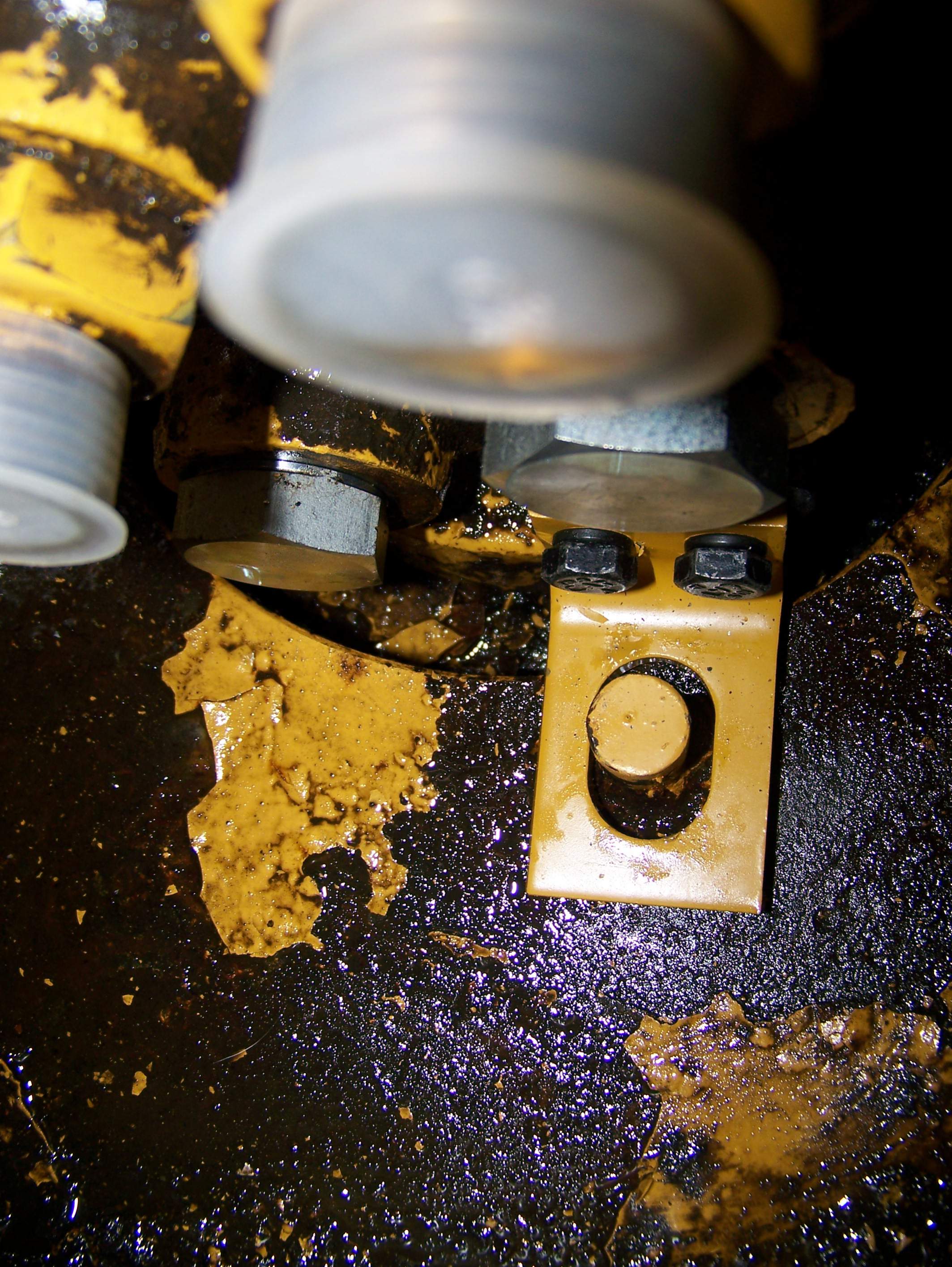

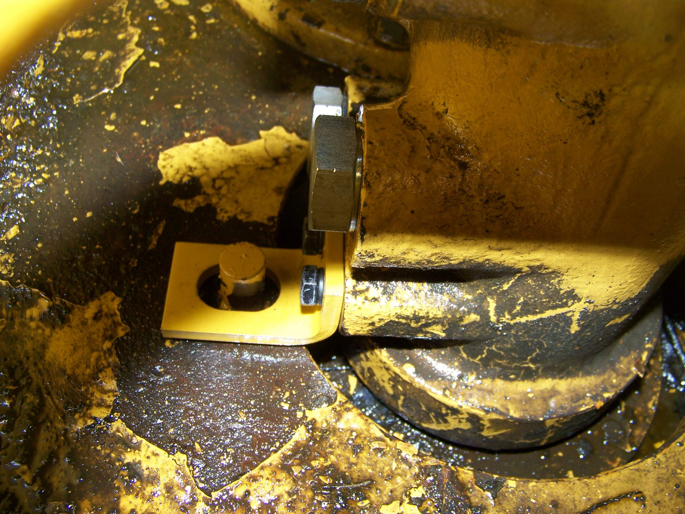

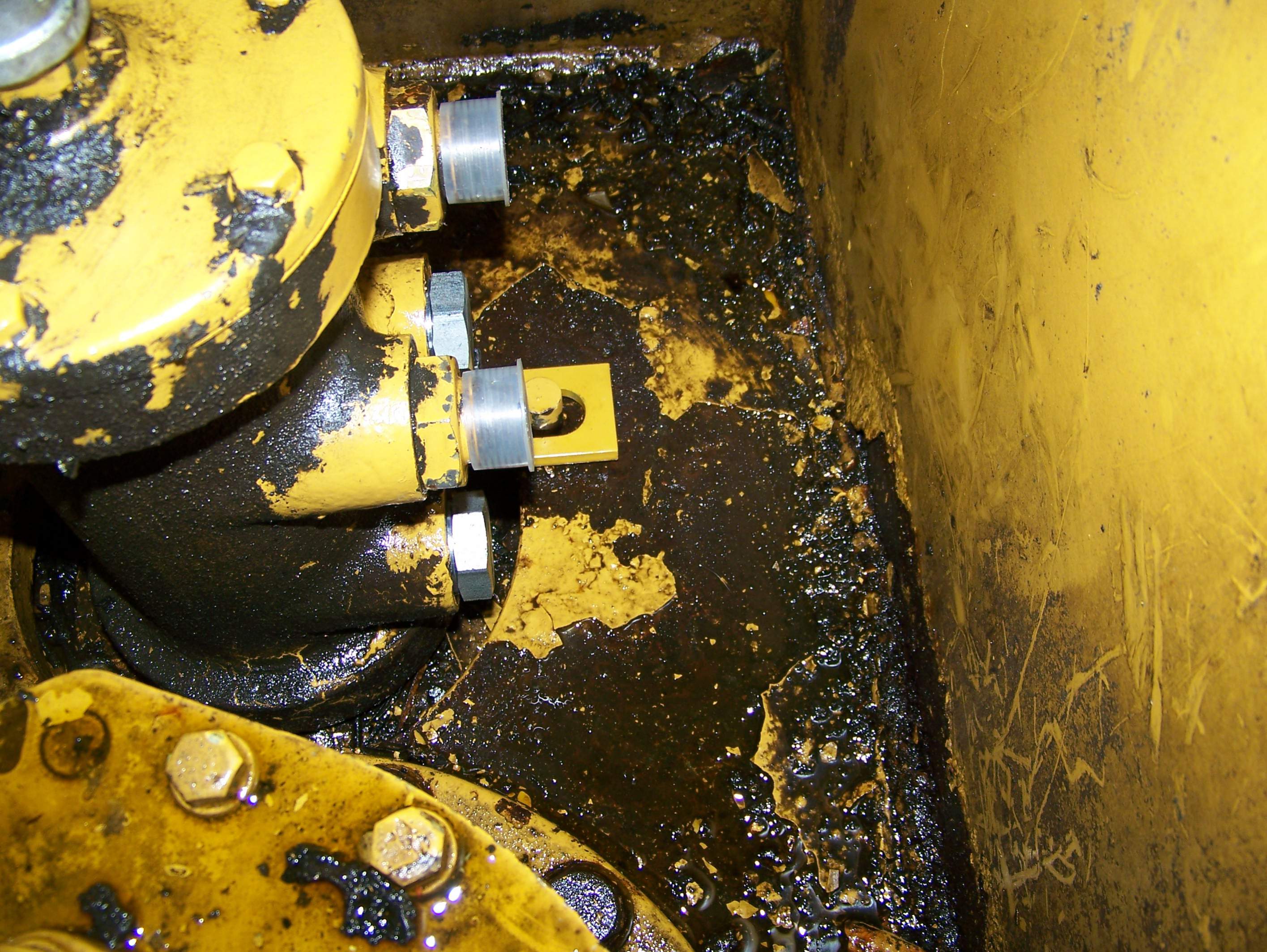

Well, the M7 bolts had me fooled. One tightened up and one spun and spun. So I went to Lowes and bought a cheap 90 degree drill attachment, then an M8-1.25 tap at Northern Tool. My letter H drill bit walked right into the hole while I held the 90 degree attachment and my son, up on the engine deck, triggered the Makita drill. I then fed the tap in with a 1/4 ratchet and the tap went in and just cleaned out the threads on both holes. They were M8 after all. It blows me a way the dirt and oil could hold a M7 bolt tight in an M8 threaded hole.
Anyway, it's all back together now. Later today I'll change the fluid and filters. Cat Rotary Joint  Restraining Bracket.jpgCat Rotary Joint  Restraining Bracket Clearance.jpgCat Rotary Joint  Restraining Bracket 2.jpg
hugs, Brandi
