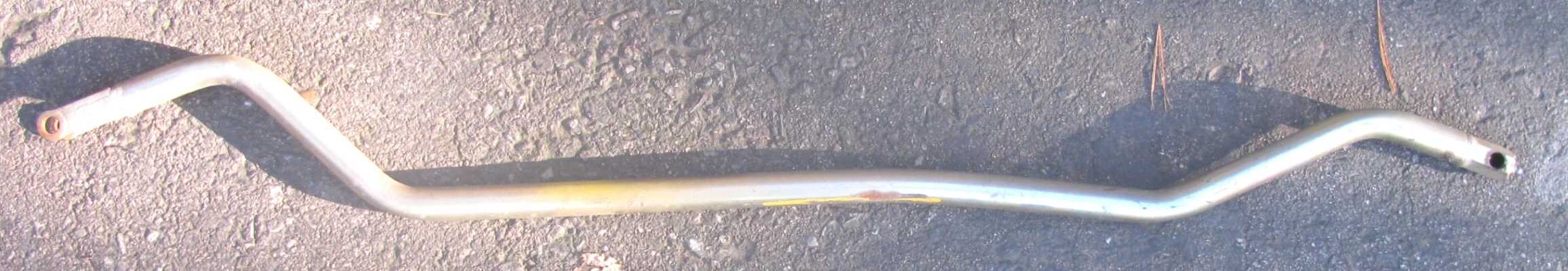

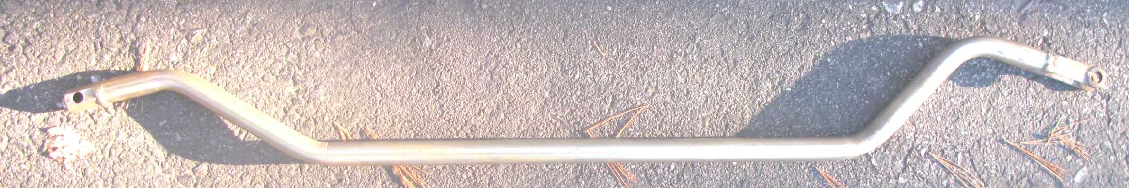

On a side note...when I received the machine, I noticed that the lower anti-spill over link appeared bent and was rubbing on the loader boom cross tube. After reviewing images of other machines, it appeared that I was correct. In fact, there was a corresponding ding on the lower surface of the loader boom. They must have caught something dumping and/or backing out. I've since straightened that. See attached images.

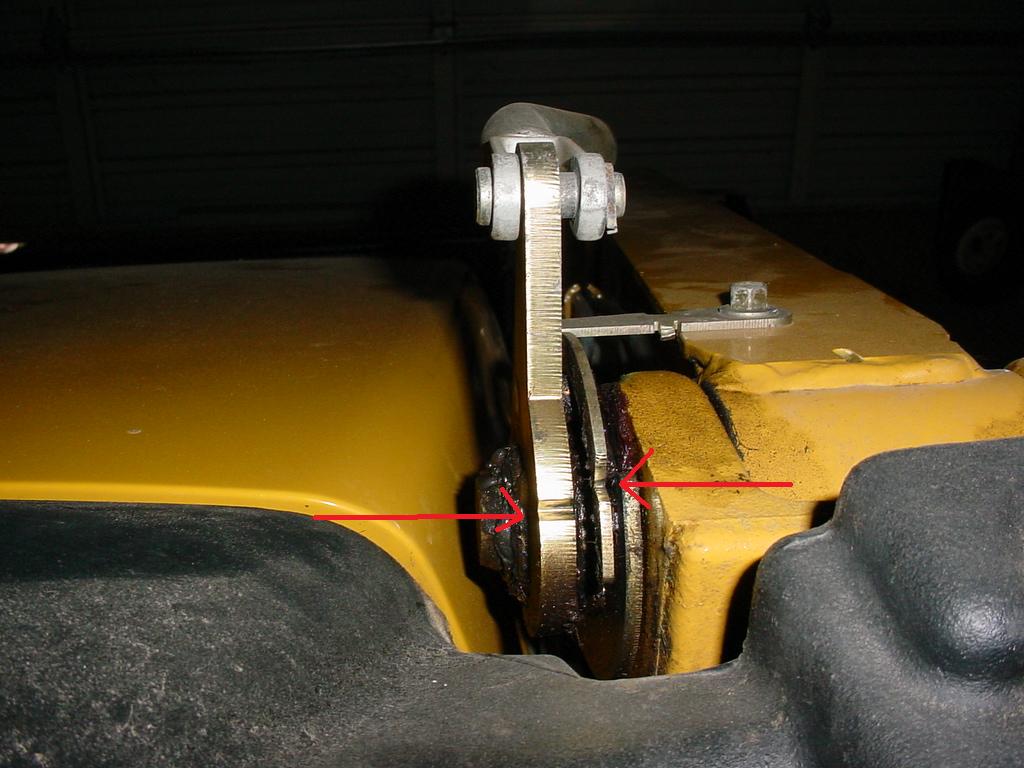

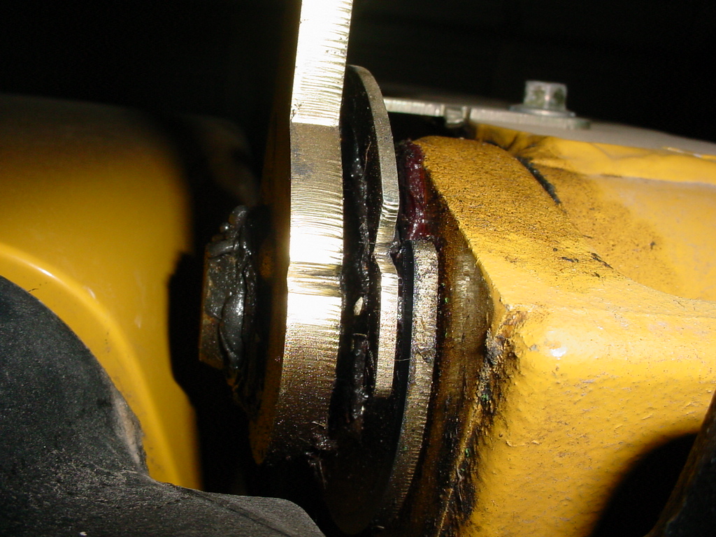

On the right hand side, when sitting in the seat, there should be a silver/gold rid that runs up the inside of the loader arm, this has a tab on it that runs alongside an indicator that is bolted to the top of the loader tower near where the right side loader arm is pinned on. It may be hard to see with the cab on, but it should be there. It's nothing fancy, a simple mechanical setup so you visually know when the cutting edge is parallel with the ground.
When the two grooves are aligned that indicates the cutting edge is parallel with the ground (see arrows on photo)
The photos indicate the cutting edge is NOT parallel with the ground,
Thanks for the pics to assist my poor explanation....I couldn't find any pics online of it anywhere.....

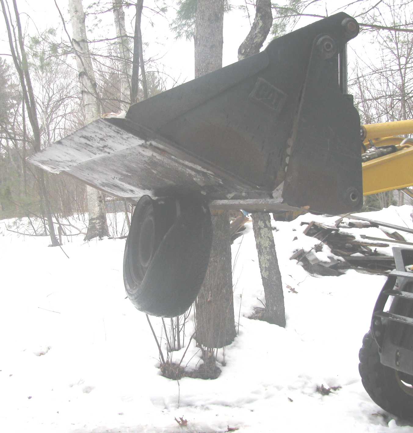

I also used the multipurpose bucket to break the bead down on a truck rim and tire. I opened the clamshell to just clear the tire, drop it in to just past the rim and hit the B button on the remote. It broke the bead effortlessly. Clamping force seems quite good. In the next few weeks, I'm having several large trees harvested by crane. I'm looking forward to grabbling them with the bucket and bucking up the wood in the bucket or backhoe with thumb to cut into fireplace length.

I also used the multipurpose bucket to break the bead down on a truck rim and tire. I opened the clamshell to just clear the tire, drop it in to just past the rim and hit the B button on the remote. It broke the bead effortlessly. Clamping force seems quite good.QUOTE]
