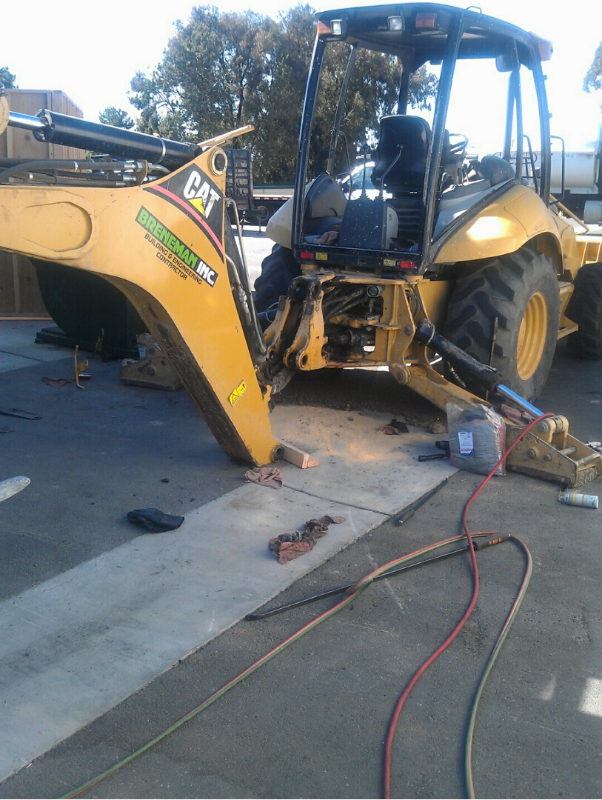

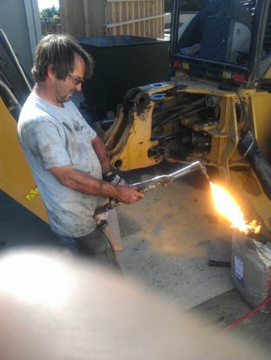

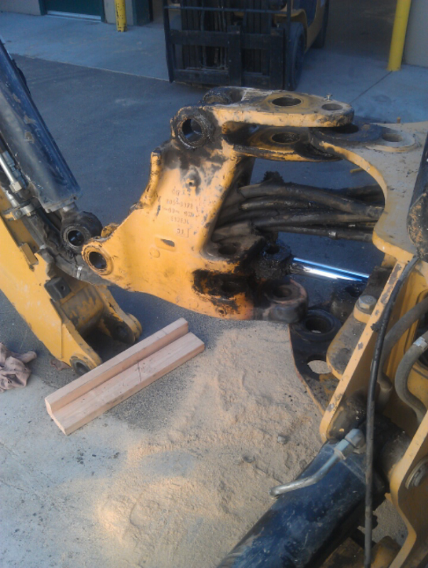

Jun 22, 2013 / Cat 416E #1 brain55 Veteran Member Joined Jan 19, 2008 Messages 1,767 Location Brentwood, CA Trying to take more pictures of jobs that I do. Here I am doing the boom pins and bushings on a Cat TLB yesterday. Not too bad of a job. Using dry ice to shrink the bushings makes driving the new bushings in so much easier. Attachments ForumRunner_20130622_052304.png 682 KB · Views: 214 Camera_IMG_20130621_170618.jpg 153.6 KB · Views: 202

Jun 23, 2013 / Cat 416E #3 B Bob Rooks Elite Member Joined Feb 27, 2007 Messages 3,897 Location Washington state Tractor Yuchai Dozer (sold). I'm thinking that dry ice would also be handy to wrap those hoses in when you put the heat to the bushing bosses. Nice work. :thumbsup:
Jun 23, 2013 / Cat 416E Thread Starter #4 OP brain55 Veteran Member Joined Jan 19, 2008 Messages 1,767 Location Brentwood, CA Bob Rooks said: I'm thinking that dry ice would also be handy to wrap those hoses in when you put the heat to the bushing bosses. Nice work. :thumbsup: Click to expand... That's what I used the piece of 1/2" stainless plate I have for. It makes a great shield. Brian
