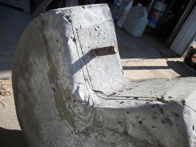

while I'm waiting to get my ps on my 4600 fixed I'm going to address a light front end problem.
from previous load / unloading I can tell the front end gets light with that heavy 6' mower lifted, and while loading onto my deckover gooseneck... had the front end come up while laoding 2 times and had to steer with brakes. not fun when on ramps
checked the price of NH weights.. about 2.50$ per pound.. that's way crazy.
found barbell weights for about 88 cents a pound.. but that's still high.. can't find any heaper at yard sales.. etc.
so I am going to concrete cast some 3/4 round weights.. saw about 4" thick, and basically a circle with a 90- cut out..I'll cast in a carriage bolt into the concrete on one of the inner flats and then drill a coresponding hole on the HD 4" angle iron bumper. figure I will hang either 2 or 4 of them.. bumper has plenty of room, and there will be plenty of ground clearance. I'm using the bottom of an old animal waterer tub for the mould.. it's 4" deep and? 18 " diameter as I recall. I'll use 0 gauge wire left over from fencing to run in the oncrete. 15$ of concrete will make more than 4 weights. I'll probably load my front tires too.. I still have a gallon of non toxic rv antifreeze left over from loading some rears,, i'll stick 1/2 gallon in each front to keep it from freezing then fill the rest with water.. that should add some weight as well.

the front weights I'm making ( cast 1 this am ) have carriage bolt studs embeded so they will be easy to remove.
figure i will make 2-4 of them and see what that does for my front rising up when loading.

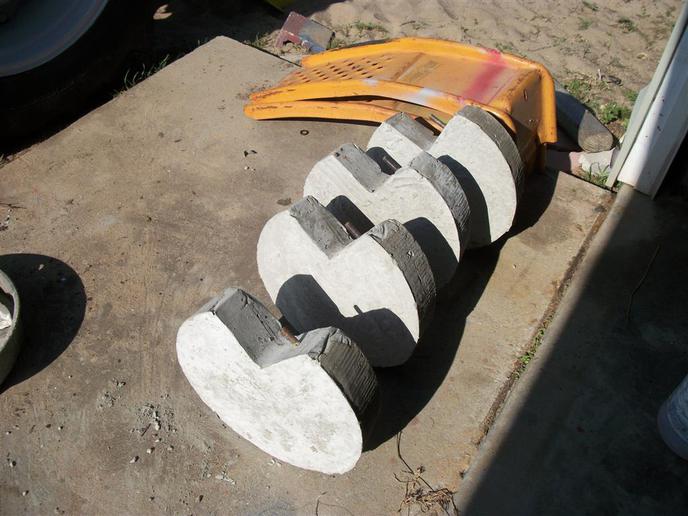

got one done, and another poured.. plus made a couple tarp corner holders.gonna make 4 bumper hangers.
soundguy
That's what i had pictured from your description! I hope your going to paint them Yellow with a face:) like that the old natindo game!:laughing::laughing::laughing:

#16
probably just gloss black to match the bumper.. :)

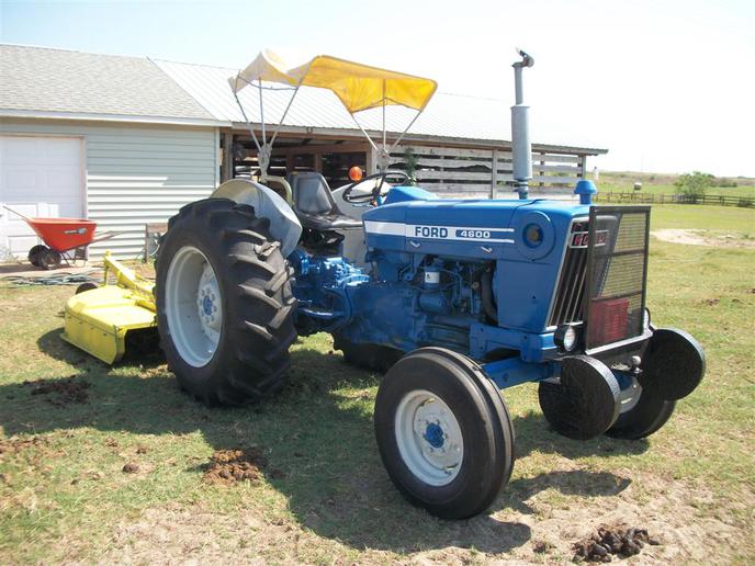

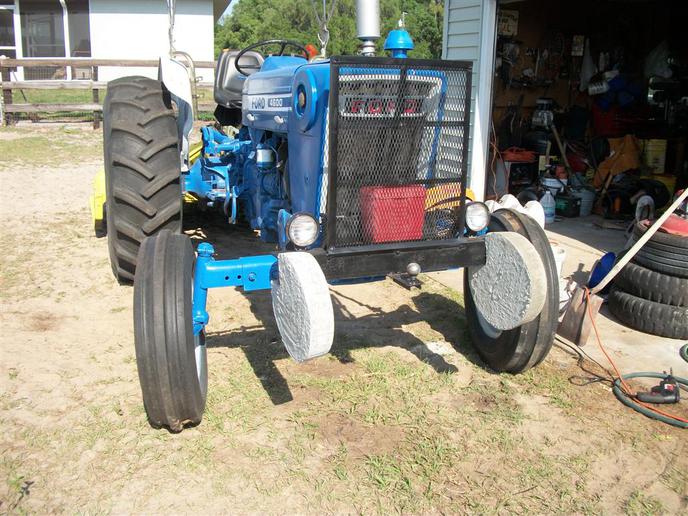

update.
got the weight done and hung

   / casting weights #18
Maybe there not that heavy, but as an after thought, (since you all ready cast them),
if one would have had a loop of rod out the top of them one could use a engine hoist to hang them to hook them up, (just may save some toes),
looks good

#19
hoist wouldn't work to well on my grass / dirt floor :)
I don't plan on removing them alot. they are on there to keep the front end planted. in any event, a floor jack will work, or lifting by the mount stud.. etc.
however.. if I make more, I may add alternate mounting points so they can bumper mount to thru-rods flat stacked.. etc.. would not hurt to add a chain handle to the top of each one using scrap proof coil. would add some extra weight too.. so I'l save your idea for the next batch I pour :)
