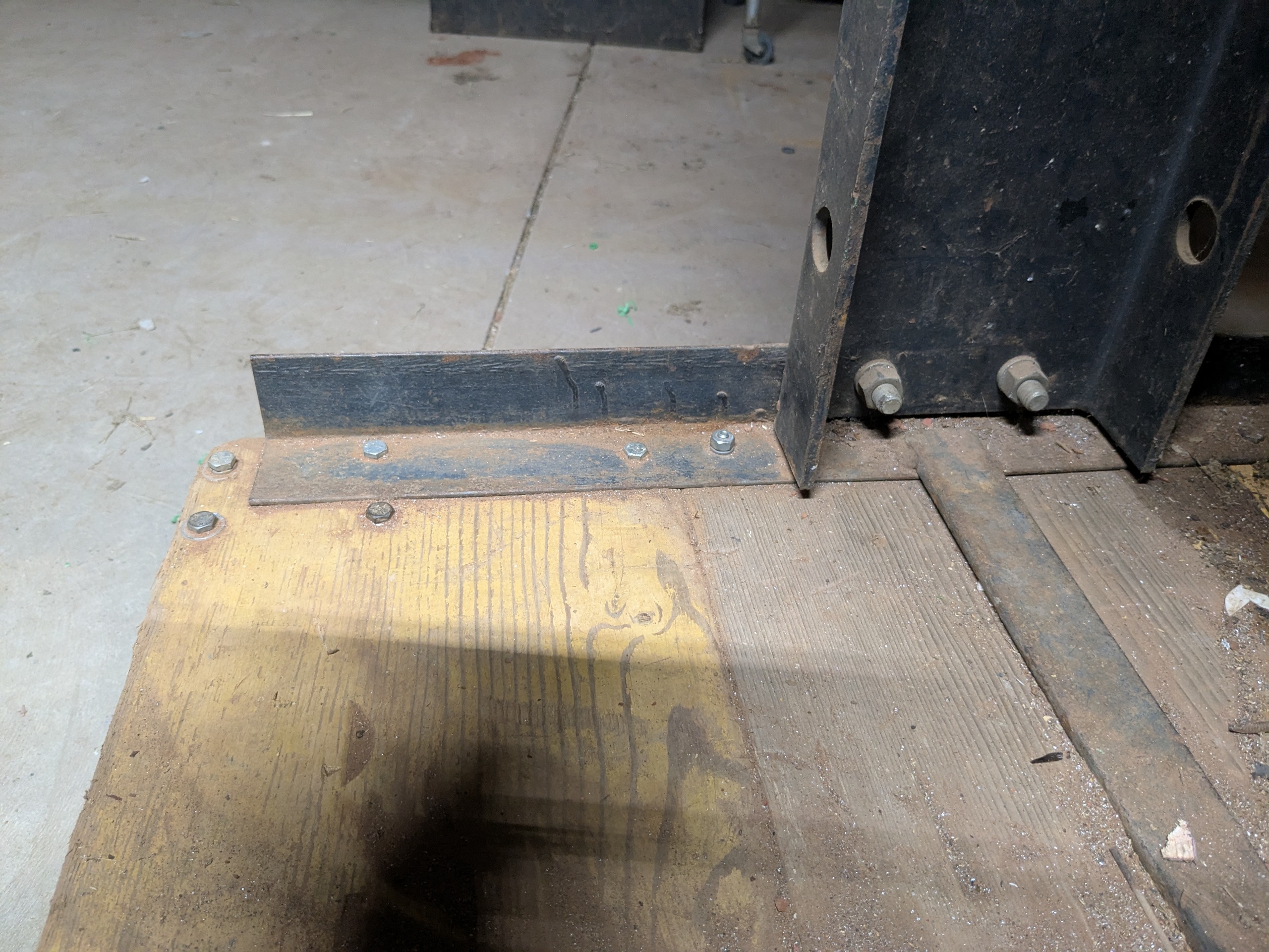

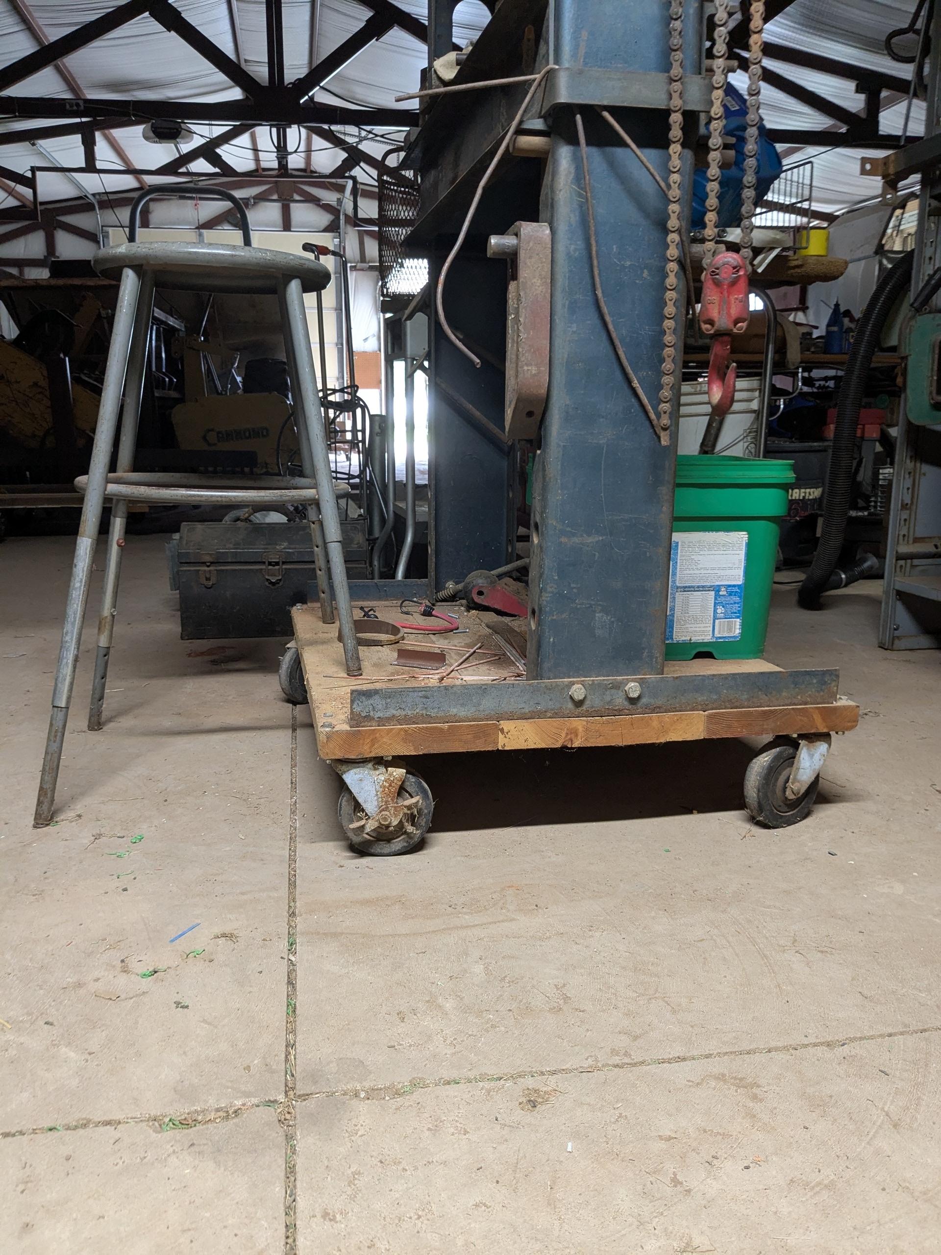

I used 3, 2x12's, with 6" casters. The best thing about it is now when I drop a heavy piece of metal, it lands on the wood, instead of chipping out a chunk of the floor.
Xfaxman, Did you mean 3 (2x12's) so you've got 36" across the bottom? I can't really see from the picture.
It makes good sense though to have a wide base to avoid any tipping issues.
How many 6" casters did you end up using then? 4, 6, or 8?
I've got a Harbor Freight press that I have never assembled yet; and your picture gives me a good idea of what I'd like to have. Thanks, Greg

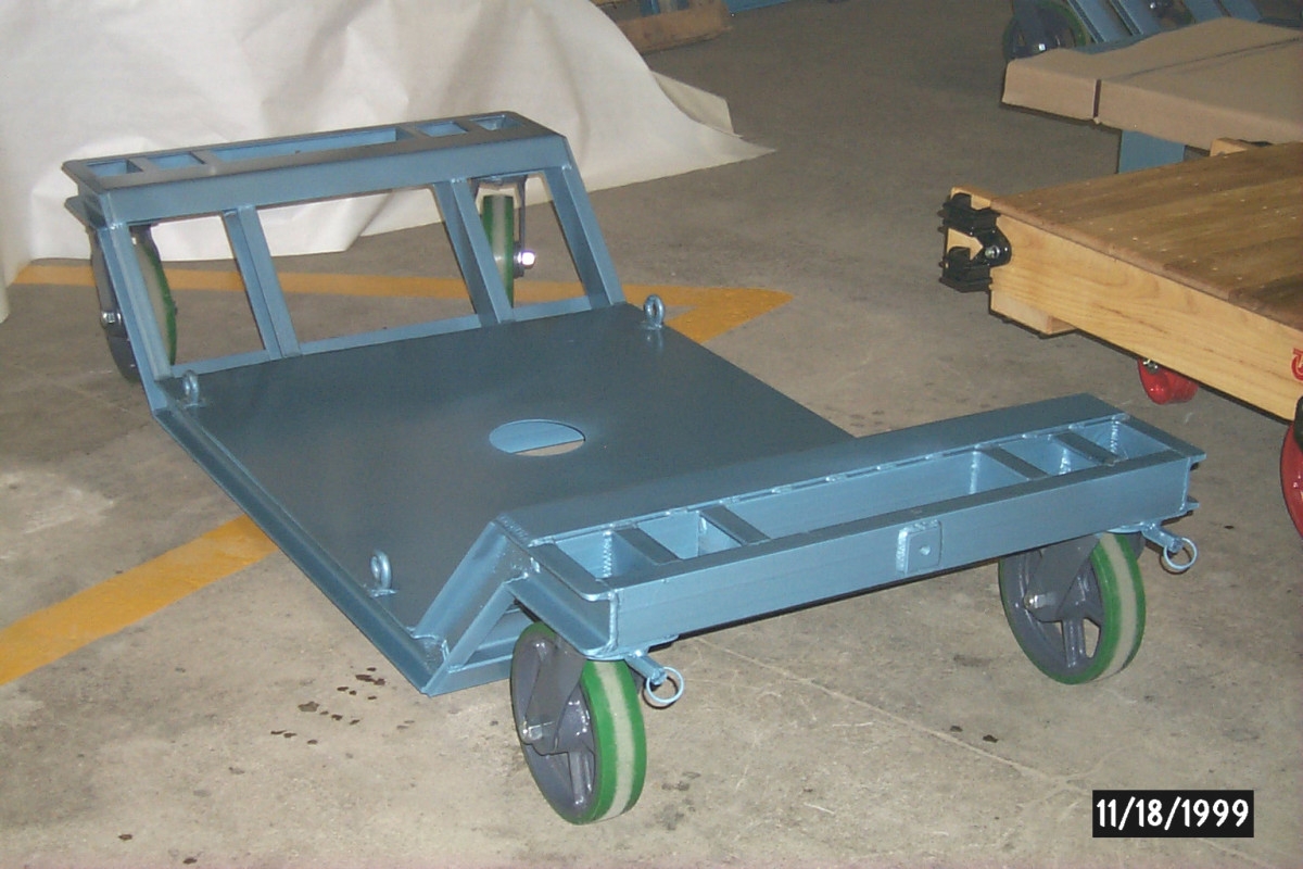

I love putting things on casters, but I don't like the added height of them so I usually build the dolly like a lowboy trailer, where the deck that is supporting the load is as low as possible and the wheels are outside of the footprint of the unit I am putting casters on. Because the wheels are outside of the footprint, it makes it more stable, and by lowering the unit in the middle, it makes it a lot more stable.
Most of the time, there is no need to have the empty space underneath the item that we are setting on the dolly. Building one requires it to be made of metal, not wood, or at least I have never seen one made of wood.
Went out to the shop to take pictures and it looks like my memory failed me. There is one 2x12 and two 2x10's totaling 29 1/2 inches.
4, one at each corner.

Better view of the base:
Thanks Xfaxman, I now see it far much clearer and understand it all. I also read what the next poster said and I see his point also, but it would only lower everything by an inch or so anyhow - and I bet the wood muffles sounds of metal falling to the floor by a lot!!
