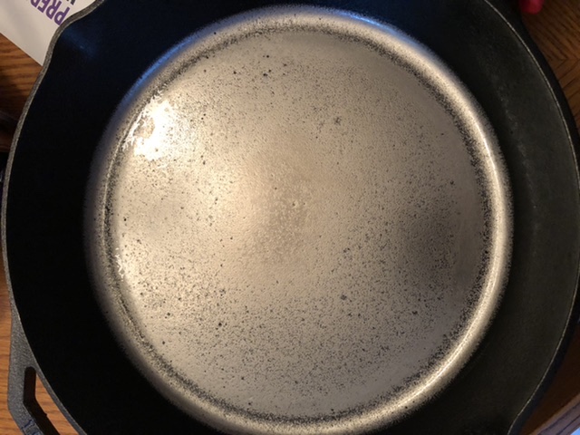

44AD52F6-BEAE-490A-B655-186F42D7E6D5.jpegI've worked on a new Lodge with a Festool ETS. Started with 60grit and worked down to 180. Going to season it in sometime soon and see how it goes. Much smoother than original now, although I am not sure I could get rid of all the air pockets.

Looks great
I have been using flaxseed oil but I heard that grapeseed oil is the best. Once I use up the last of the flaxseed I will switch and try it

View attachment 663167I've worked on a new Lodge with a Festool ETS. Started with 60grit and worked down to 180. Going to season it in sometime soon and see how it goes. Much smoother than original now, although I am not sure I could get rid of all the air pockets.
I would not go any further. If you make it too smooth, the seasoning will have a hard time sticking. Did that once, never again.
If I smooth any cast iron now (mostly I don't), I take it down to what I call a "50% shine", i.e. only about 50% of the surface has been sanded. this knocks all the high spots down leaving a pretty good surface, but still enough for the seasoning to stick.

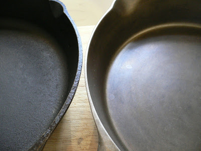

/ Cast Iron #27
New Lodge on left old Griswold on right. The smooth Gris takes seasoning just fine
/ Cast Iron #28
I was under the impression that cast iron would absorb the oil into it's "pores" and even if you sanded it and removed some of the pores, you would open new ones. ?? I have very little experience with cast iron other than having a couple of skillets.
/ Cast Iron #29
Thanks all for the advice! I'll not sand anymore until I season and test anyway. Although not as smooth as well used older skillets, it may be smooth enough.
