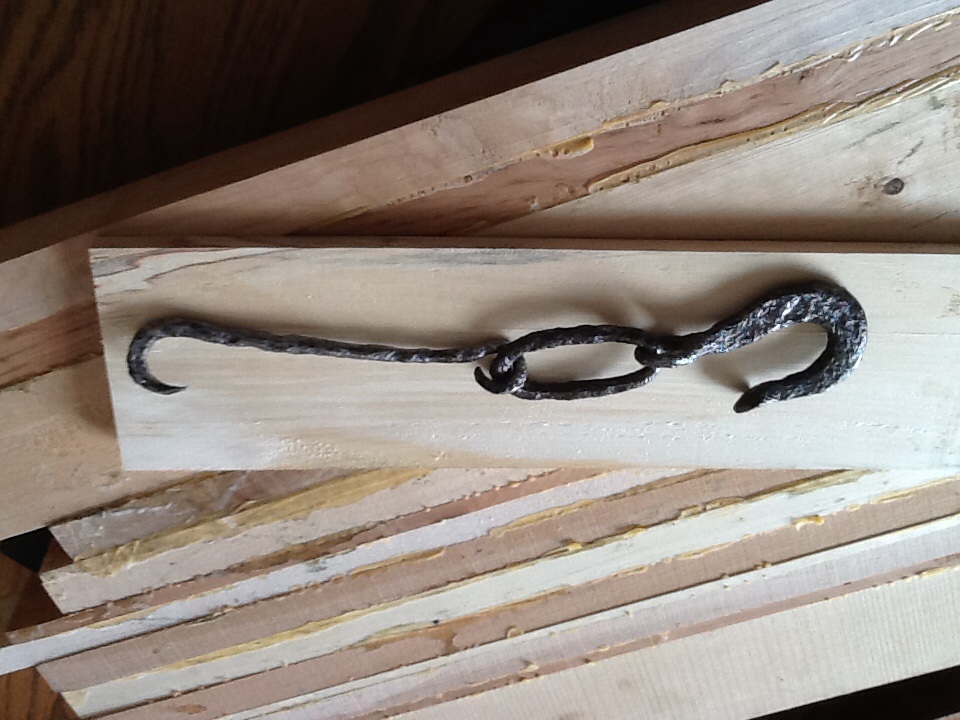

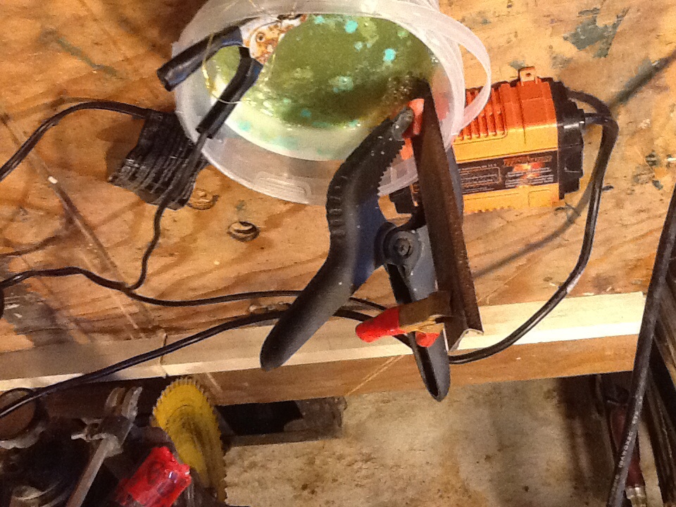

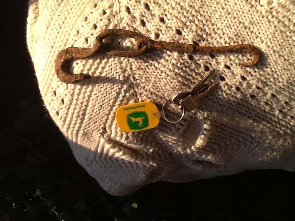

Electrolysis: cleaned up a rusted up old hook pictures.
Hook submerged in bucket
Hook before and after
Note: if the copper positive clip gets under water it will dissaperances.

One thing to mention about electrolysis, DO NOT DO IT INDOORS ! You can do it under cover, but with very good ventilation. The gases are explosive and could be toxic, depending on what was on the cast iron. Do it outside. Please read the attached link for other safety precautions. Washing soda is the best thing to use.
Electrolytic Rust Removal
