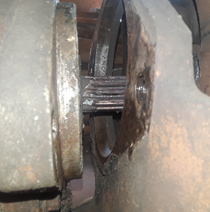

Welp...had a little daylight to look at it. Hydraulic pump looks to be the issue. I was able to shine with a flashlight and see the splines were torqued and flaking. I pulled the pump partially out and the engine turned over just fine. I left the pump hooked up to the hoses until my new one arrives. I could not turn the pump by hand...but it was tough getting anything on the shaft to even try to spin it. Hopefully the pump internals just locked up and there's nothing else that caused it. Guess I won't know until I take it out. The only thing I worry is that if there was some valve that failed that caused it to lock up. One thing that seemed odd to me was that the outriggers were holding the backhoe up. I used the levers and it did not let the machine down. I had to crack a line at each cylinder and lift them with a come-a-long and let them bleed the pressure. I needed to pull the machine to higher ground with potential rain coming.
Hopefully it's nothing, just thought it was wierd the outrigger levers wouldn't let the machine down. In the back of my mind I wonder if something didn't plug or fail (other than the pump) to cause the issue. Either way I think a new pump is needed....just hoping it doesn't lock up with pressure soon as the new one is on.

Good to here it's the pump that went haywire. Don't be concerned about the stabilizers they operate when the motors running and you have a pump that works.
   / Case 580C backhoe died while running. Now starter cant turn engine over. Locked up? #6

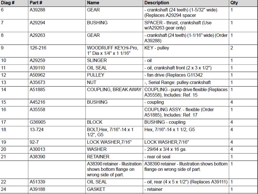

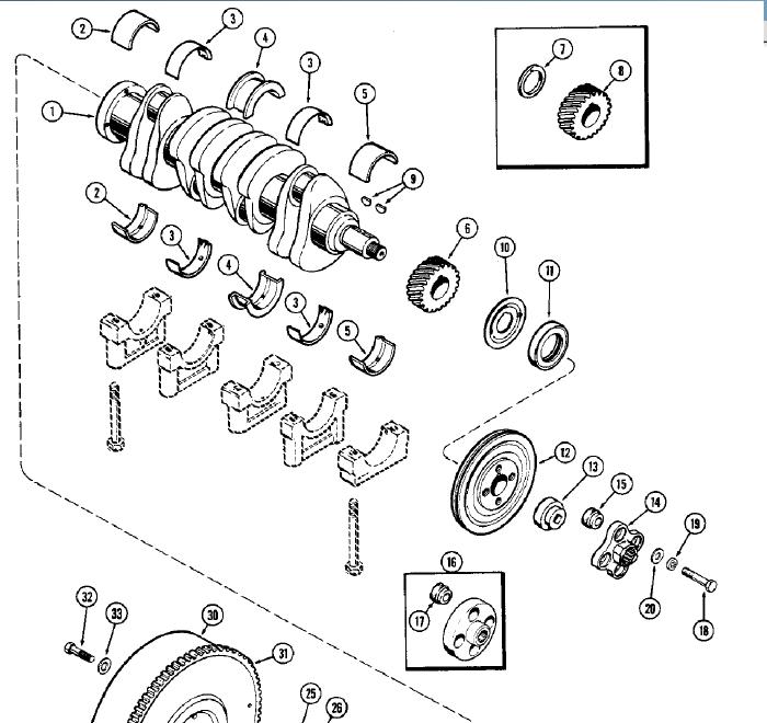

IIRC, there's an "adapter" that mounts to the front pulley on the engine that should ALSO get replaced from the look of that spline -
And Bill's right about the stabilizers - reason is they both have check valves in their circuits that require pump pressure on the OPPOSITE port in order to retract. On my 580B tho, they will EXTEND til they touch the ground when I move the control lever to "down" position, even with motor OFF.
In fact, I KNOW my control valves haven't been touched since I've owned it (about 14 years) - the cylinders HAVE, (but NOT the check valves) and I can STILL set mine off the ground front and rear and come back a week later and it won't have moved.
BTW, just noticed your post count - welcome to TBN... Steve

Here's what I'm talking about on your pump drive; see Item# 14 on diagram, also these are original part#'s so there's probably updated numbers - but check with these guys
Equipment Parts Source, Aftermarket, Case, Backhoe, Crawler, Loader, Dozer, Tractor Search results for: 'a51885'
You might also need 4 of the bushings if they're bad (Item#15 on drawing) but EPS doesn't have 'em - yours might only need a cleanup, but I would look deeper before you order.
