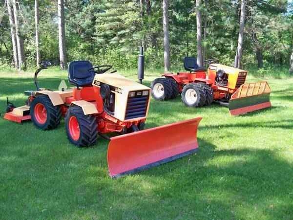

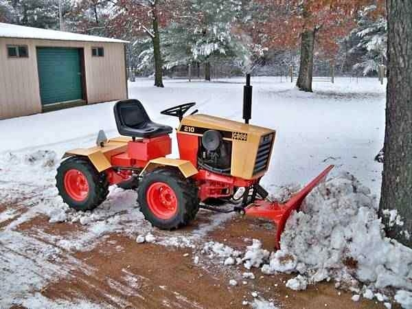

Found on WI facebook market. Is this something case made or home project?
Listing for my dad. Please call with questions. 715 three two five 2810. Case 4x4 garden tractor, runs great, 54 inch snow-dirt blade, hydraulic steering, lift and drive, with hi low rear ends, mower with electric start, pictured in the new Jensales calendar asking 6800 obo

Back in the early 1970s, Case made an unusual garden tractor in that it had a gas Kohler engine driving a hydraulic pump that ran the tractor. Because of the hydraulic drive, it was easier to DIY convert into articulating 4x4 tractors than trying to convert an all gear drive garden tractor to 4x4.

They are home-built. Do a google search for "case articulated garden tractor" and you'll see a bunch of them. Pretty neat.

Looks like a pre-PowerTrac Power Trac.
6800 seems a bit steep for something that small which you almost certainly can't get parts for. Parts will need to be universal or custom. It's certainly neat though
