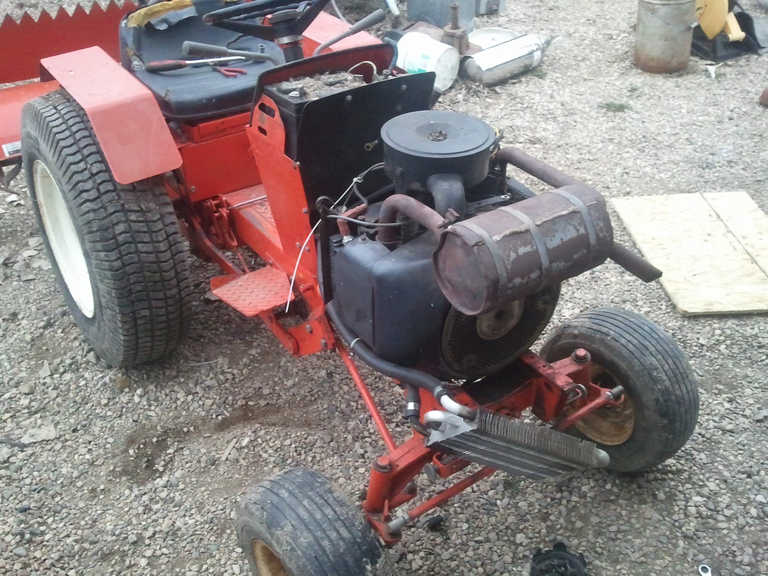

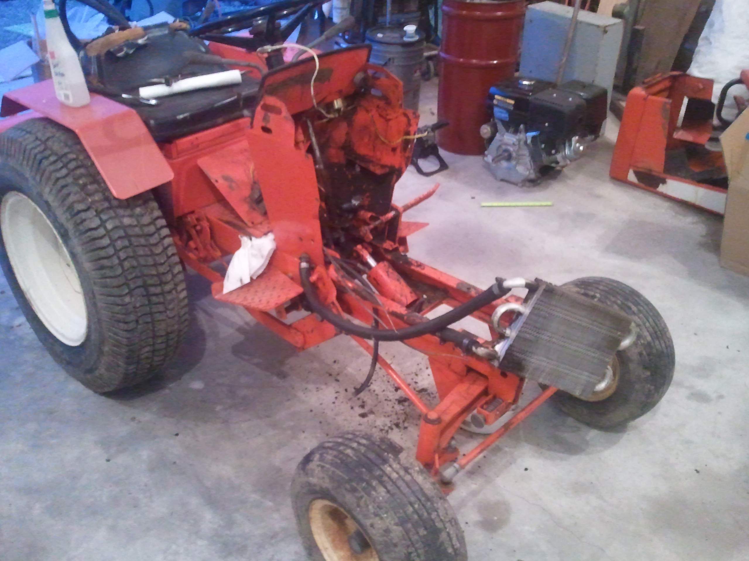

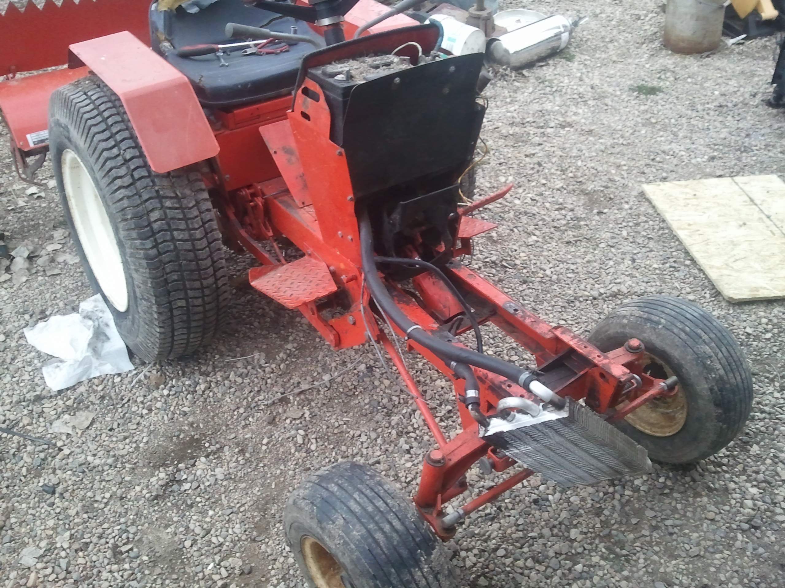

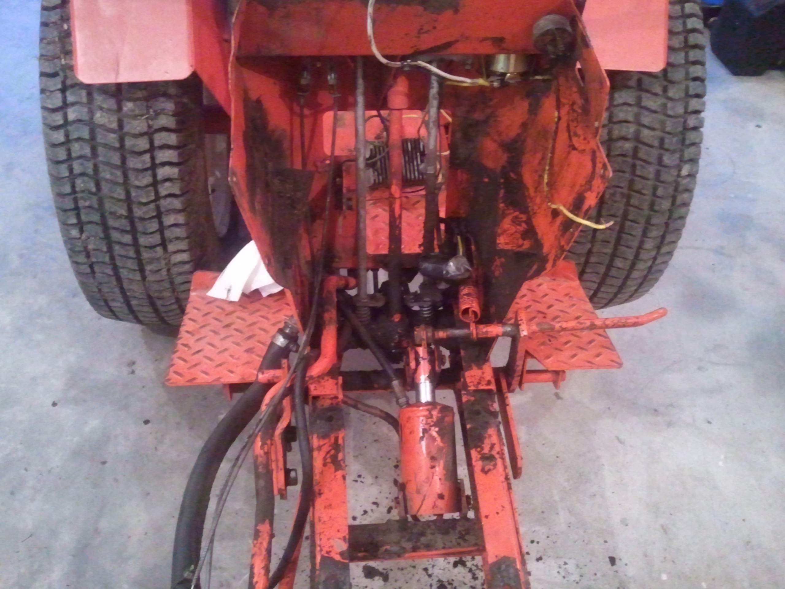

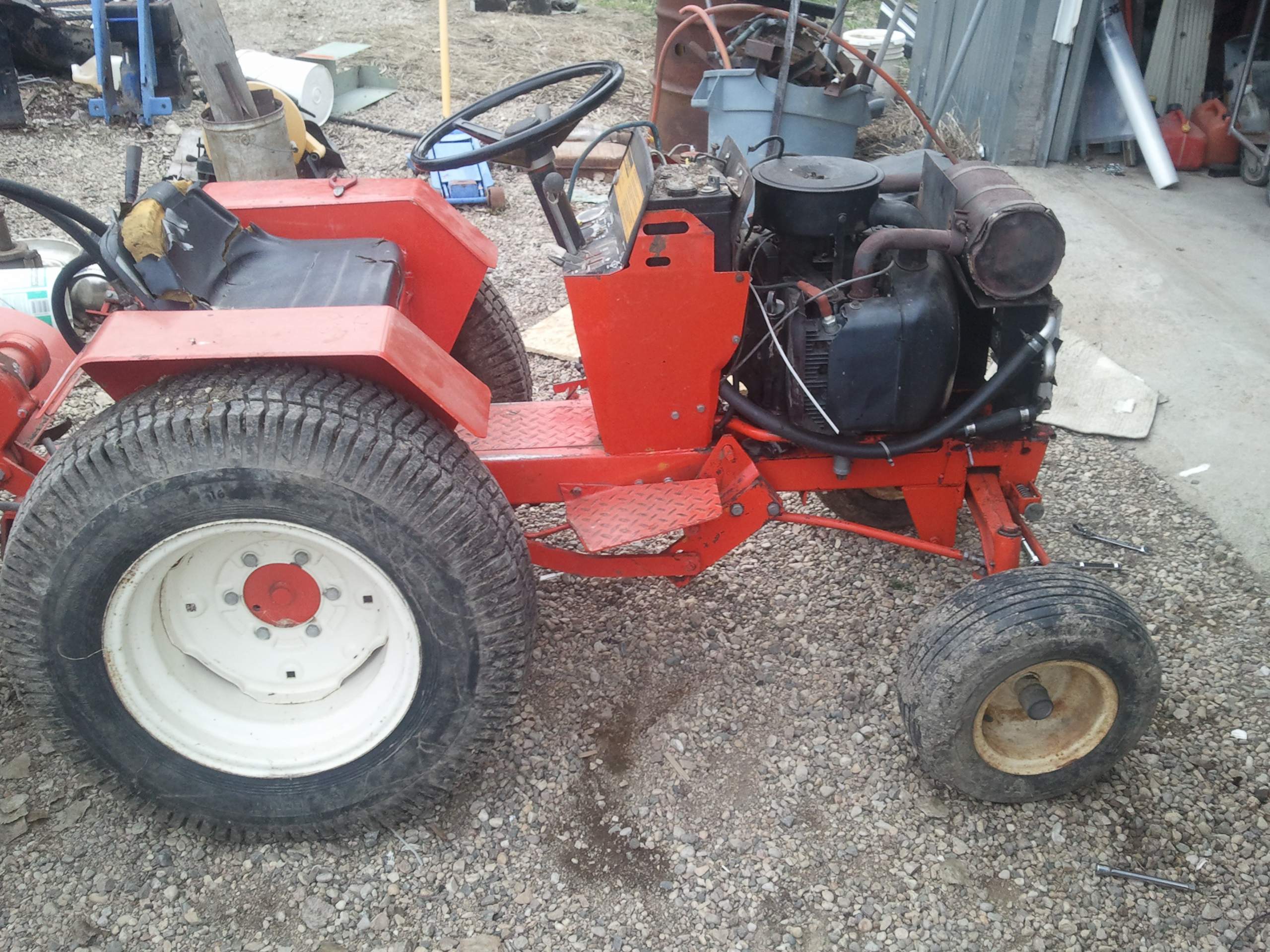

I picked up a 446 with a blown up front clutch and the tiller for a good price, but the engine was hurting. I used it for the season, limping it along, but this spring something had to be done.
I had a 15 horse "princess auto" engine sitting in the garage for another project, but the engine wasnt right for the other project, so the repower was born.
My son and I pulled the tins and the old engine in an evening. A little elbow grease cleaned things up enough to make it nicer to work around, then the following saturday I put it back together.

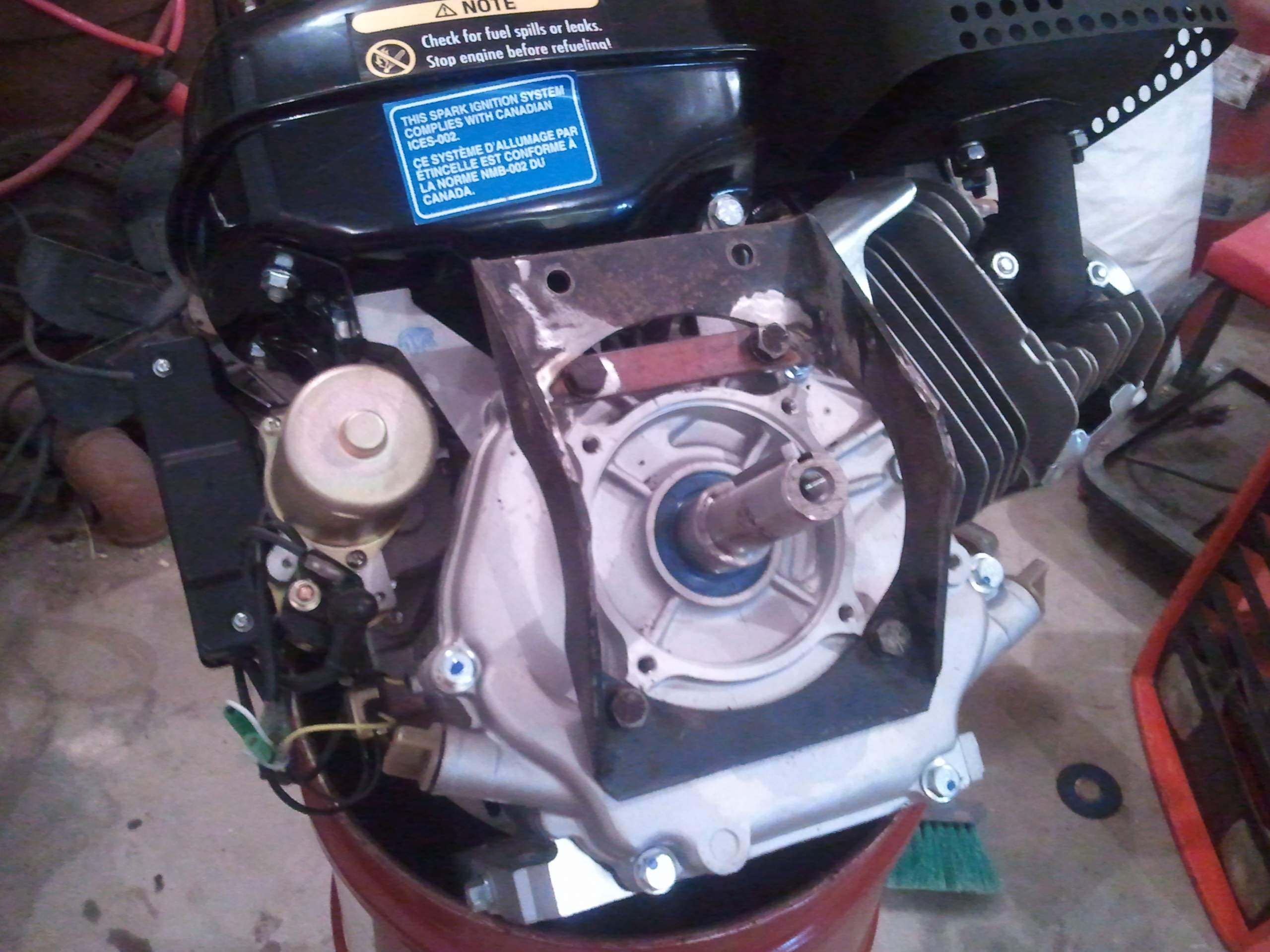

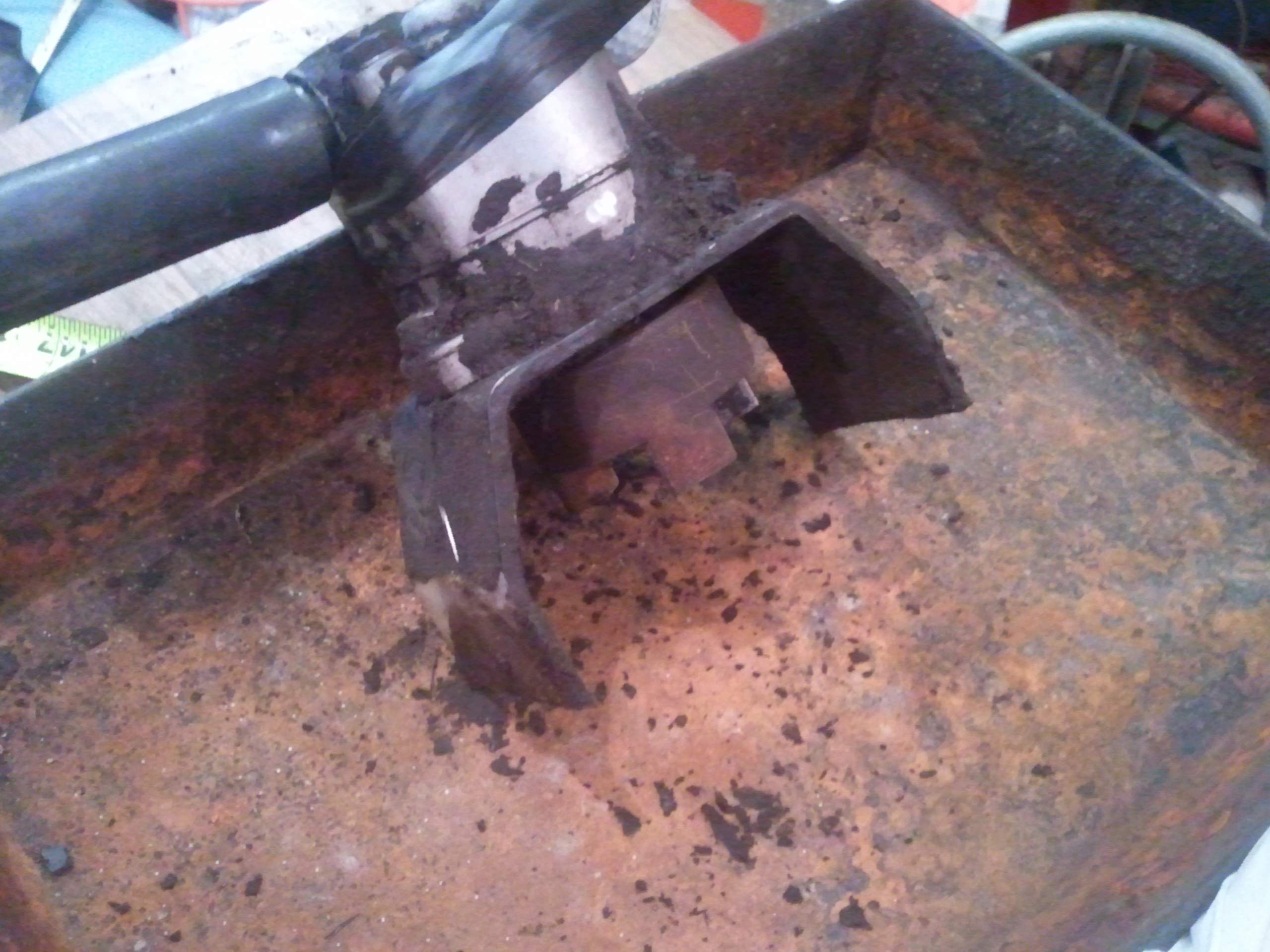

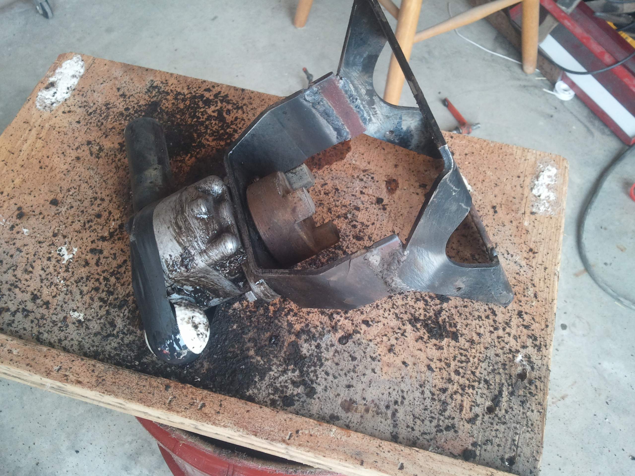

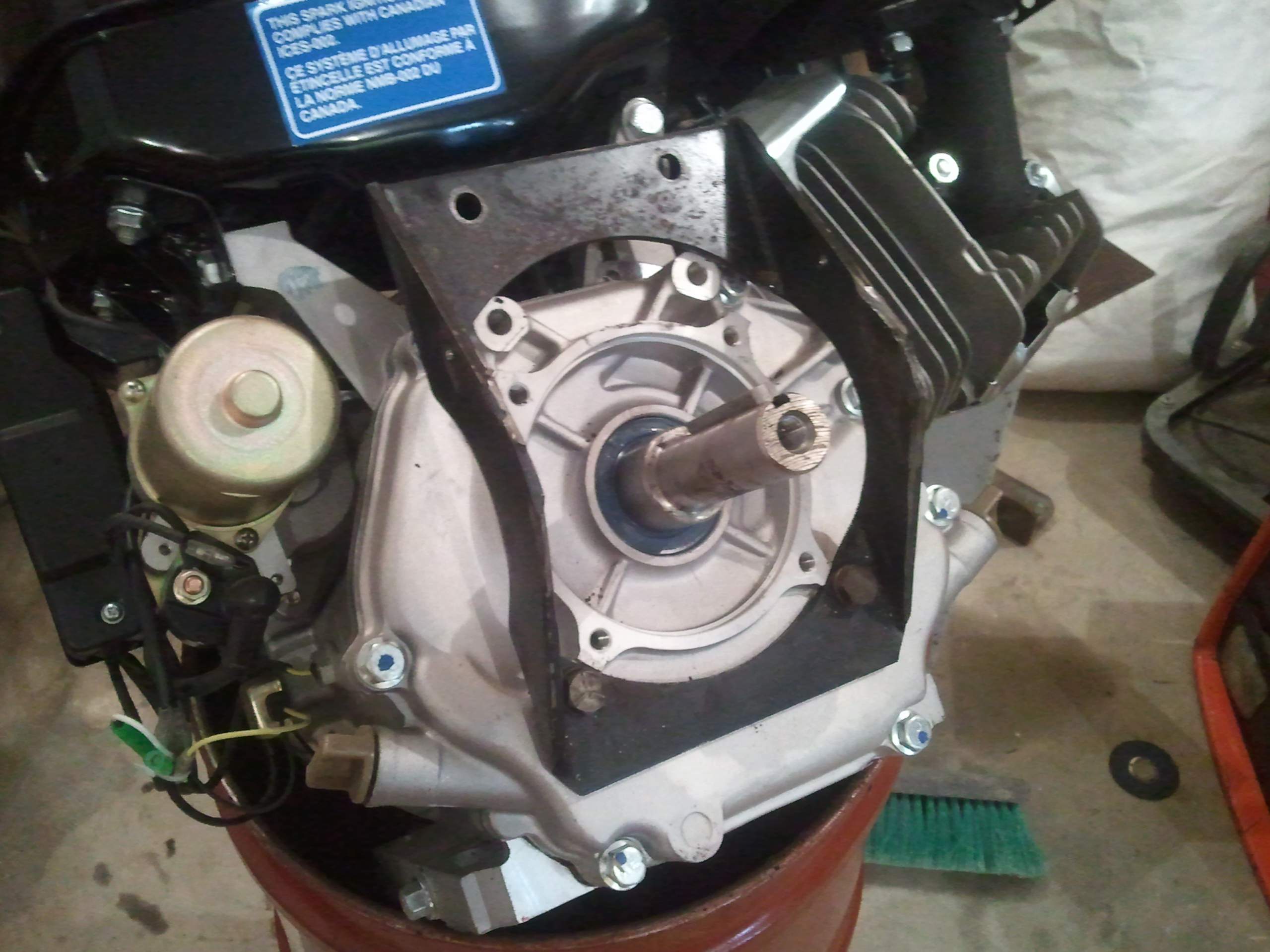

With the teardown complete, I had to re-fab the pump bracket. I didnt want to monkey around trying to pull the love joy from the pump, so it got moded to fit.

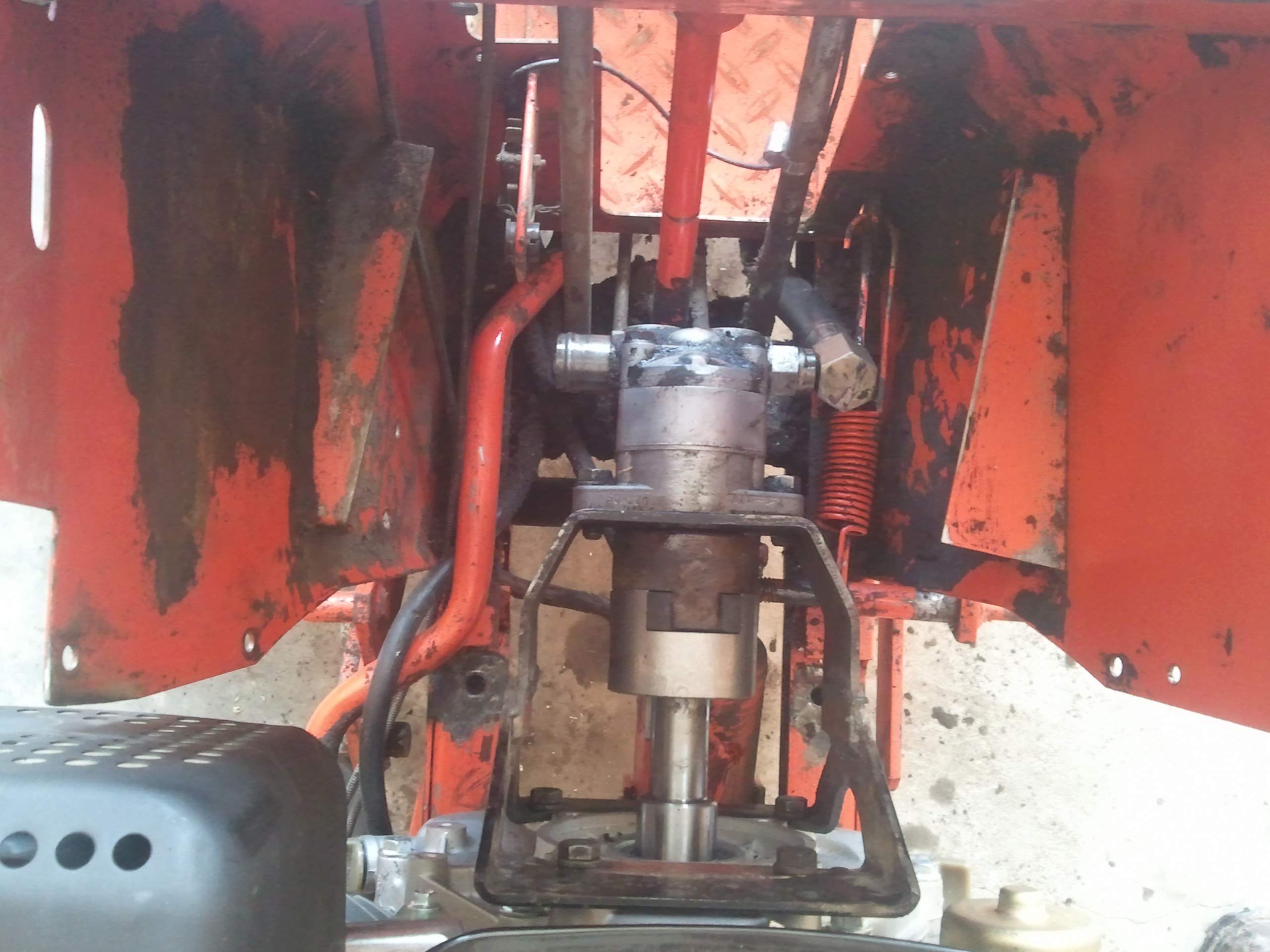

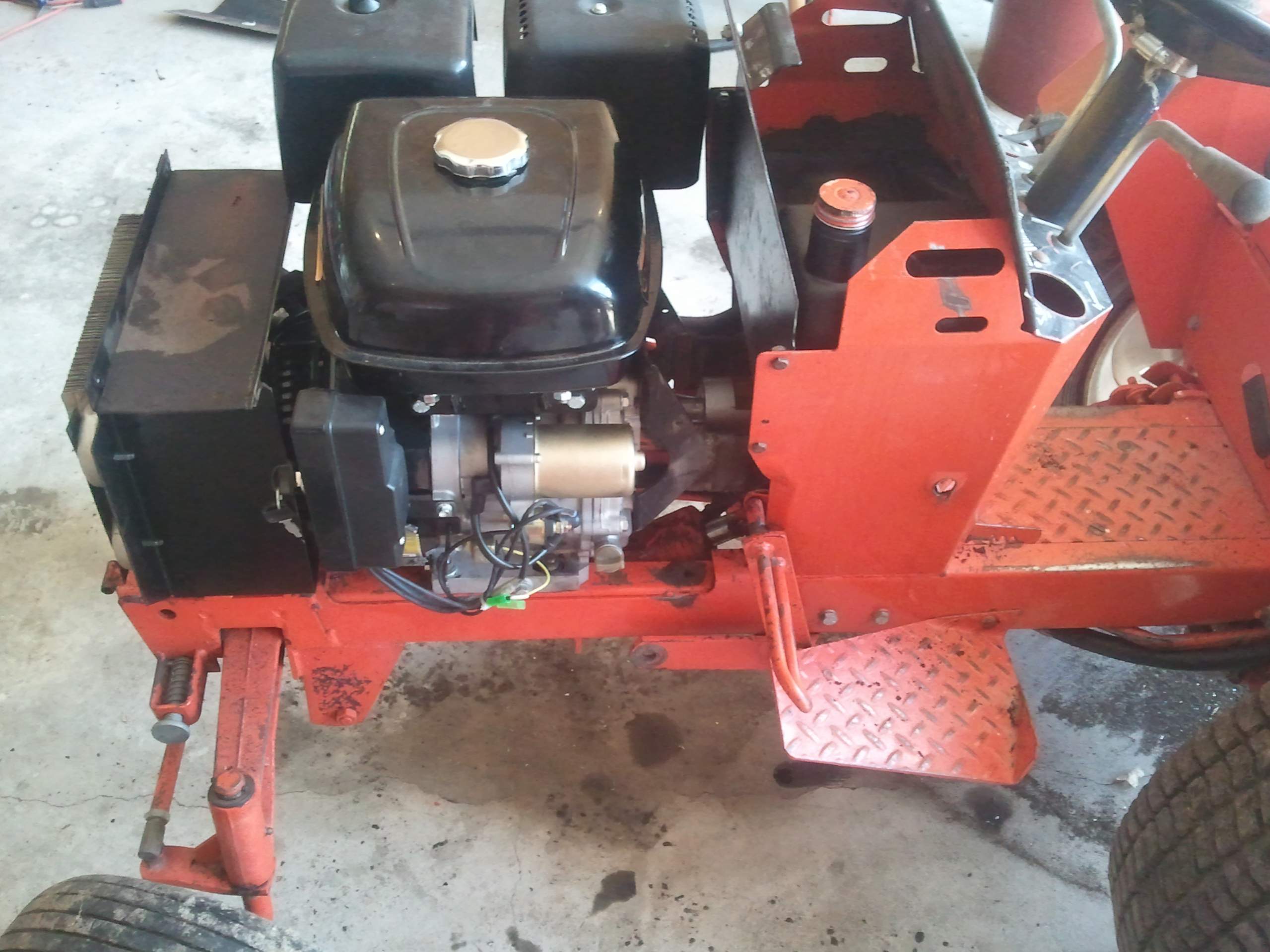

Drilled new mounting holes and expanded 2 existing holes to mount the engine. Fits like it was meant to be there!
I only had to cut the heat shield above the rad cradle (from behind the old muffler) and grind a small corner to clear the muffler completely.
I will remote the key to the dash, and modify the air cleaner and muffler so I can fit the hood back on. Best part is the tractor is useable again, since it runs like brand new! the 15 horse single doesnt even grunt under load of tilling.
Thought I would share with the group.

It actually works perfectly for me. The battery will go back in the original location, since I havent installed the battery yet. The ammeter was trashed, as was the original engine. I have had my fair share of experience with the opposed twin onans - and they are JUNK. Too many issues with broken cranks and terrible fuel systems.
I dont need the 15 amp charging circuit, (this one has a full 9 amps BTW) and there was no front clutch, clutch engagement, fan, or clutch attachments when i got the tractor. moot point, since this machine has been out of production for so long you cant find cheap parts. The exhaust and air cleaner mods will be minor, and are a non issue right now, since I at least have a running tractor which i did not before. FWIW, there is MORE air flow through the rad now than when I was running it with the Onan last year.
I also have set up many lovejoy couplers, and my dial indicator gets used more than you think.
