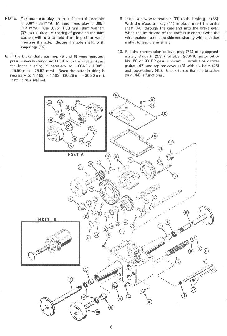

It is not a Hydrostatic drive, It is Hydraulic with a geroller pump and a hydraulic motor driving a two speed transaxle with 16" wheels. It uses motor oil, not hydraulic fluid.

The second picture I posted, reminded me that the "Hydraulic PTO" on the back, is connected first inline after the pump. And there is an optional Flow Control valve available for extra slow ground speed when using the tiller.
And had a drawing of the transaxle.
   / Case 444 Garden Tractor Hydraulic system help? #11
Looking at that drawing, I'd do it in the attachment lift cylinder circuit.
