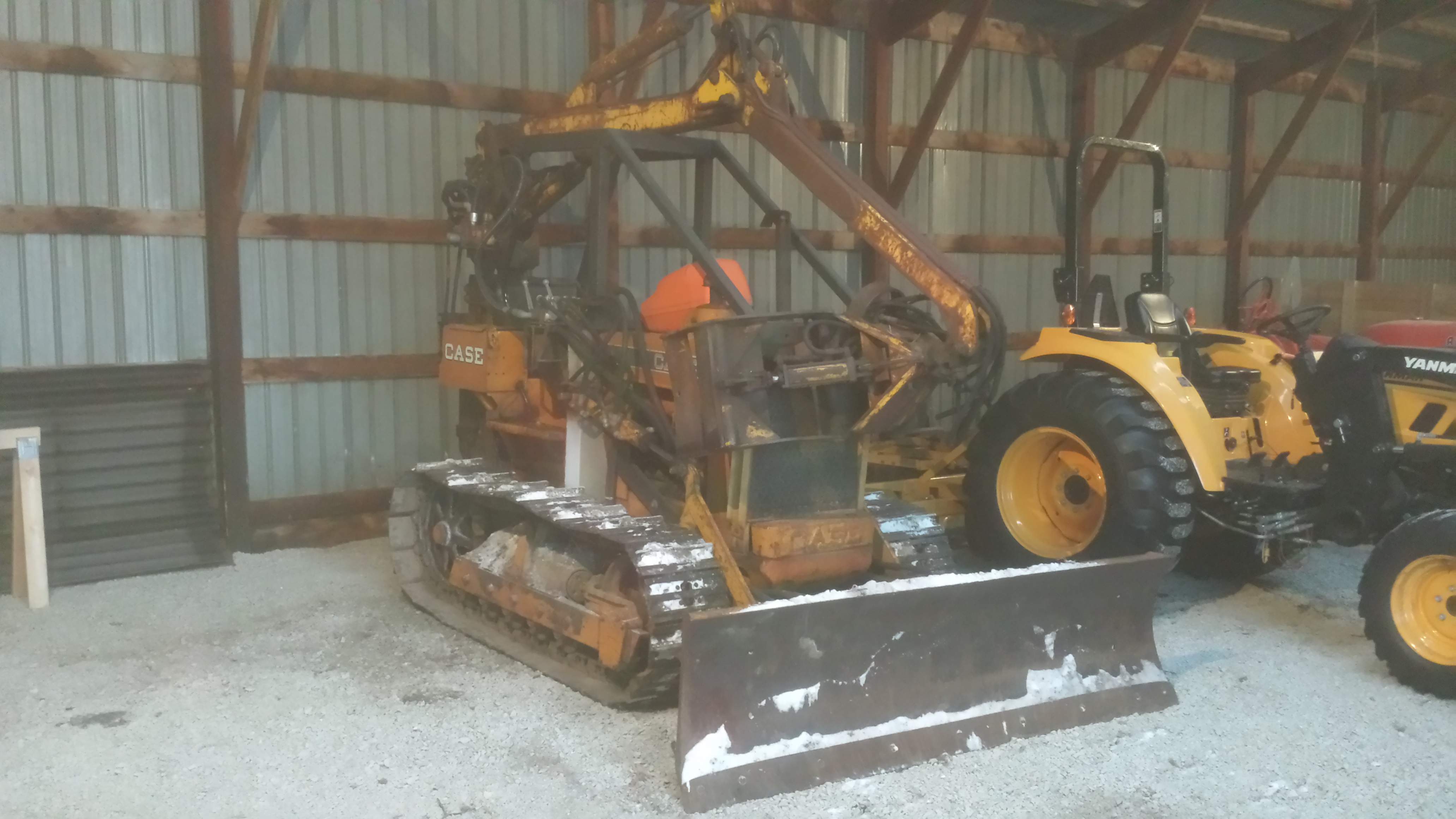

Hello Everyone,
I purchased a 1967 Case 310G dozer (diesel) with a 4 way blade yesterday and have been trying to figure out the battery configuration. Luckily the powers of google helped me find this great knowledge base.
My 310 came with two (600amp) batteries that were not hooked up. One battery is junk and the other is brand new. The place I purchased the dozer used a Jump box to start it and then I just left it running on my trailer until it was unloaded at home. My question is what is the proper battery size (two 600amp?) and the sequence in which they should be connected? I assume it is ground to negative (bat 1), positive (bat 1) to positive (bat 2), then negative (bat 2) to 2nd ground?
Any help would be greatly appreciated as the lady who sold it is still looking for the manual. Attached is a picture of my new toy! :)
   / Case 310G Dozer Battery/Electrical help. #2
Look and see if there are any type of identification tags on the starter motor, or on the alternator or generator, if it has one. This would give you and idea if its a 12 or 24 volt system. If it's 12, then hooking both batteries up, pos. to pos. to the starter motor, and then neg. to neg. to ground on the engine would give you a 12v parallel hookup. If it's a 24v system, then the batteries would be hooked in series. Pos. on one battery to the starter, then a jumper from the neg. post to the pos. post on the other battery, and then the neg. on that battery to ground. Two batteries rated at 600 CCA each would be a good start. The higher the CCA rating, the more cranking power you will have. I would go with the highest CCA you can get with the battery group size that will fit in the battery box on the machine. Now, don't confuse CCA with CA. CCA is cold cranking amps rated a 0 deg. CA is cranking amps, which is rated at 32 deg. Don't let someone fool you with a higher CA rating!

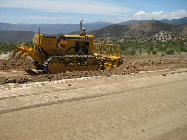

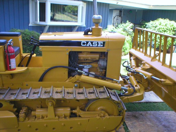

   / Case 310G Dozer Battery/Electrical help. #3
I just run a single 900CCA in my 310 diesel. Works fine although the battery seems to only last about 3 years. I think they just get shaken to much to last much longer.

Thanks for all the help. Yesterday I cleaned, repaired, and replaced all the battery connections as needed. Re-installed the batteries in parallel and she fired right up. However, I will probably end up removing one of the batteries and use the extra battery box as a tool box/storage.
