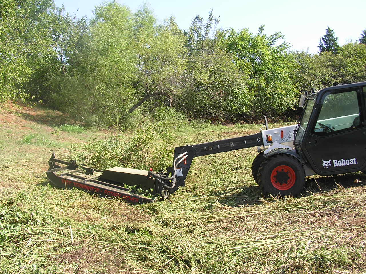

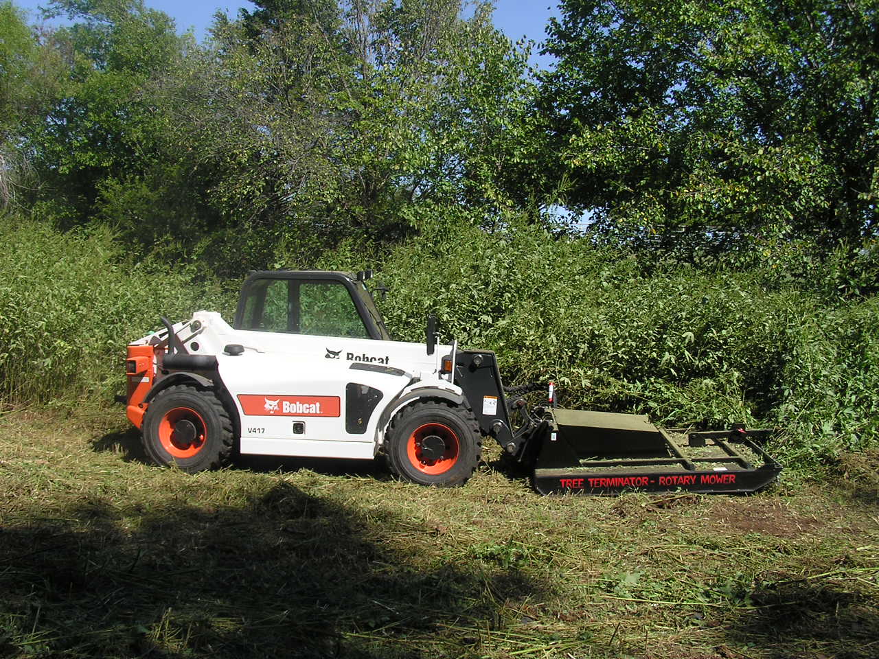

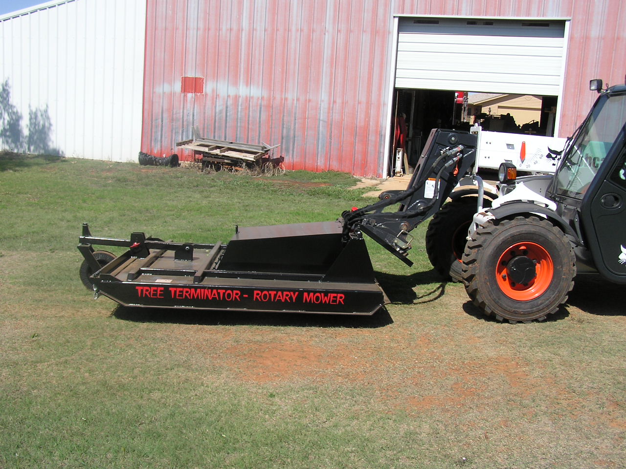

The brush hog we use is rated for 15-25 GPM: Grace Manufacturing | Home of the Tree Terminator
