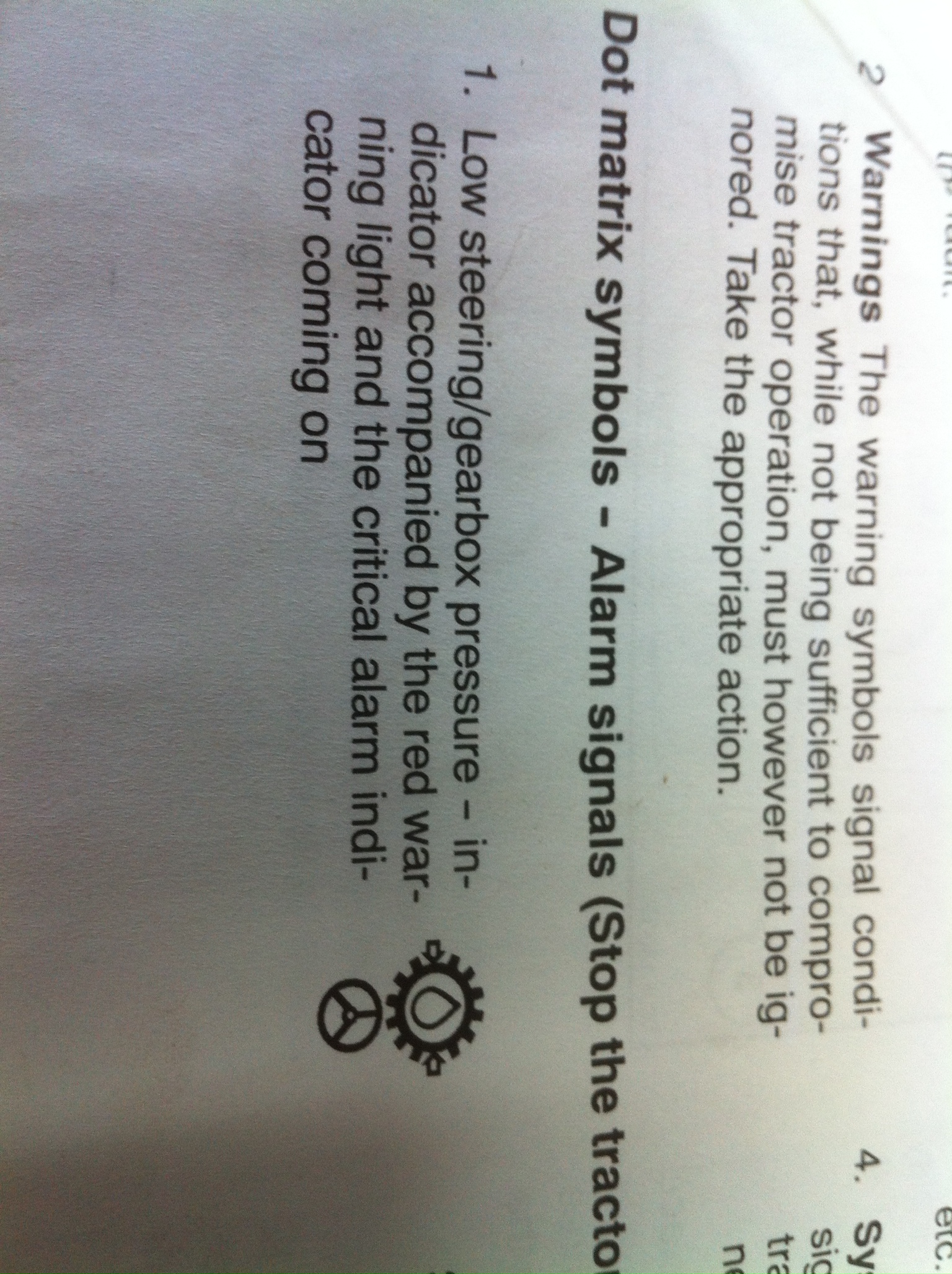

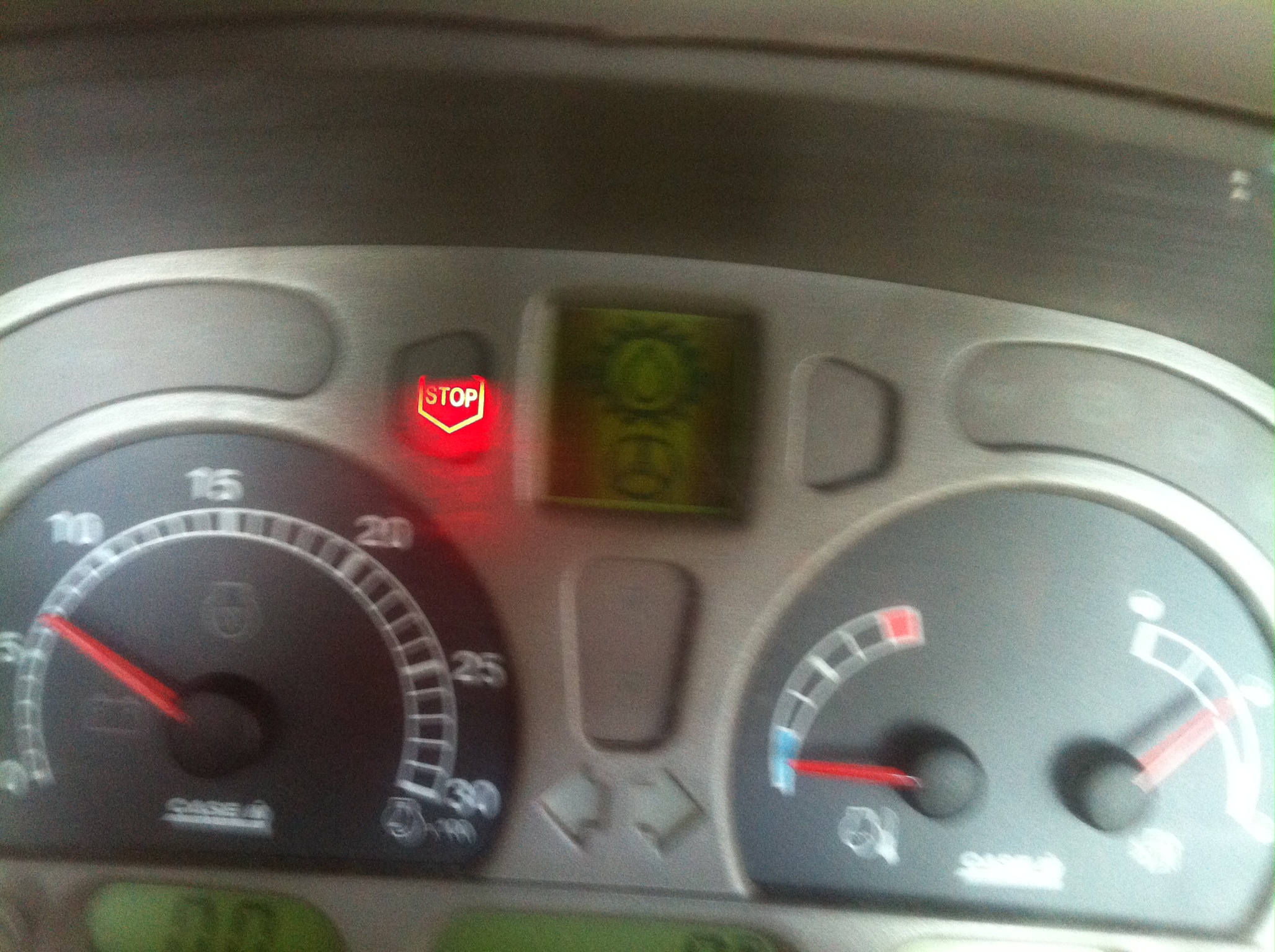

I had a call from a friend at work today he was using the company's JX1100u and got this stop warning light. I sourced some info online for him, see second picture and told him to call the dealers network. Problem is the network service centre has shutdown for the Christmas Break. Can he fix this or can he limp the tractor home, about 1.5 miles. Advice? IMG_3795.JPGIMG_3794.JPG

I'm not sure from the parts diagrams that I can find, but it appears that the steering runs off of the main hydraulics. In fact, that warning description indicates that they are on the same system so it is either steering or gearbox or both. That hydraulic leak may be a bigger issue than believed.
The other thing it could be is an indication problem. Does he still have steering and drive?
/ Case 1100u Emergency stop warning light.
He does have steering and drive. Just playing safe on a new job with the company machine. Where is the hydraulic fluid fill point and should I advise him to try a top up and see if the alarm light goes off.
