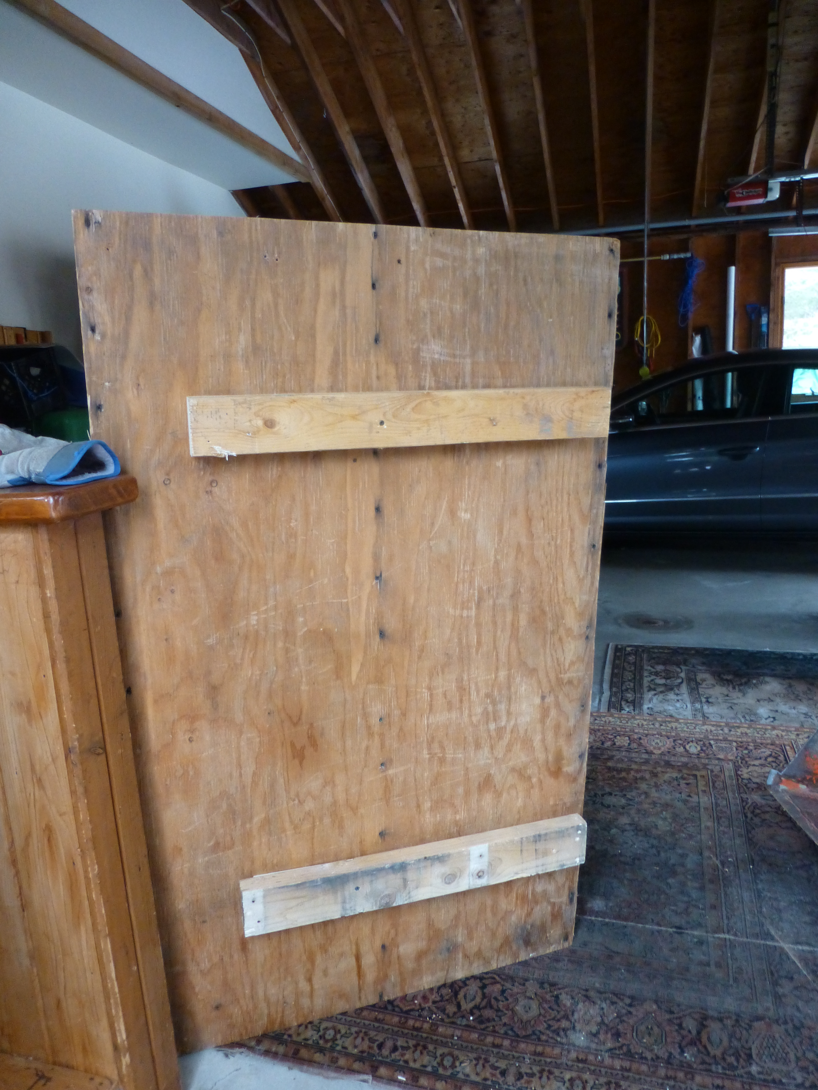

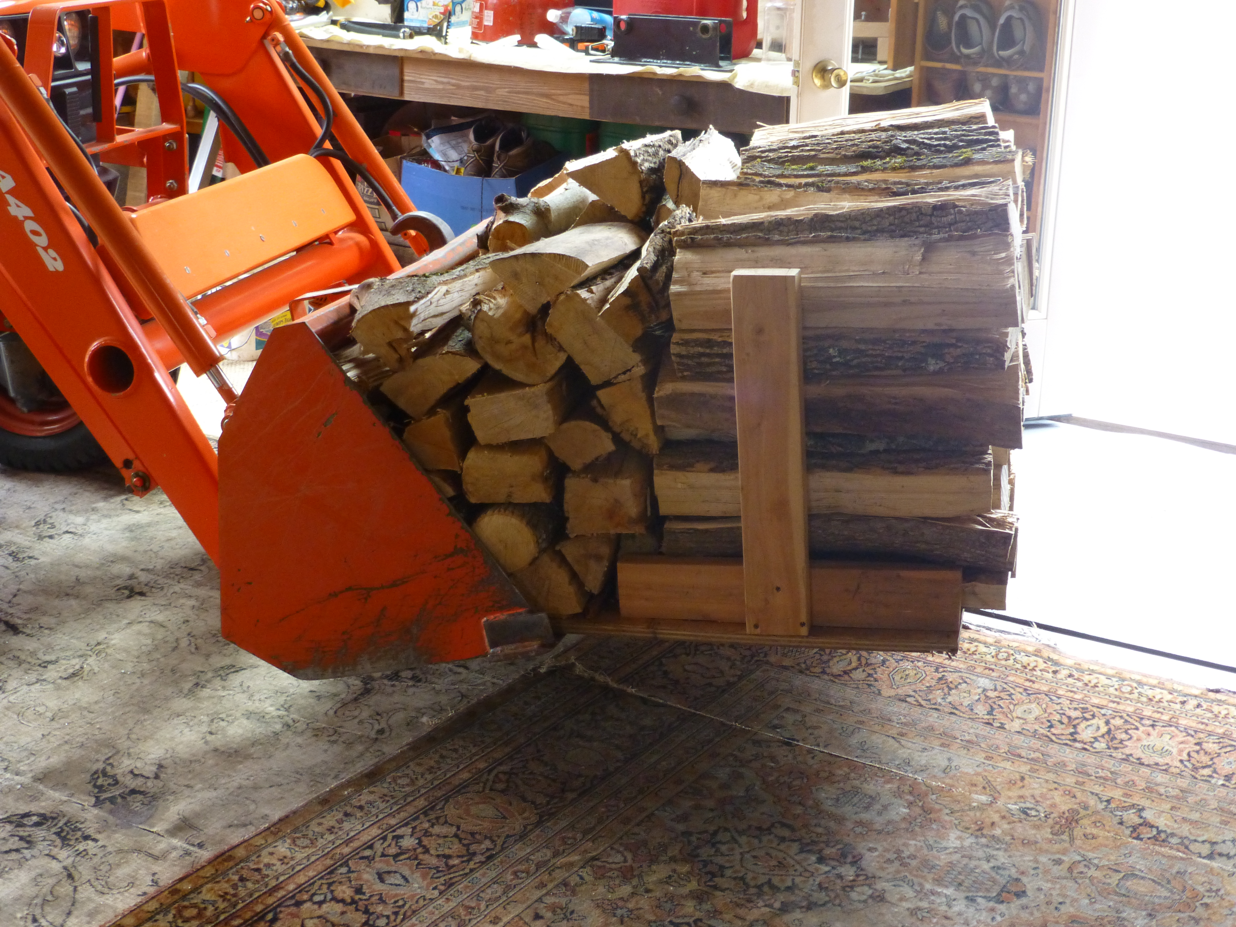

Jackie-
Easy to do, no straps, etc..
Just screw two pieces of 2 x 4's on the bottom of the plywood with wooden spacers the thickness of the front edge or your bucket.
Make sure the plywood sets into the bucket as far back as possible.
Always load the bucket first which will then support the weight on the plywood that extends outwards.
Use a good grade of plywood.
I'll say! How do you secure the plywood FEL extension? I was thinking about doing something similar, but using some sort of cable/rope to my bucket hooks. I'd like to keep it as simple as possible.
