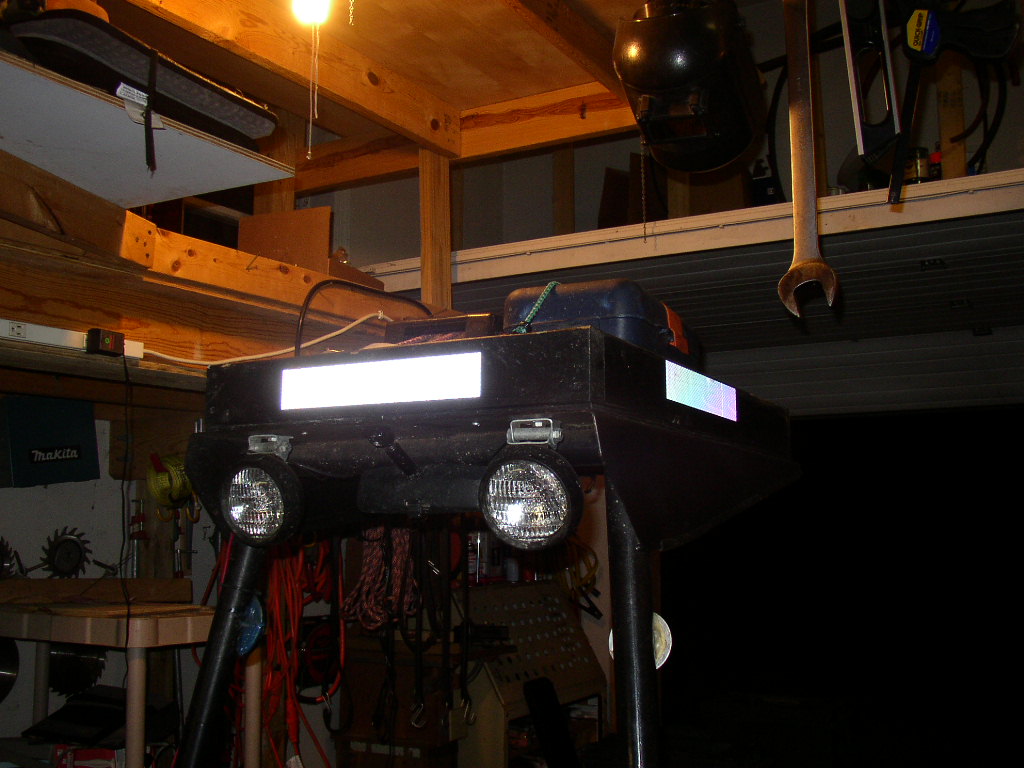

What me carry a lot of stuff? :):)
I have attached a couple of pictures of my storage. The ROPS Rack is made of 2 X 4 frame mounted on a sheet of plywood. Most of my 10 acres is woods and it has never been damages.

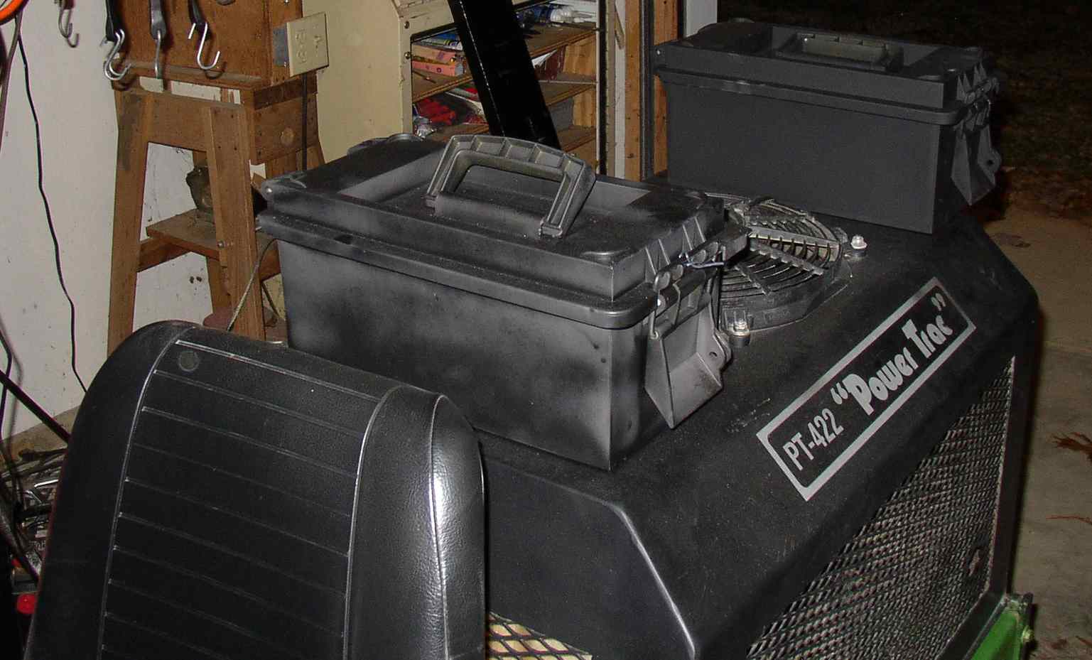

I have also mounted tool boxes on the engine cover. I can still open it without too much extra effort.
So what would be the chances of you taking some pictures in a brighter environment.
A toolbox on the back end is possible, but the flashing yellow light is pretty handy here. No way could I lift the lid on my tractor with a toolbox at front. The 1850 lids are massive. I actually think that my wife will not be able to lift it.

I will try to get a picture tomorrow in the sunlight.

Here are some pictures of the ROP Rack. I hope this helps.

Thanks Bob. Actually this may be the solution to my problems. Although I think the 1850 is taller than the 425...
