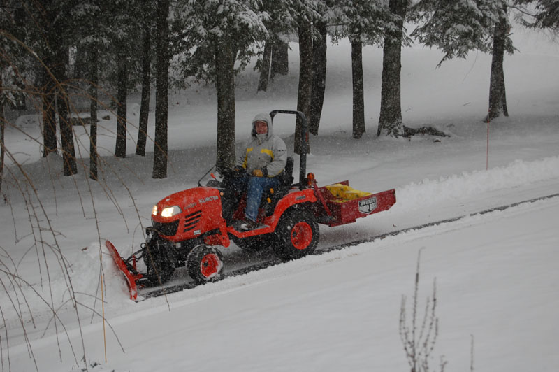

Here is a picture of a commercial one in use:

That looks like it's just right in size. I looked at the TSC's carry all today, and it looked huge. Where did you get it.?
   / carryall / dumpbed for rear of bx1850 #5
I have the same one that Chuck shows in his picture (slightly different than the one shown in the link - there i is no tailgate). I purchased it at a local implement dealer and I don't know the make. Was about $320.
It has a pull lever that you can tie a rope to - pulling the rope will dump the box. It helps to have a hydraulic top link too - because sometimes the weight of the load is too far forward to dump. A quick tip of the toplink takes care of that.

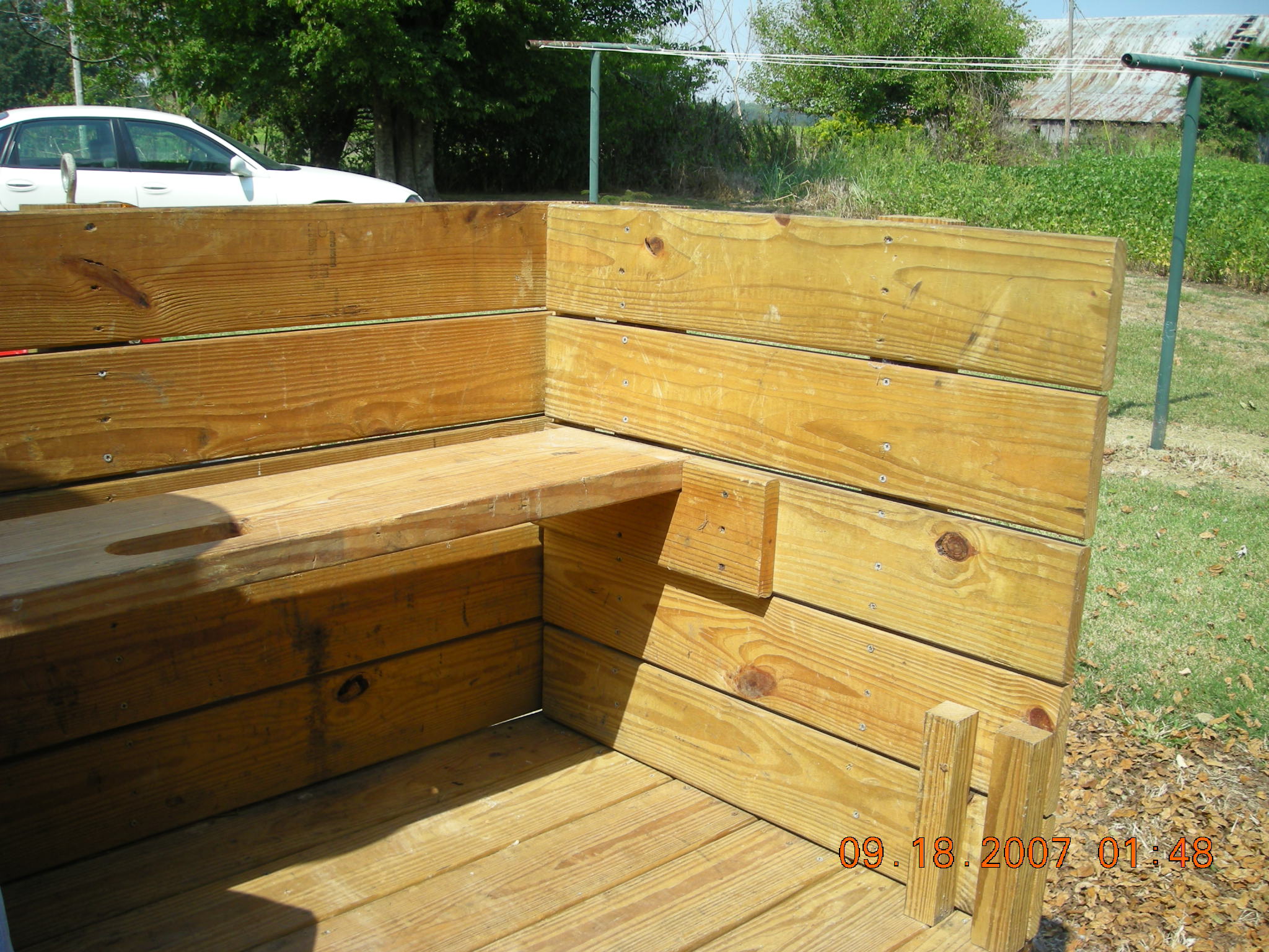

Here is s pic of mine. you can take the sides off it has a back tailgaate that doubles as a seat for taking the kids for rides. built off a TSC platform.

   / carryall / dumpbed for rear of bx1850 #7
I just bought some 3-point pallet forks off of ebay for $60 and built a box out of treated 2x4's and deck boards. It works great for transporting dirt, rocks, wood or any other loose material. It does not dump, but I don't have much need for a dump bed.
ae_ted,
Can you tell me the dimensions of the box you made? Lookas like it is about 60" wide, 24" high, and around 30-36" deep?
I am stopping by TSC tomorrow for a "Carry-All"!
