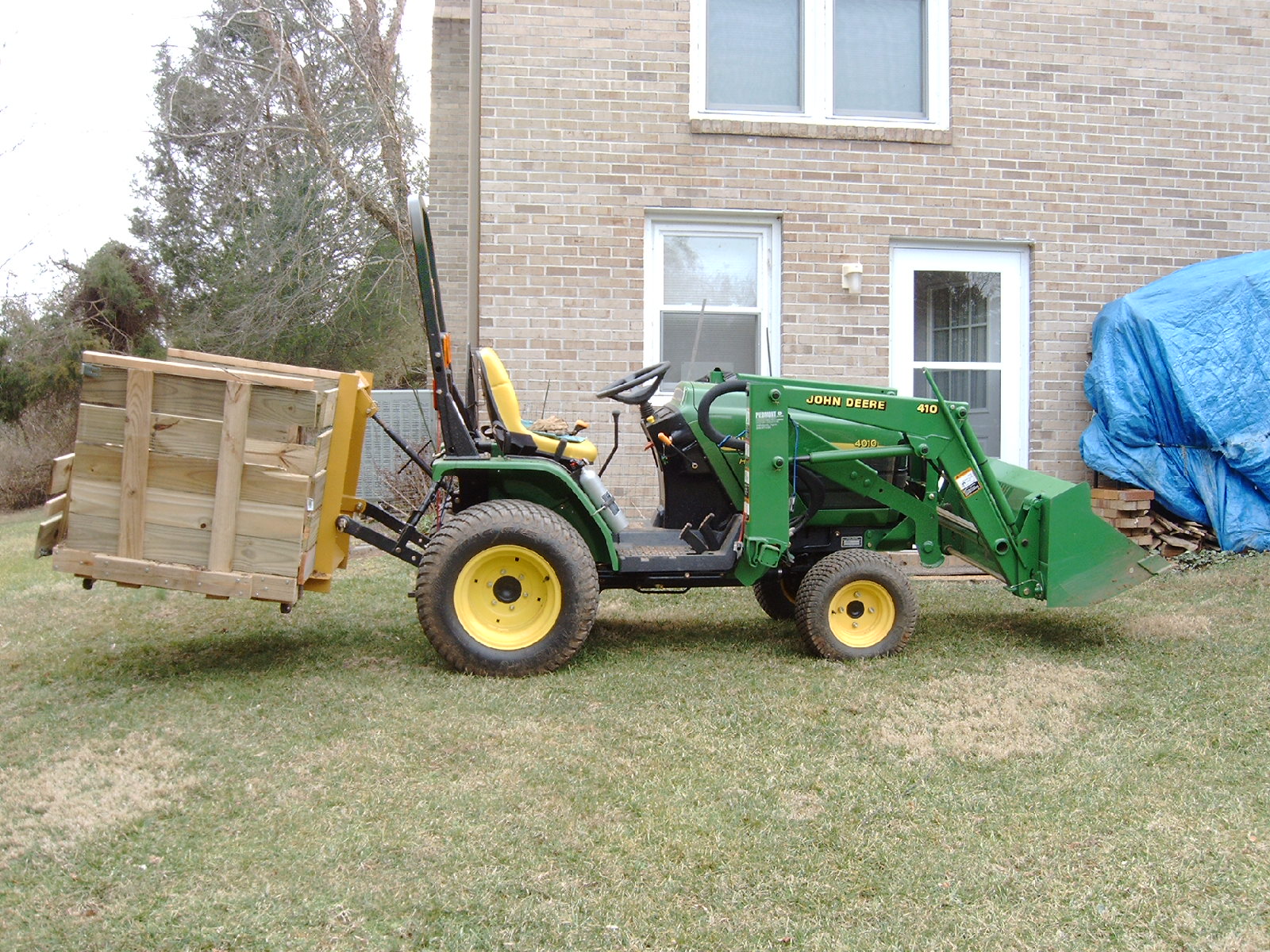

I made one very similar (how different can boxes be?) only using plywood. I made a 3 piece drop in tailgate with handholds cut it. On mine I made a hold-in bar to keep the sides from spreading and letting my tail gate out. I mainly haul firewood and it can put quite a bit of out pressure on the sides. I may have to add tool holders to mine now. Thanks for the idea and pictures.
Doug in SW IA

Here's my carryall. Put a pallet on the bottom part and then built up from there. Back tail gate can be opened in 2 parts.
Ralph
