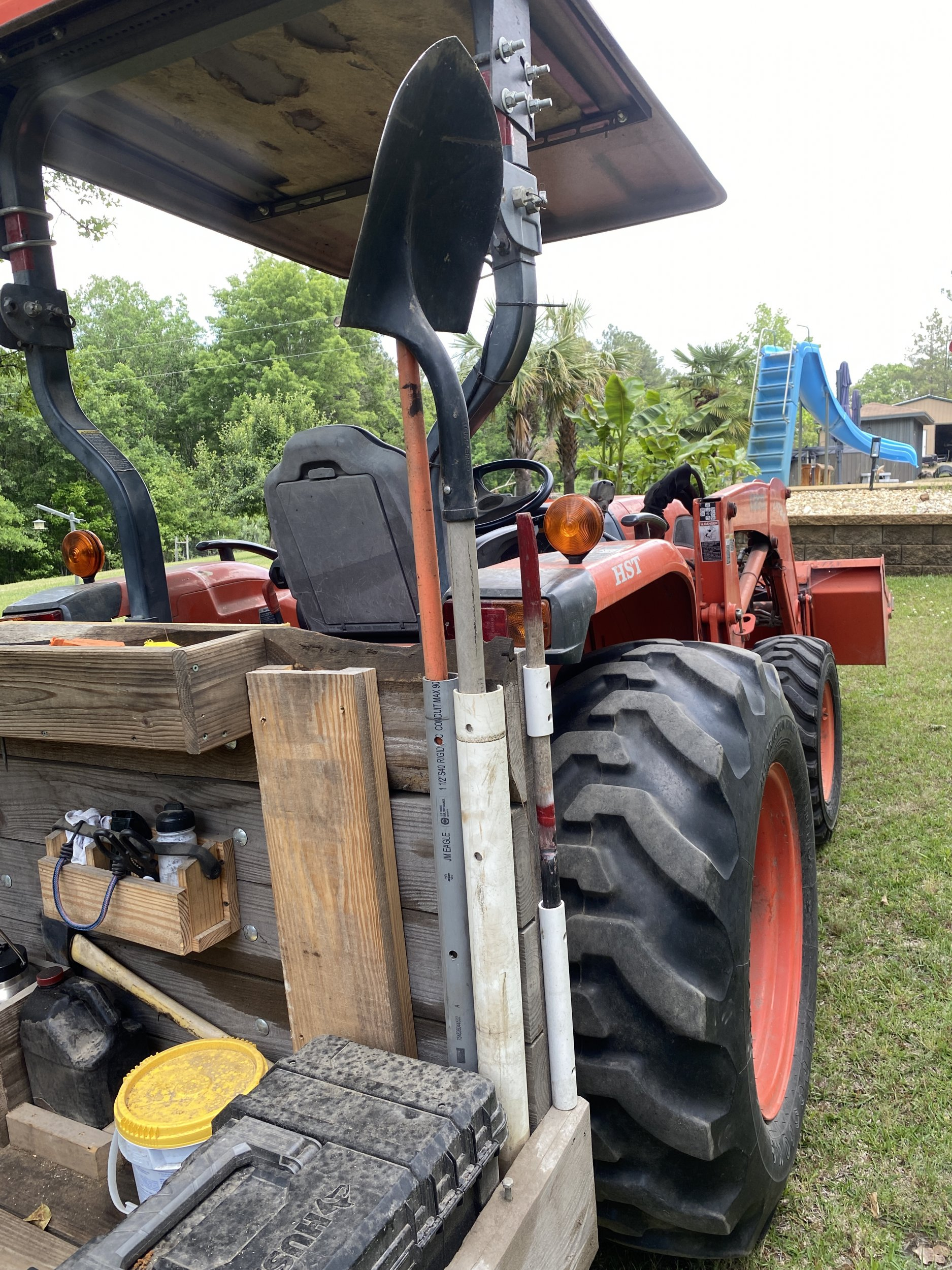

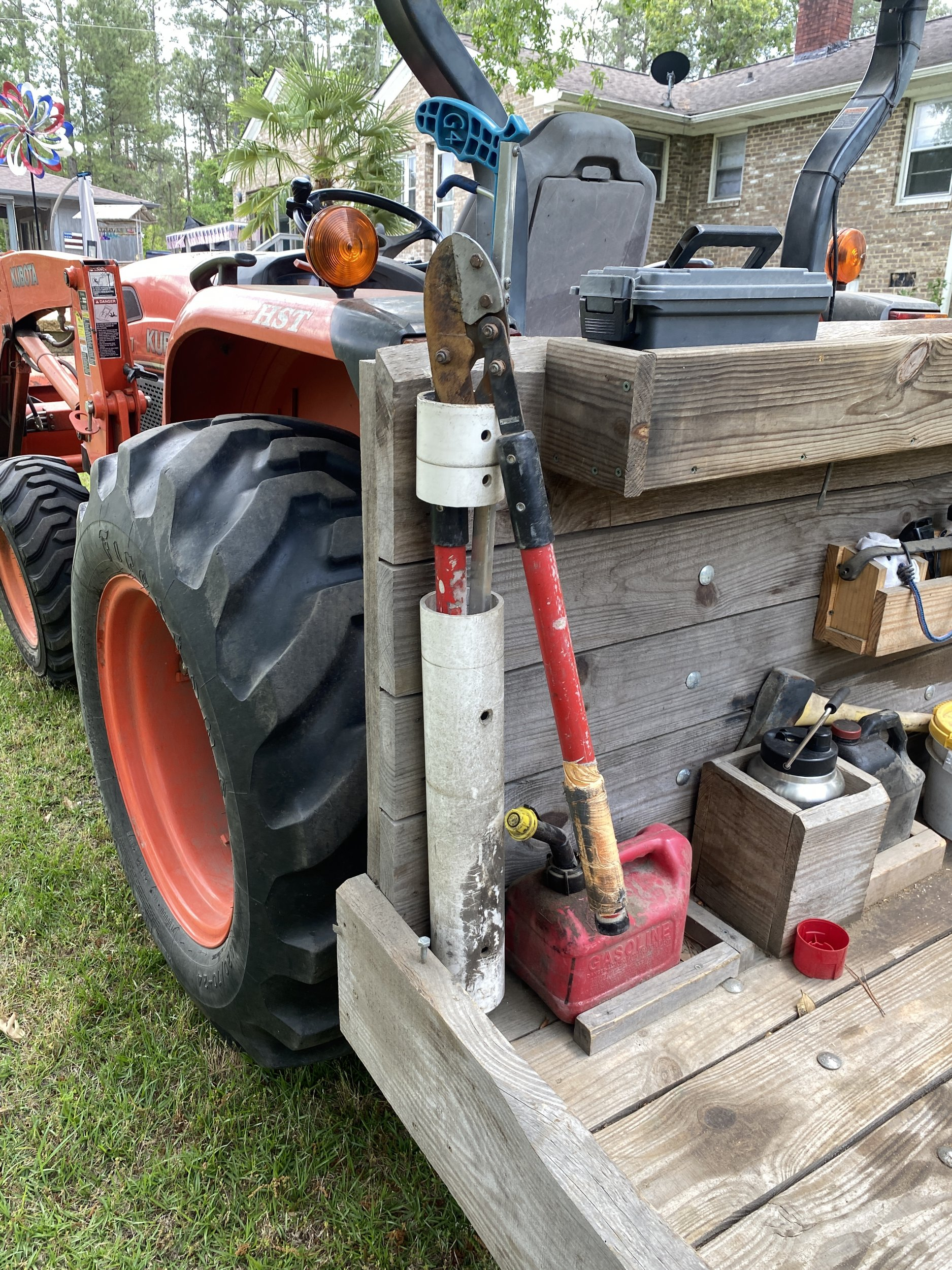

Yes, PVC is your friend. My carryall is almost always on my tractor and PVC helps me carry a lot of tools. I drill a larger hole on the outside to allow the screw head to go through and a smaller shaft size hole on the inside for the screw to go through and attach them where needed, no bottoms on them to allow drainage.
