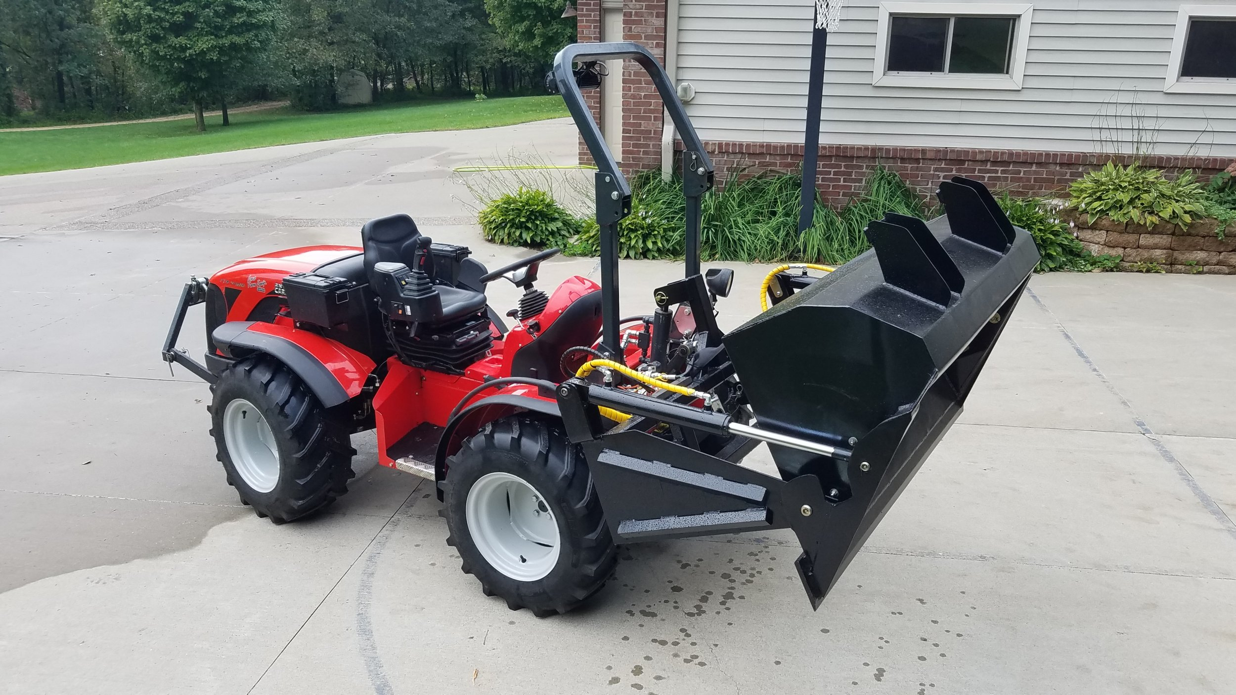

I have a FEL on my A.C. Comtrac. Not very stable unless have massive counter weight. Sigma brand FEL and you can't get parts for them in the U.S. as I tried. Very nice machine for mowing and if you go TTR the reversibility feature offers nice options for front mounted flail mowers. I gave up on rotary mowers years ago, too many rocks to hit and throw around. Big gap in the horsepower range though, nothing in the 40-50hp range in the TTR or manual transmission models. Lots of these in the orchards in WA state as they the articulation and separate front end portion of the tractor and the rear portion offer extremely nice ground hugging function on rough ground as they rotate separately.
