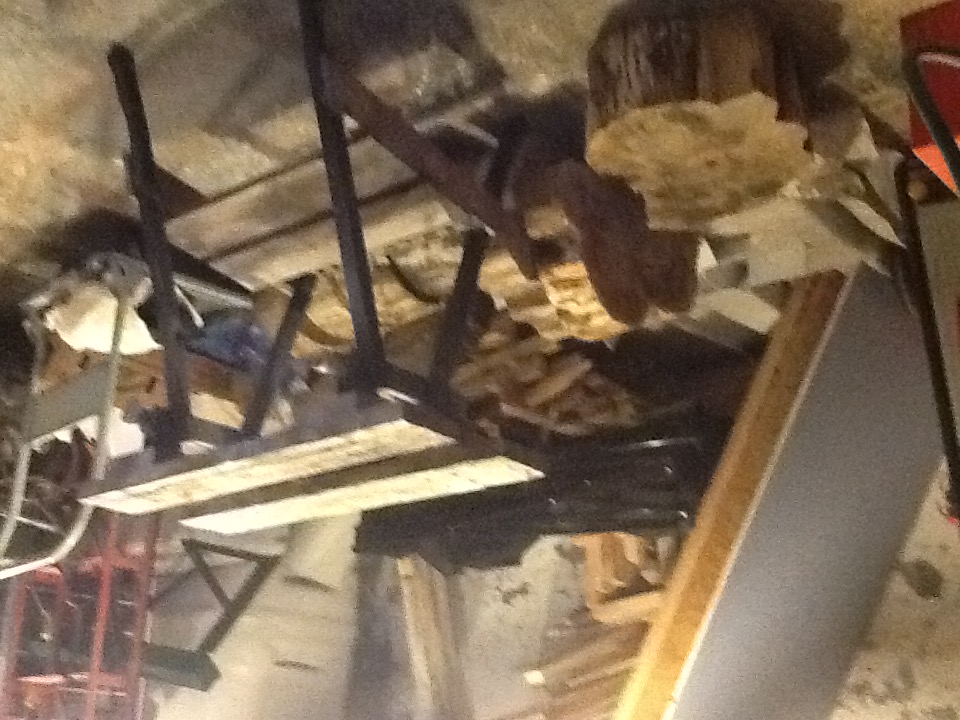

I don’t think there’s any standard on sawhorses. Most of them are built from scrap lumber. My personal requirement is a wood top that’s nail free so you can cut across it. Here’s my favorite pair of saw horses I’ve ever had. I don’t like fixed ones because they’re to hard to transport. These are the only folding ones I’ve had that are sturdy and they offer the freedom to make them as wide or short as you want. I had a set mad out of channel iron that I never used and sold. You could have set a loaded dump truck in them but they were too heavy.

A three leg saw horse made to hold a worktop. 9FC9E03C-13A0-4B1D-9BFF-63A50834A3BE.jpeg
