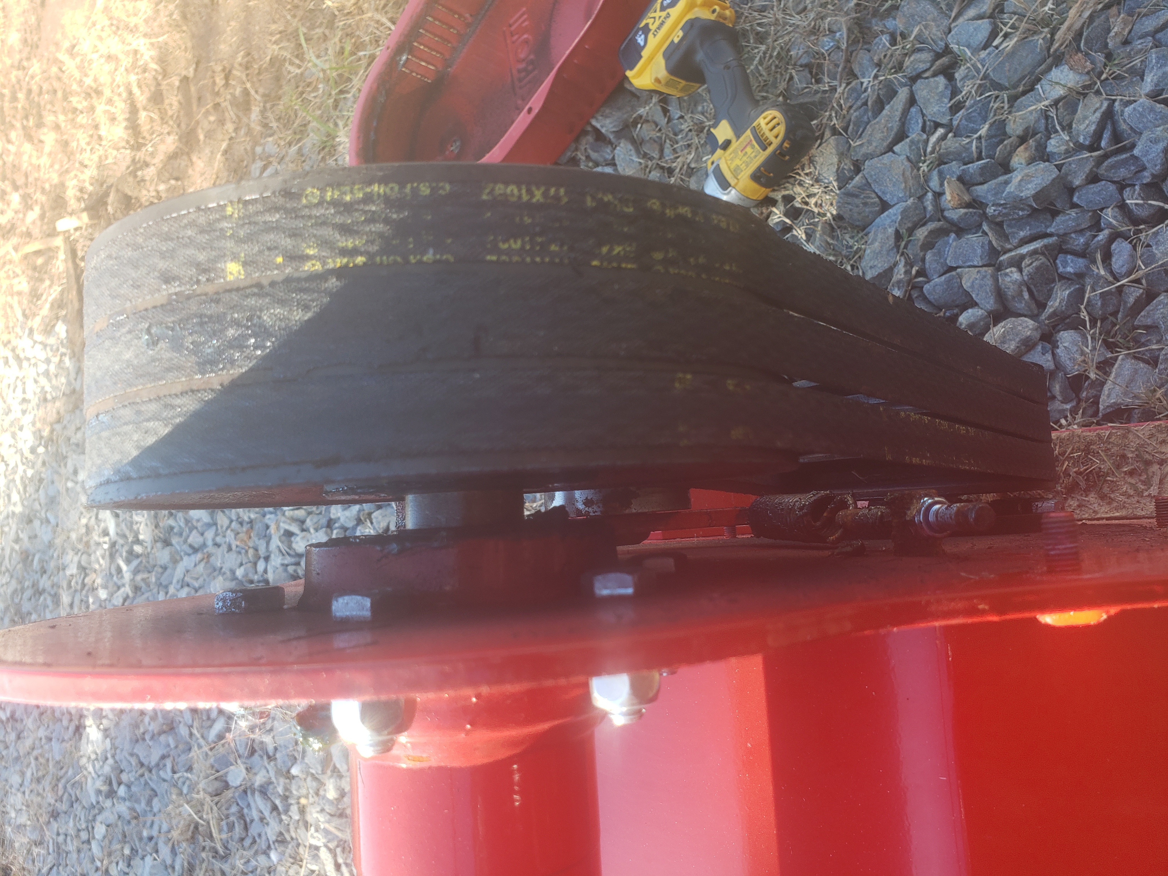

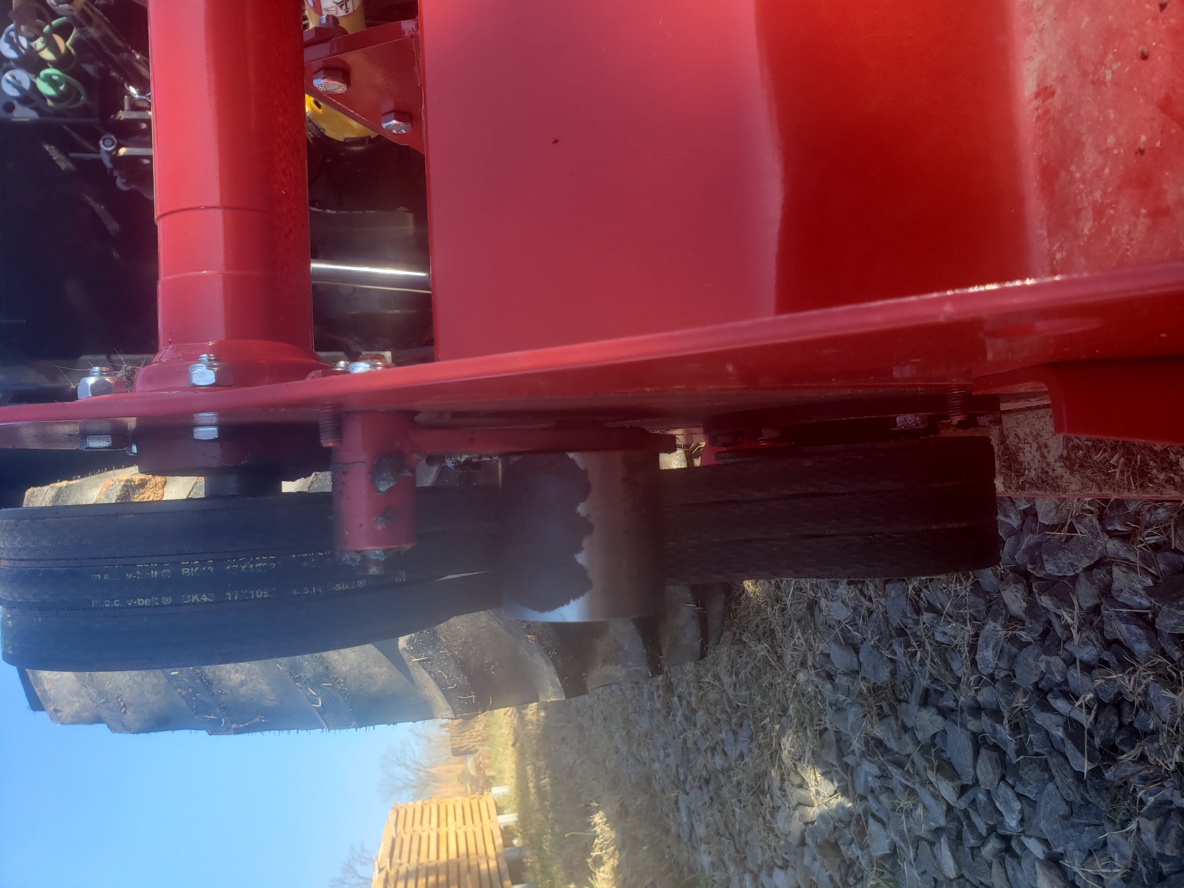

Picked up a new Caroni TM1900 from AgriSupply yesterday and tried it out this afternoon for the 1st time after greasing everything and cutting PTO shaft. Started smoking after the 2nd pass. The outside belt was 1/2 way off the tensioner. Set them back in line, tightened past where it was previously and tried again with the same results. Looks to me like the top pulley is too far out and causing the belt to slide off regardless of tension. What do yall think? Thanks for any help. Sorry if this is in the wrong place.
/ Caroni flail smoking belts #2
THose belts don't look to be in proper alignment but it could be the picture angle.Run a straight edge between the faces of the pulley. With the straight edge secure is the idler pulley square to the other two pulleys?

Beaver - Looks like the top pulley is 1/2" out further than the bottom. I'll have to run and get a spanner wrench that will fit and see if I can bring it in.

Johnston - I was overheating and melting belts on my Caroni TL1500, which has only 2 belts. Tried better belts, tensioning, etc. Finally determined that top pulley was further outboard than the lower pulley. There is a spacer behind each pulley. Took measurements to determine the offset, removed pully and spacer, and had a machinist turn down length of the top spacer. Reassembled and problem stopped. Finished 2nd year on this set of belts. I run the flail about 30-40 hours per year. Best wishes.
Thanks Rusty. Sounds like the same issue. I found the pn for the spacer and will have them measure one in stock. Have you had any other issues with yours? It mowed great before smoking but worried about other hidden qc issues
/ Caroni flail smoking belts #8
I agree that the picture makes it appear that the pulleys are not in alignment and as already suggested, just run a straight edge on the face of the top pulley and extend it done to the bottom pulley. That will tell you if they are in line with each other.
It also appears that the idler is rubbing on the idler swing arm. Could just be the angle of the pic though. There are obvious black marks on the idler, suggesting it is not spinning or not spinning freely.

With the black rubber coating the snubber pulley as shown in your photo the V belts are too tight.

With the black rubber coating the snubber pulley as shown in your photo the V belts are too tight and the pulley has slid out binding the pulley and the V belts and in the process causing the rubber to heat up and coat the snubber pulley with the melted rubber dust.
The top V belt pulley has slid outward and needs to be taken care of.
The V belt sheave must be loosened in order to correct this by removing the belts and examining the
Sheave 3 V pulley, The key, and the set screws.
Lets get the upper sheave pulley off and then go from there as there is a specific sequence to properly
install and adjust the sheave pulley and the belt tension.
If you have a steel straight edge you can correctly align the drive and driven pulleys BUT B$ you do this you need to make sure the set screws bite into the key. you do this with a small drill bit to create a dimple in the key so the set screw has more metal to bite into.
Now its important to uses a few drops of blue Loctite on the set screw threads to secure the set screw and hold it in place. The blue loctite will allow you to remove the pulley in the future if needed.

- Measured with a straight edge and the top is 5/8" further out. Had to order a spanner wrench small enough for the nut to try and bring it in (since nobody w/in 45min stocks them, but still complain about people shopping online). Supposed to be here by Wed.
- I took the tensioner/idler off to check and it was spinning freely. The black area in the pic was a surface rust spot with rubber on top. It was looser when I picked it up, but I over tightened to try and keep the outside belt on before realizing the top pulley wasn't aligned.
- I didn't run it fast or through thick stuff. There was a shallow groove in the outer most belt from rubbing on the corner of the idler.
- Still not opposed to cutting the spacer down 1/2" if needed but hoping I can bring it in with a wrench.

For some closure in case someone has the same issue in the future: AgriSupply shipped me a new one at no cost after I was unable to bring the top pulley in with a spanner wrench. Top pulley on new unit is sitting flush with the bottom pulley and tensioner. Good customer support so far. They are going to send someone else to pick up other unit. 4 13mm nuts to remove the cover over the pulleys to check with straight edge as mentioned previously. Easy 30 second check before buying if in person. Tech I spoke to said he hasn't seen that misalignment before. Greased and ready to try out once I get a few dry days.
