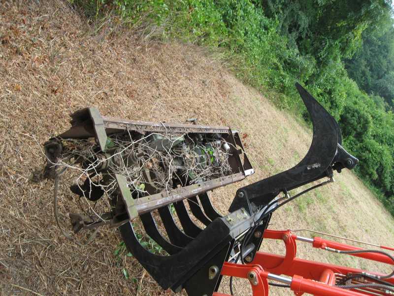

Yeah, that is what happens when you start reclaiming a farm that has been abandoned for the past twenty five years or so. Discovering little pieces of "history" is part of the fun. I managed not to hit it but it was quite a surprise to find an entire gas station pump in the middle of one field.:eek: What were they farming?
Abandoned for 25 years?...Sounds like everyone else found a place to deposit unwanted stuff...:(
Well on the bright side...It definitely justifies your Grapple....:D
