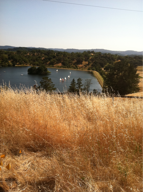

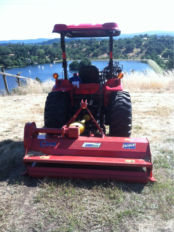

Bigman, I just took delivery of a Caroni TM 1600 BSC with my new Mahindra 3016 tractor and used it for the first time yesterday. PTO hp is 23. I was surprised at how simple the whole operation was. It cut 5ft tall grasses without any problem at all. I got good advice from other TBN users on another thread and I'm very pleased with my purchase. (All three hours of use so far. )
Other users suggested I go with the TM 1600 instead of the TM1900 for my 23hp. If you end up going for the TM1900 let us know how that goes.

Did you actually get a TM1600 or is it a TL? The TM has knives mounted via a clevis while the TL knives attach directly to the rotor. I was not aware that any US supplier imported any TM models other than the 1900.

I made the picture larger and he did buy a TM1600.

IslandTractor. Yes mine is a TM 1600 BSC. I purchased from my tractor dealer in Sonoma County California. I believe his distributor is in Texas. The price was about $1k more than it would have been from Agri Supply. Agri doesn't stock the TM1600.
