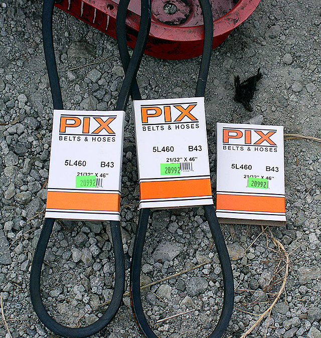

I went out to try to install the three PIX B43 belts I ordered from Agri Supply.

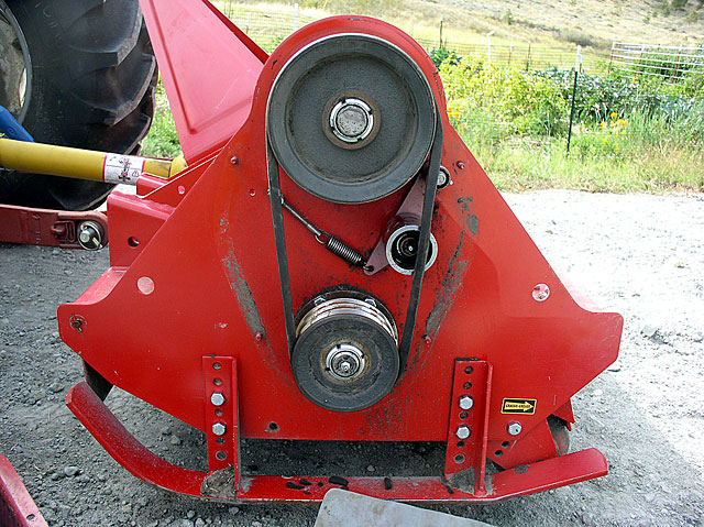

I completely ran the nut out on the bolt attached to the spring. Even run out all the way, the tensioner isn't far enough back to be out of the way. I managed to get the first belt on the first pulley and now I'm stuck. I can't get it off and I can't get it to go over the sheaves and on to the rear set of pulleys.
Not fun. I think I'll go dig some more potatoes, that will make me feel better.
HELP Mr. Wizards HELP!!
Ok can i ask if you are trying to install the new belts with the snubber behind the front portion of the three belts with the front flat edge pulled inward trying to position the snubber too far forward??
The snubber should putting pressure in the back/rear flat side of the 3 belts to provide proper tension not the front sideflat edge of the three belts?

Sounds like the belts are too short , can you post a picture ?
Here are a couple of pictures that explain my situation better than I can.
Any tips on how to get those belts on without doing any damage with a prying tool would be much appreciated.

They look about the same as what's on IT's flail .
Were the originals B43's ?
The trick with these belts is to take the PTO shaft off so the pulleys , turn easily . Put the belt on one pulley and started on the other , then with both hands on the belt (front and rear) pull up on one side so the pulleys turn and wind the remainder of the belt on . From were you are now with that first belt (if they are in fact the correct belts) , start the belt onto the next sheave and rotate the pulleys . You will now have the belt on the first sheave of one pulley and on the second sheave on the other pulley . Now start the other end onto the second sheave and rotate again . Repeat until it is on the last sheaves and start the process over with the second belt and so on (it is extremely important that you don't allow the belt to roll over on it's back as you do this , it can damage them ) . That idler will have to be pulled back out of the way and held back .
   / Caroni Flail Belt Failure #195
B43 is correct. The originals were labelled with metric sizing. I have B43 belts now.
When I replaced my belts I used almost exactly the same method described by IronHorse. I vaguely recall using a screwdriver to pry the belt up over the lip of the first pulley. After that it was just rotating the pulley to feed the belts on. Moving a belt from the first to second or third sheave was easier and again used the rotation of the pulley. I did not need to disassemble any part of the PTO drive to free the pulleys but I might have disconnected the PTO shaft from the tractor. I can turn the flail shaft by hand without disconnecting the PTO when I am changing knives so it may not be necessary to disconnect.
I would also not worry about removing the idler adjustment bolt completely if that is necessary to remove all pressure. I took mine of and on when I was experimenting with the spring. I don't recall any significant problem getting it back on.

Thanks guys, I have successfully put the belts on. As with everything, once I've got some idea what to expect and what to look for things aren't so tough to accomplish.
Couple of follow up questions. I noticed there's some roughness on the surface of the tensioner. Should I be concerned about that shortening the life of the belts? If so, is there anything I can do to smooth things out?
Second, after a few hours of mowing would it be smart to go back in and make sure the belts haven't loosened up and perhaps retension the assembly so that the 3/8" deflection is reestablished?
