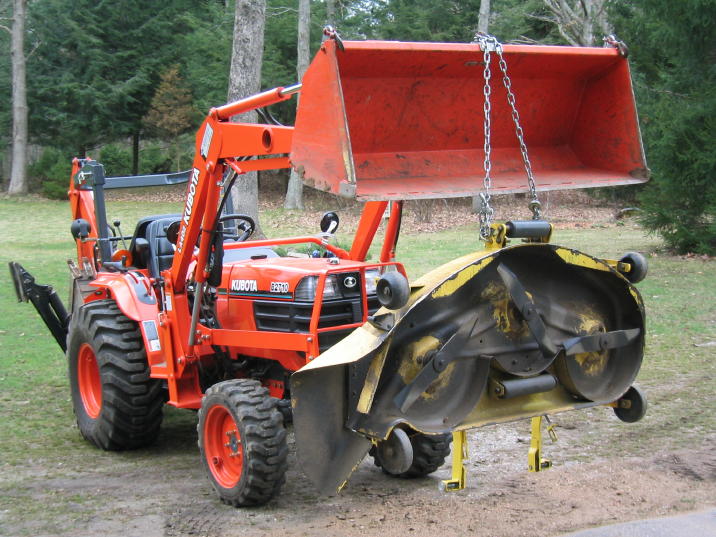

Hey Guys ...Well, here's the other side of the story.
/forums/images/graemlins/shocked.gifMower Deck maintenance, what's that? /forums/images/graemlins/shocked.gif
My first deck mowed grass for 22 years before I traded for the present one 15 years ago. I sharpened the blades yearly and clean what ever is still clinging to the deck at that time.
Never applied paint or oil to the bottom of deck,because the grass, dust chaff and dirt will only remove it within minutes anyway. The paint wears away but the deck never rusted beyond surface discoloration and was turned to bright shiny metal after first mowing each year. /forums/images/graemlins/cool.gifI replaced one spindle in 37 years.
/forums/images/graemlins/frown.gifIf you feel better for the activity, then by all means indulge yourself, but it's not necessary. I do wax and dry lube my snow plow to enhance performance & would do the same for my snowblower if I had one /forums/images/graemlins/laugh.gif /forums/images/graemlins/grin.gifbut I don't believe the underside of a mower deck needs too much after thought. /forums/images/graemlins/wink.gif /forums/images/graemlins/wink.gifRayBee
