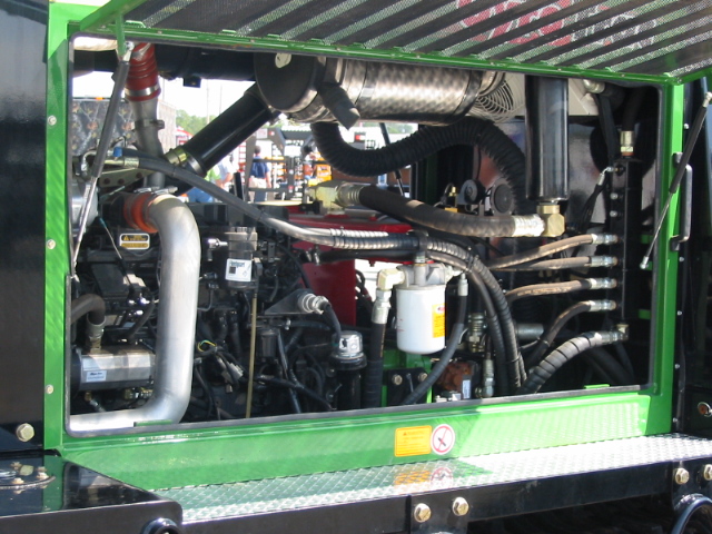

Hi Robbie. Here is me in a Gyro-trac at the Sunbelt Ag Expo, some various pictures of them as well as an RC100 with Carbide cutter. Hope you like.
Maka

Hey Maka. Gyrotrac's are so cool. To see them just sitting there one would have no clue to the maham they can cause. Gyro has really done there homework, they are extremely serviceable and tough as nails. I don't now if I told you but the GT-25 I demoed the salesman actually chewed up a aluminum wheel and tire.The biggest piece I could find was the size of my hand. How awsome is that? Did you see my post on the other thread about me going to a demo for a Newholland TV-145 with a carbide extreme? That was an very interesting approach to a mulcher carrier. Last thing, after seeing the pictures you posted of the snow you need a loftness snow blower on an ASV to show off !!!! Robbie

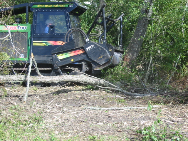

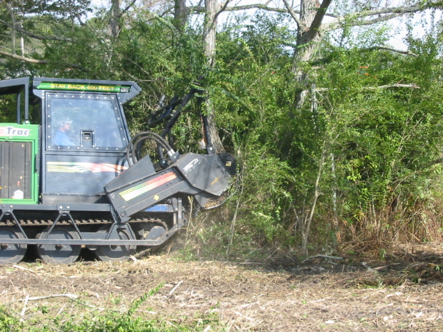

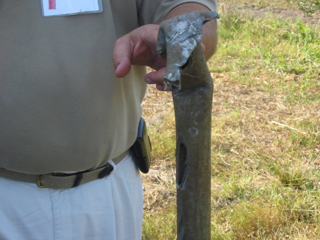

How about these? The pipe was in some underbrush. No damage to the machine and I was told they could eat much more. Here are some taking down some brush and small trees.
Loftness is nice stuff. I like what they have. I have an opportunity to be a Gyro-trac dealer but I just don't know about it as the prices are up there. By the way, see the gyro-trac says stay back 400', I was'nt. I would make sure in the future I am as that is one nasty monster.
Maka

Maka, good time for this story. When gyro was here we were heading out of the woods to be done and load our tractors.Of course I said just one more tree that was in the way. A 60' rocket of a hardwood. He cut it lose and the push bar on a GT-25 is usless and the tree came back over the tractor. And...where was I standing? 55' away from the 60' tree. Well after a got his attention to call 911 because of the whole in my head, back boarded out of woods, ambulance ride to hospital, 14 stitches in top of head and mild concushion, I do know exactly what you are talkin about. Yes I learned my lesson, The statments on the tractor are accurate measurements.
And yes the bottom line with gyro's is the price, man what a price.
I'll post this and wait for the comments. Robbie
