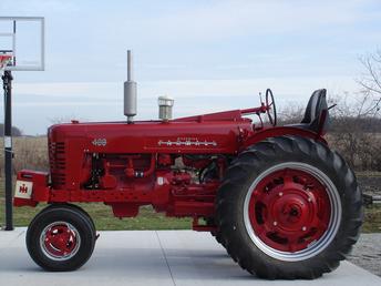

I procured an ancient tractor that ran fine for about ten minutes. Long story short, cleaned out fuel bowl , and had to remove brass filter at end of line going into carb because it was full of grit. Carb is updraft model, has two screws on side and one at bottom. Set side screws at 11/2 turns each. Loosed screw on bottom to see if fuel in carb, discovered it has a valve screwed all way in . Loosed it one turn and locked down with nut surronding it. Tractor cranks with a breath of ether, runs about ten minutes and quits. Throttle control has no control at all. Tractor has huge rear tires, two right together in front , power steering and a front end loader.(thats why I bought it). I need to get thing running as I don't need a pasture decoration ! As far as model, thats what seller told me. Neighbor said tractor was known as "widow maker" because it will rear up easily. Wifey says sell it as is. Probably at a big loss so I need to get it running. Don't recommend dealer as this area is now the suburbs and the dealers sell mainly lawn mowers. Any help is appreciated. thanks, James

I will post a pic of a Farmall 400, is this what you have ? If the tractor starts and runs 10 minutes Im willing to bet that your getting crud in your carb from the gas tank and this is stopping your fuel flow ! You need to look inside your tank to see how much rust and crud you have ! You may have to remove the tank and clean all of that out before proceeding ! I used an old paint mixer with a box of 1/4-20 locknuts to claen all the crud from mine ! It worked out great. Some people go the extra mile and coat the inside of their tank with a protective coating but mine got so clean that I didnt think it was necessary !

He PMed me and told me that the tractor pic I posted was what he had ! I believe he is still working on it Bob.

The tractor I have is exactly like the one pictured, color and everything, right down to the front end loader.(the reason I bought it in the first place) I've only found one fuel tank on this beast, it does have a new radiator , hoses and belts ! The carb looks like what was on pre 30's cars and was called an updraft type. Should work better as a downdraft but I don't feel like making a new manifold for it. Gas tank currently off, been cleaned, treated and a new epoxy liner has been applied. Waiting 24 hrs to dry. Let you know of progress after Memorial Day. I have a convention of Army Buddies to attend. Sadly, its getting smaller every year but that's life .
