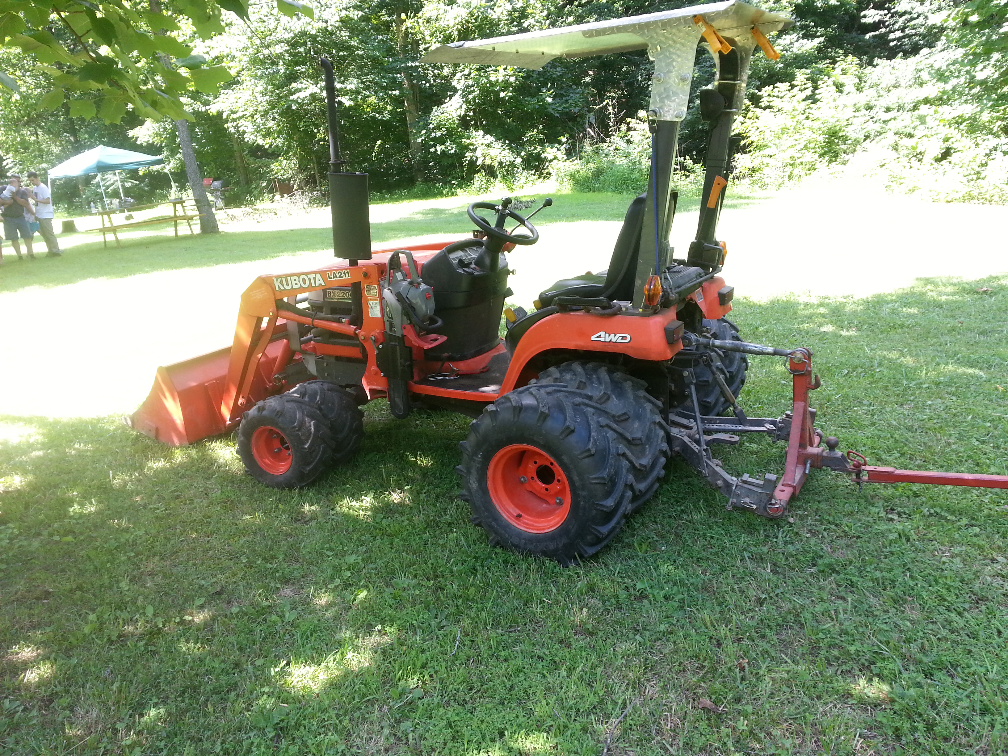

I put a muffler that fits 97 Honda Civic and it really quieted the vertical exhaust that I put on my BX. Not a problem and it's been on for at least 5yrs. I do have a support brace.
Edit: That was an '87 Civic
   / Car muffler #5
I put a muffler that fits 97 Honda Civic and it really quieted the vertical exhaust that I put on my BX. Not a problem and it's been on for at least 5yrs. I do have a support brace. <img src="http://www.tractorbynet.com/forums/attachment.php?attachmentid=523273"/>
Do you by chance remember the exhaust pipe size? Either the inside or outside diameter?
I'd love to replace the horizontal exhaust on my MF Utility, make it nice and quiet. That looks good!
