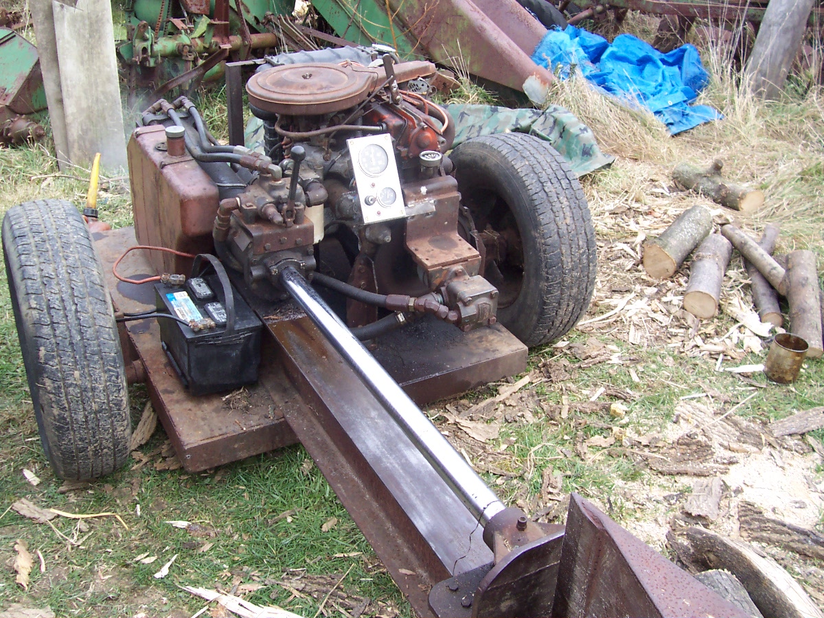

/ car engine driven log splitter #28
I built a log splitter over 20 years ago using a 4 cyl Chevette engine.
It is still in use it and it works very well.
The pump is a Vickers 210 pump --10 GPM's.
It is coupled to the crank shaft with a magnaloy coupling. the pump is mounted on the bell housing area where the transmission would be mounted
It has a 6" cylinder from a garbage truck ram, it has a stroke of 36"
the engine runs just above an idle, maybe 1200 rpm's and it has enough to power to split anything I put in it.
it uses little fuel.
I boxed the H beam to provide a reservoir for the hyd fluid,
the larger tank in the picture is for gas.

Your not the first person i've seen with this type of set-up. The one's i've seen work very well and are economical!
