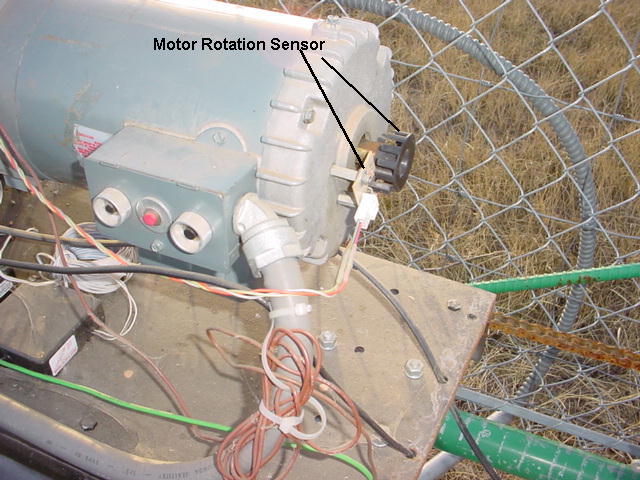

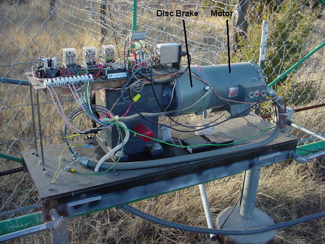

Just a quick note on reliailibilty - The gate has worked flawlessly for 7 years now. I grease the wheel bearings once a year. & the chain is oiled about every 4-6 months. The motor, Disk break & gear reducer are major heavyduty overkill they will last for many years to come.

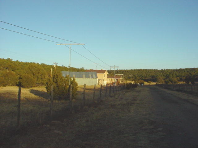

</font><font color="blue" class="small">( ...That is the most impressive 120V power feed I've ever seen. You may have addressed this but an overhead feed like this need lightning arrestors on each end. )</font>
One of my major concerns as well. I have had lightning strikes already that vaporized the fuses I placed at the gate end. But did not fry any circuit boards or relays (yet). This summer I am going to make the power go underground.

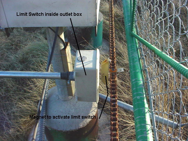

Chain Issues – Another good point and question, I have solved this with the unique attachment design. I have a spring attached to the chain on both ends of the gate that absorbs the start up & stopping forces on the chain, and turnbuckles to keep the chain properly tensioned. Also the limit switches work every time all the time – A major factor in keeping the chain from breaking.
Take a close look at picture # 10 for the chain attachment details.
