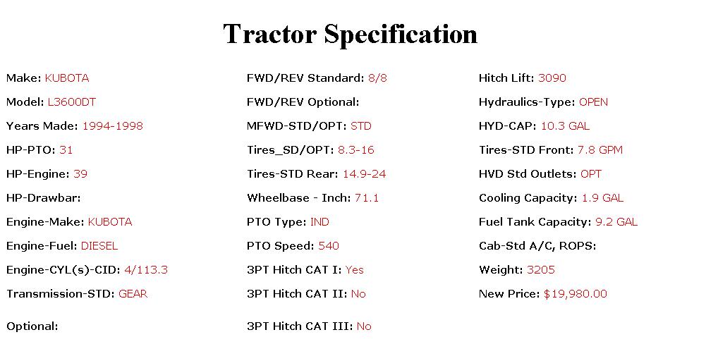

Tony, I think you meant to say that the L3600 had 28 PTO HP? The 3600 only had 33 engine HP.

Hmmm...turns out we're both off/w3tcompact/icons/smile.gif. The engine is 39 HP with 31 at the PTO. With the manual shift you don't lose as much HP as with HST. Attached are specs.
