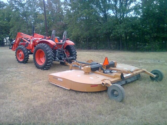

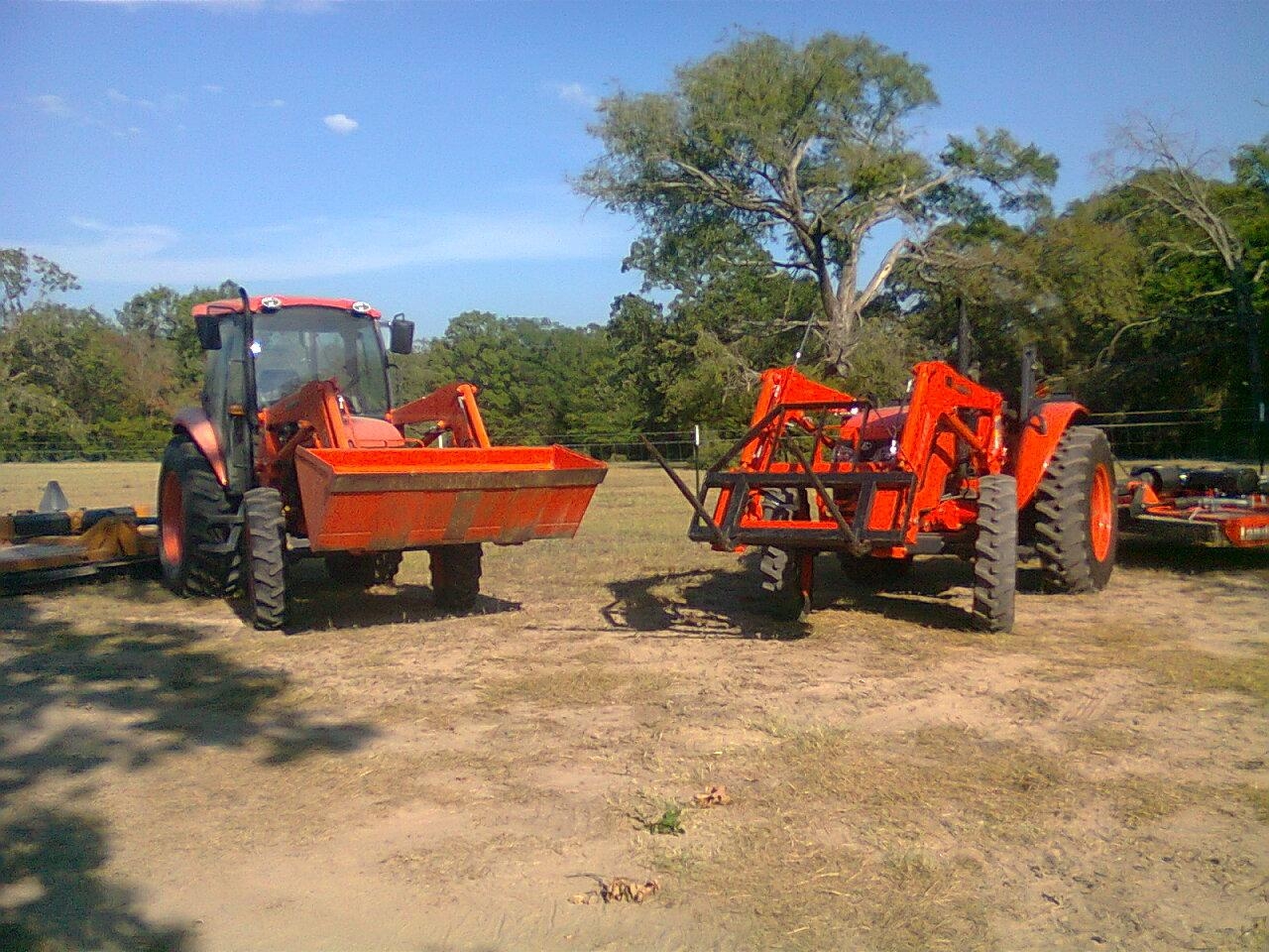

The M6040 is will pull a 7footer no problem,I pull an 8ft will my M5040 in stuff over the hood,I even hook up to a 15ft batwing and clean-up the lighter stuff. I mow my yard all the time with a 12footer 5040 and ds1440.JPG its just going to depend on soil type if it will hold it up without rutting. The 6040 is not going to be near limited as the mx5100 will be,you'll have the weight and loader capacity there. May I ask why you skipped over the 5140 should fall in between the prices mentioned? The 5140 has slightly smaller tires but same frame as 6040,7040. My 7040cab,5040 open-stationtractor2.JPG
