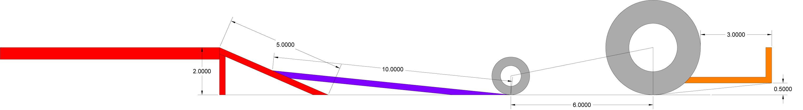

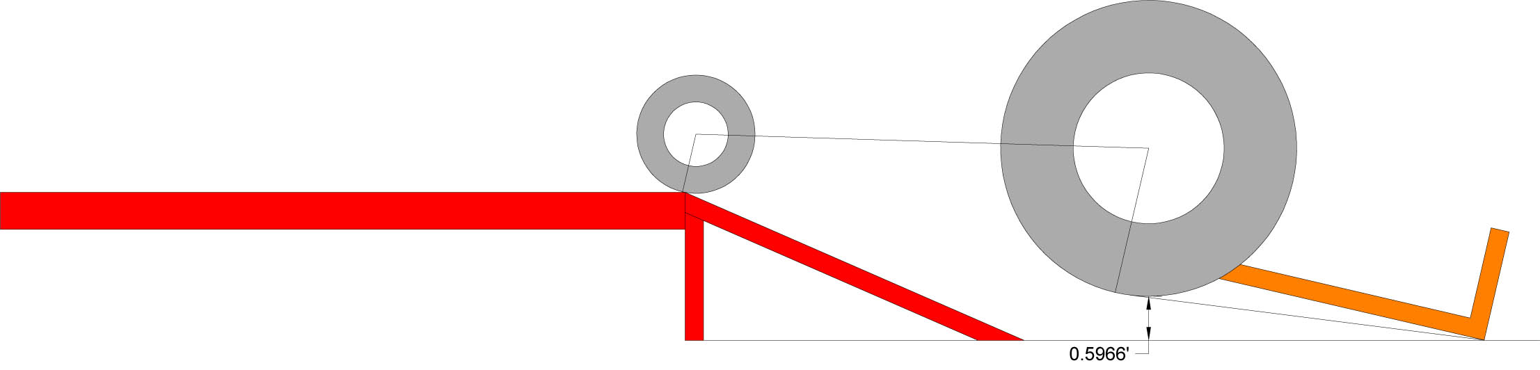

Sorry Chris - the part of the geometry you don't understand is the ratio of wheelbase to the portion of frame that is hanging off the back, which is roughly 2:1. I have about 6" of ground clearance, so as such, the front of the tractor can never rise more than a foot above the rear tires. With my 6' wheel base, and 2' trailer, the only way to solve the problem with a ramp extension is with a 12' ramp. Ding ding, indeed.

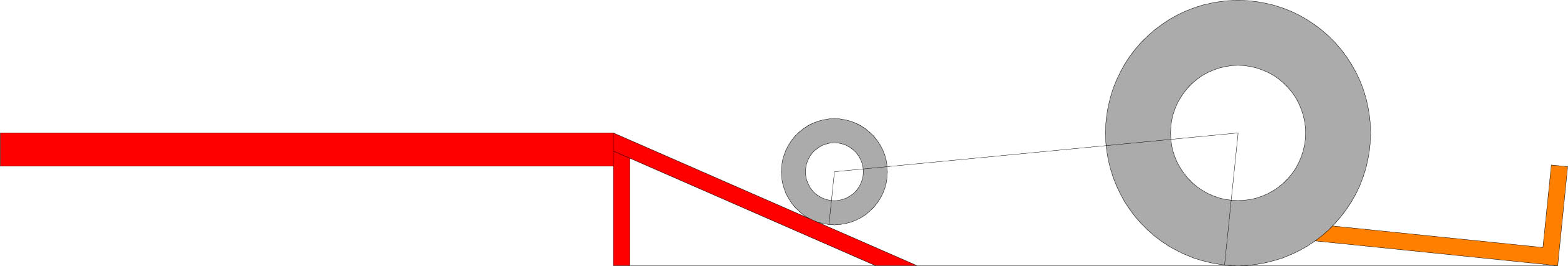

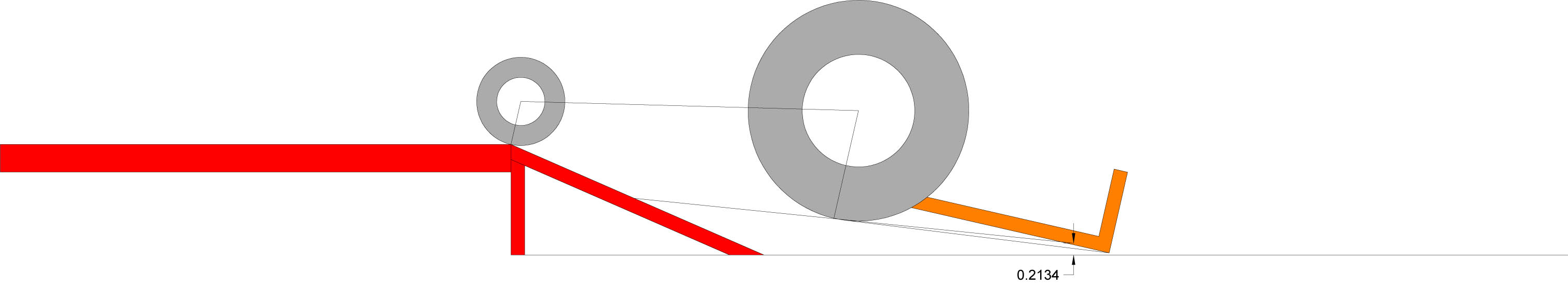

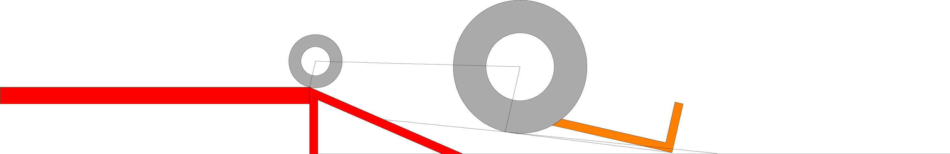

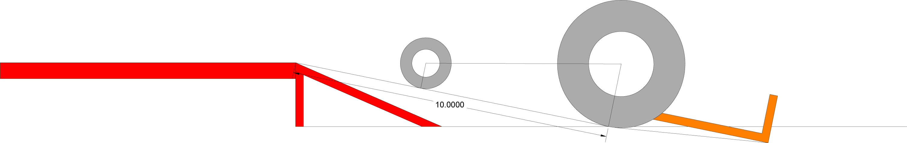

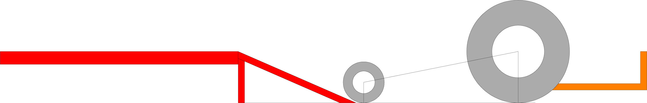

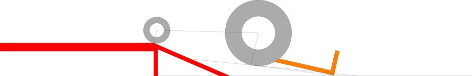

OK, guys. I said it once before...I'm not a fan of speculation.
So I built a simple replica of the situation in AutoCAD to demonstrate the problem and a couple different solutions.
I used fairly conservative parameters based on the OPs input and information available online. I put the deck 24" off the ground (Hudson says 23"). I assumed stock ramps are 5' long. The wheelbase of his tractor is 71", but I put in 72" (even 6 foot). I made the rear-most tip of his backhoe 3 feet behind the rear-most point of his rear tire and put that corner a mere 6" off the ground.
From my model, you can see that even if the stock ramps were extended to 10 feet long (which I wouldn't want to lift or have sticking up during transport), it wouldn't come close to working. I don't even think 12 foot long ramps would work IF they are hinged at the trailer deck.
He needs "sub-ramps".
By my calculation, sub-ramps that are 10' long (properly positioned) or 8' long with a "ledge" at the lower end at least 3 inches tall will allow the point of the backhoe to swing harmlessly in the air as the tractor is loaded.
As I stated before, I have the identical problem, albeit on a smaller scale with my little BX tractor/backhoe, and this is how I solved it. But my sub-ramps are only 8 feet long and could be a little shorter.
I hope everyone finds this information helpful to the discussion.
Even more, I hope the OP tries it with a few 2 x 12s and tells us that it works!!!
I think if you raise the front of the trailer about 14"-16" by driving up on a set of ramps with the rear tires of the truck, the rear of the trailer will drop 7 or 8 inches. That along with a slightly extended ramp or a little cribbing to drive up on (sub-ramp) might just do the trick.
If you take you example that is third fron the left in the top row and draw a line from the contact point on the ground to the top of the end of the trailer, that will give you the length of ramp that will work. If you then drop that top point 8 inches and draw a line parallel to the first one that will give the length of ramp that you need with the tuck up on ramps. It may be close to what the standard ramps are.
