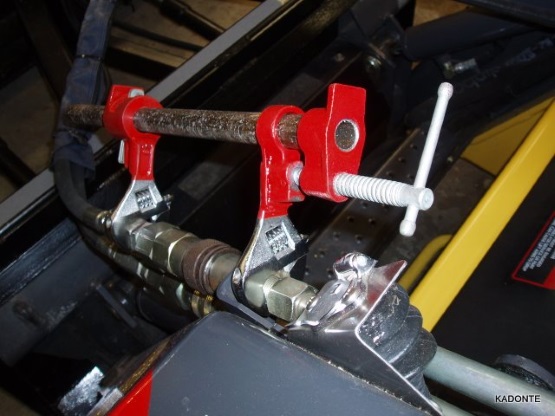

Here are a couple ideas from my projects file and this old thread: http://www.tractorbynet.com/forums/hydraulics/131755-help-my-stucchi-disconnect.html

Nice ideas Dennis!!!! Thanks for posting them!!!! :)
