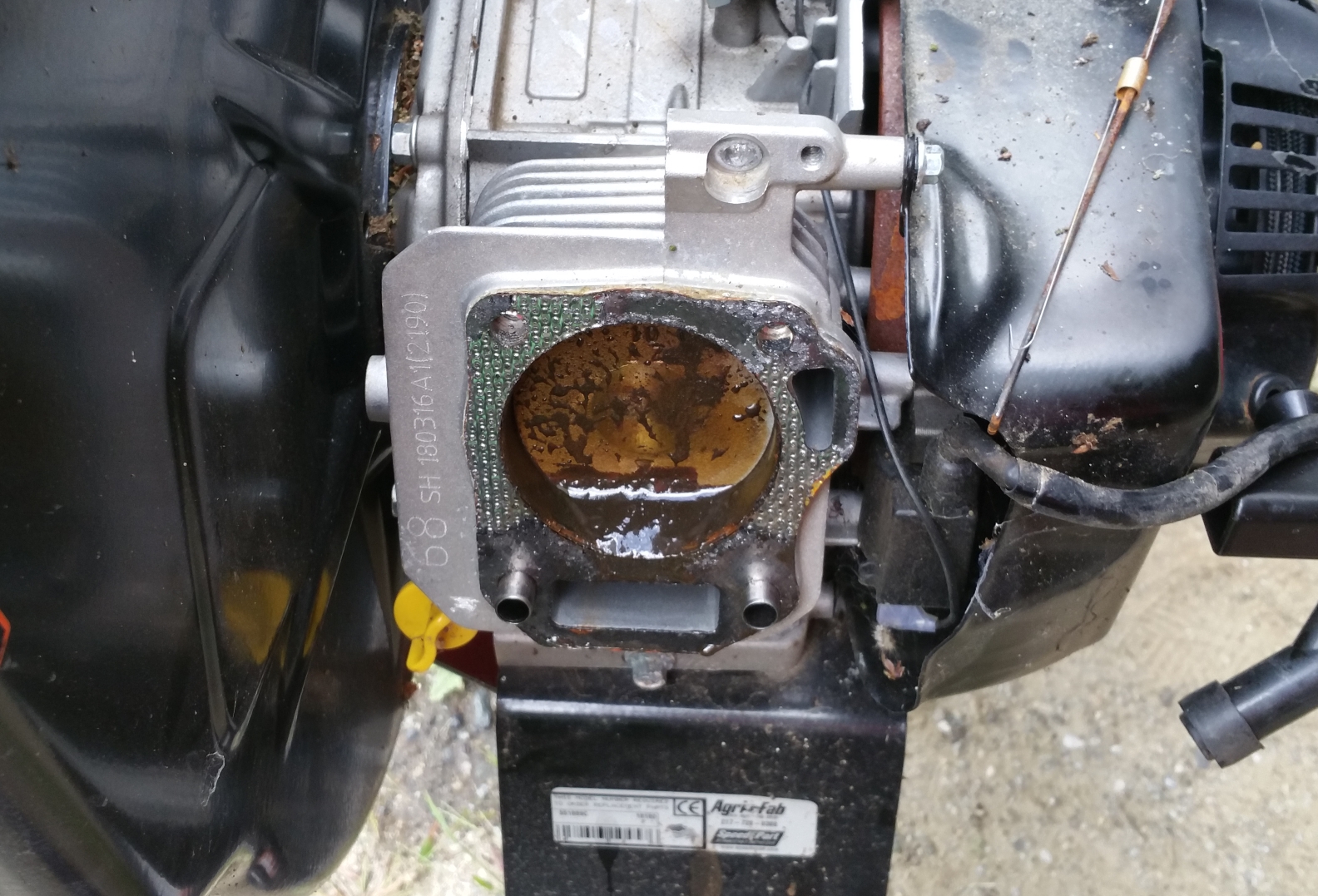

I have POS Briggs engine on a leaf vacuum that got water in the cylinder so I had to pull the head off. It's a small CR750 horizontal engine (looks like a Honda clone). I've looked every place Briggs says it should be but can't find it. There's a sticker with the S/N on it that Briggs says should also have the model number but it's not there. Briggs says it could be on the valve cover yet it's not. Tomorrow I'll pull the pull starter and see if it's on the cover in a place that can't be seen.
I don't know if the company will survive but I can say I will NEVER buy anything with a B&S on it again. This is the second engine (both less than 5 years old) that has had this happen. The first I assumed it was left outside under an eve and somehow water ran off the roof and on to it. But this engine has spent almost all of it's short life inside a garage. It has less than 2 hours on it and while it's running again I had to use high temp RTV on the head gasket. But without a model number trying to order the correct head gasket is almost impossible. What happened to them? When I was a kid their engines were everywhere. Unless you ran them without oil they ran forever. I even had one that smoked like crazy so I put 85 weight gear oil in it and it ran for years like that until the lawn mower rusted out.
In the lower left is what the head gasket should look like. I found this on ebay but there's no part numbers.

Here's what the sludge inside the engine looked like.

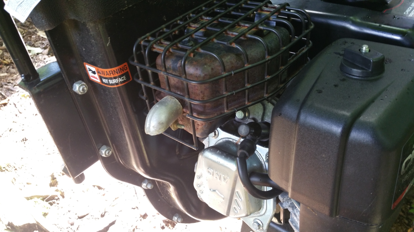

And ten to one the water is getting in the engine from the muffler. Setting outside and the rain is running in the exhaust hole and down past the valve into the cylinder.

I agree that the water got in through the muffler but Agri-Fab put a muffler extension down spout on it so it shouldn't be possible for water to just run into the muffler. What I really believe is that Briggs has a decompression device that opens the exhaust valve when the engine RPM gets below idle to help starting it. But Briggs should have thought about water. Every other brand did. I could see if it was on a trailer being towed in a rainstorm and water getting in. But even then what business would want an engine that they have to worry about bring it to a jobsite if there's a possibility of rain.

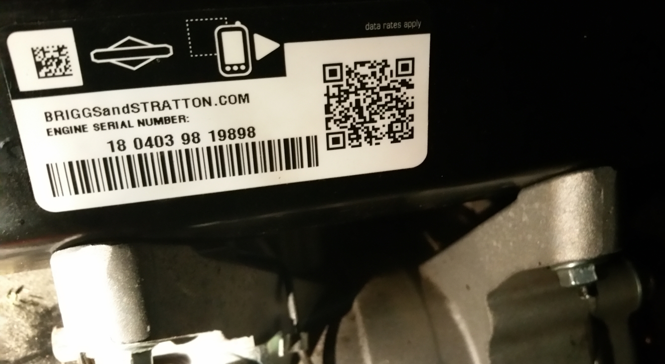

Post the serial number and I can get all the engine information on most of the newer engines.

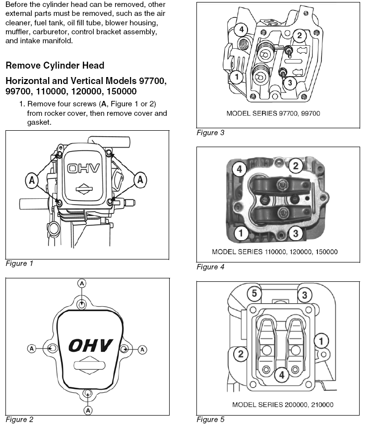

I've got a folder with every B&S manual I could find, does it look like one of these?

Here's the serial number.
Here's the muffler extension.
Dan, none of those are right. If you look at the picture of the gaskets the valve cover gasket is the one that's on the lower right and the head gasket is lower left.

My guess is the water is getting in through the bolts on top of the muffler......

Try model number 10R232-0007-F1 Gasket set 594951 contains all the gasket that you need. Gaskets are not available separately for that engine. Looks like if any major component goes south on that engine the parts are not available. Head and push rods for just a couple things that don't have available replacement parts.

I'm betting it's an engine made in the same factory as the ones Harbor Freight sells. While pulling the pull starter cover off one of the screws ended up behind the flywheel. While removing the loose screw I found that the flywheel will move in and out by about a 1/16" of an inch. It seams like Briggs is just riding it's name now. To be honest I set a limit of $15 for the gasket and shipping. Since it'll most likely happen again and the cylinder wall is damaged from the rust I don't have great expectancy for the longevity of the engine.
Randy, that looks like it. The number is laser etched, not stamped next to the oil drain plug. It too hard to read correctly so I was searching for the wrong number. What's funny (and sad) is that the gasket set you listed above also allies to the CR950 engine. It comes with two head gaskets. The head gasket for the slightly larger CR950 can be bought separately. I did find an aftermarket gasket set on ebay matching the Briggs part number but only has one head gasket in it. All of the gaskets (other than the head gasket) that are identical between the two engines can be bought separately as long as you know to search under CR950 (130G32-0022-F1).

I am going to throw another weird thing into the mix. If I input the serial number as 18 0403 98 19898 I get the CR950 engine and if I input it as 1804039819898 I get the CR750 engine.
