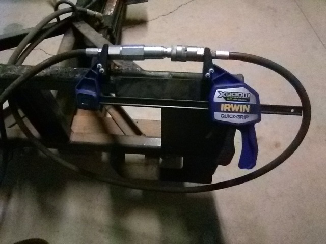

I thought about ordering a set of jaws ( XBoom Skid Steer Loader Adapter Coupler System) ) and putting them on a store bought Irwin clamp so I could leave one in each machine.

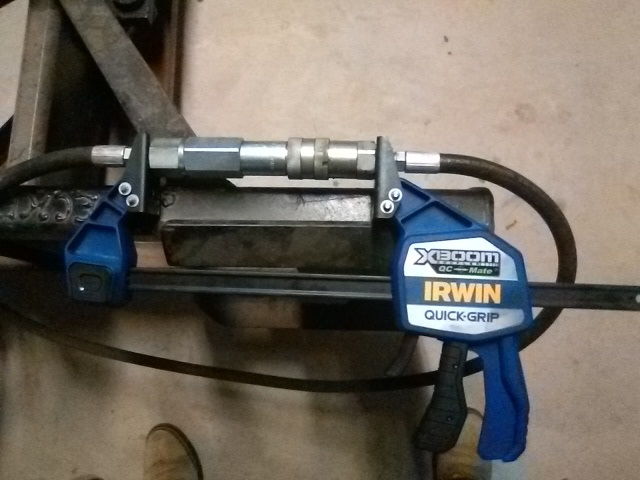

There are also some tools out there which allow the couplers to either be relieved of the pressure that keeps the plunger closed or overcomes the pressure by leverage to close the couplers.
I bought the XBoom tool: XBoom Excavator Coupler System (Excavator Skid Steer Loader Adapter Coupler System) Pretty expensive for what it is, but it works if you have access to the back of each coupler. I like this one because it does not bleed the oil off which means there is no mess or loss of (expensive) hydraulic fluid. It is also fast.
Prior to the purchase of the tool I would relieve the pressure by pushing the pin in the female coupler in with a hammer strike on a 5/8" drift. The oil came out in a hurry and no matter how careful I was to wrap the coupling in a rag some always managed to land on my clothing or some other place I didn't want it to.
